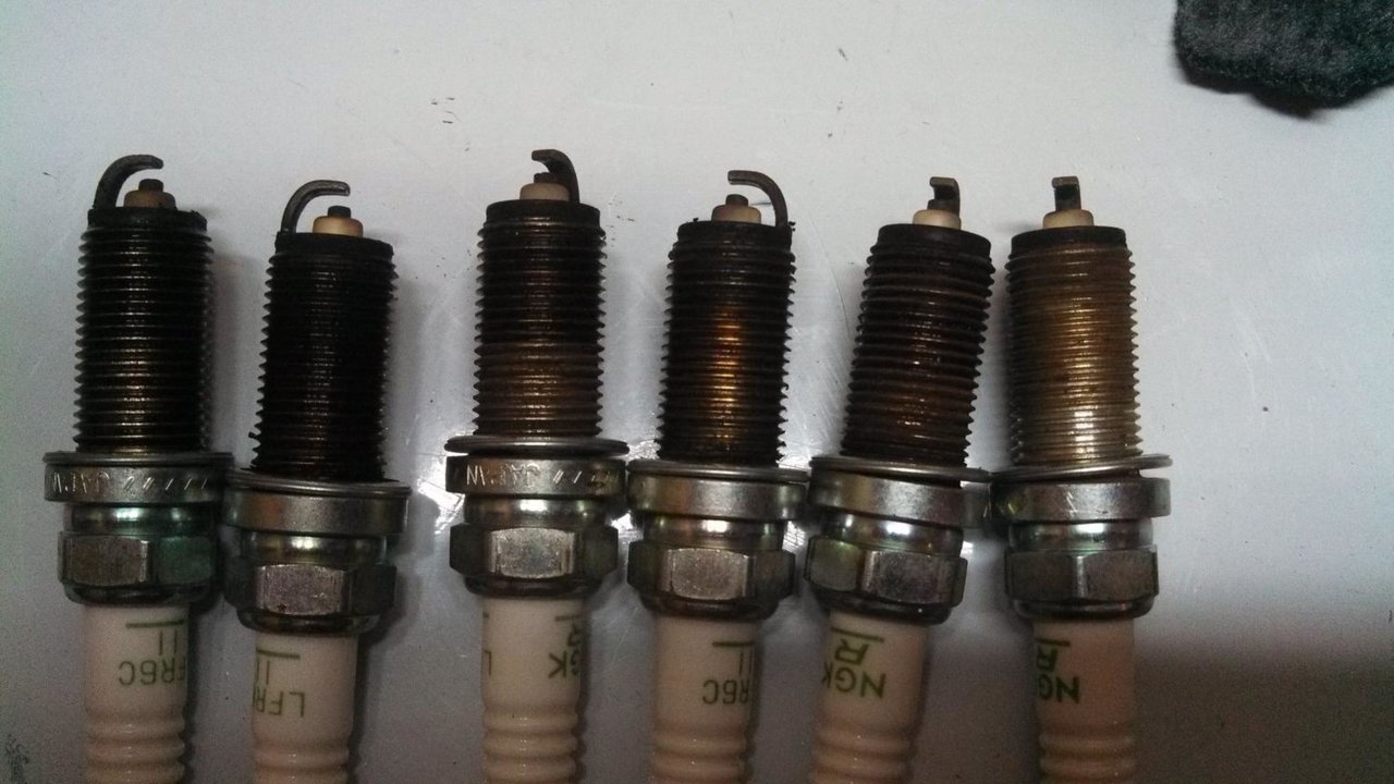

    Alright guys, first thread for me so be gentle. I searched Google and the forums for 3rds gens that have this issue (or non issue, idk) and didnt find anything. I just replaced my spark plugs at 59,364 miles, and I noticed what looks like oil on the threads of all the plugs. The the outside plugs had a more on them then the two "middle" plugs did. I'm not extremely mechanical, but I can fumble my way through regular maintenance with the help of service manuals/internet/friends. So is this something I should be concerned about? My 2016 TRD sport was bought used and is toyota certified, so I have 100k warranty, I'm just wondering if I need to bring this to the dealers attention or not.

    I assume this is the V6? I would guess that your valve cover seal(s) are leaking.

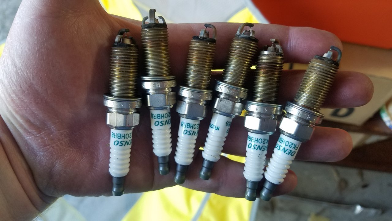

    That is not something to be concerned with. It is the metal changing color due to heat. The gas burning causes that typically. To check if you are losing oil, have you been adding any? Here's a pic of sparks from my T4R.

    It has not been loosing any oil. I check probably every 2 weeks or so. I see what you're talking about with the discoloration, but your picture the threads appear dry, and my plug threads looked wet. Not sopping or anything, just like a thin coat of oil on them

    I haven't touched my sparkplugs, but on other vehicles, they come out looking like that if you use antiseize when installing them.

    Notice the little metal ring on the plug between the hex bolt pattern and the threads? That's the gasket. If oil was leaking through the valve covers, you'd have oil past the gasket. You don't. The threaded area is actually threaded into the combustion chamber putting that spark as close to the center of the combustion chamber as possible. The residue you are seeing is likely a combination of gas (from the injectors) and oil (from some blowby and the PCV system). It's pretty normal.

    Really. Catch can is going to catch heat discolorization lol. That's what pretty much any spark plug is going to look like after some miles.
    OP, should be easy to check, just wipe plug with tissue paper. Is it wet?

    It also might actually be the anti-seize on the plug liquefying from the extreme heat. The post and ground don't look fouled at all so I wouldn't worry one bit about it.

    Thanks for the replies. Like I stated earlier, they are not dry, it's not saturated, but a thin layer of oil on the threads.
    I guess I wont worry about it and just check them in 10k and see if there is any change.

    Your plug color is normal. Nothing to worry about. You'll see it again the next time you pull them.
