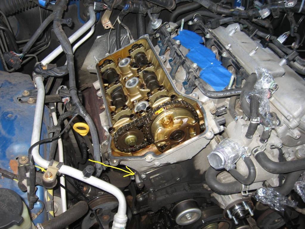

    The 1GR-FE doesn't have "spark plug tubes". Just a gasket/seal between the head and valve cover.
    Disregard the arrows as the images were from something else.
    See no spark plug tube. All cast seal areas.
