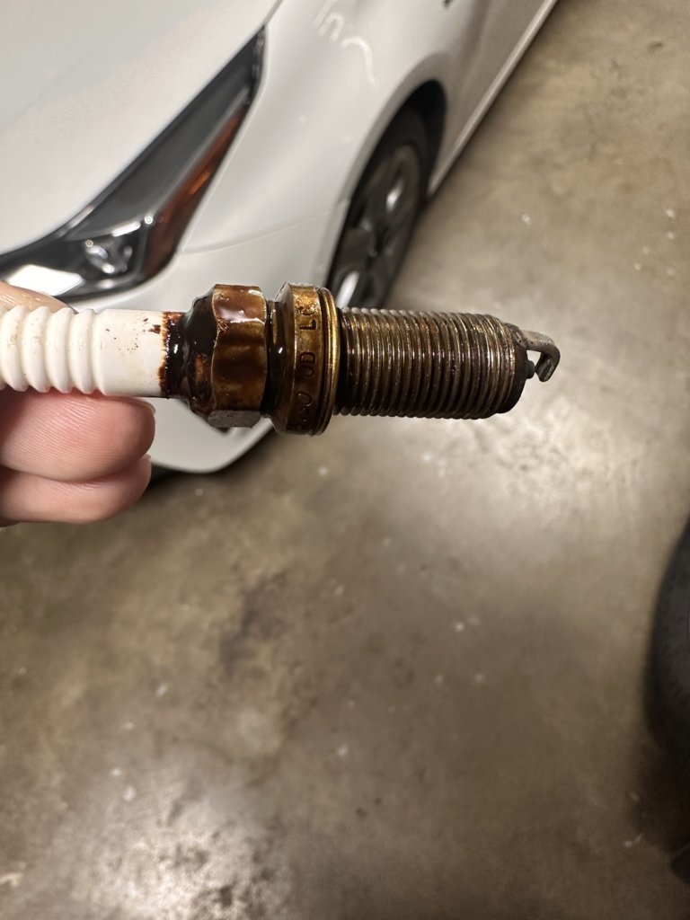

    Hey everyone,
    I just changed out the spark plugs on my 2012 Tacoma, thanks to this forum. I pulled one plug (driver's side) that had a bit of oil on it. From what I understand, this is either a plug seal or valve cover gasket issue, but I can't find enough info about fooling around with those parts so that I'm comfortable enough trying to diy.
    Anyway, I guess my main question is, is this an urgent fix, or can I put it off for a month or two? Mainly for budget reasons. I'm guessing it won't be cheap to take it to a shop.
    Thanks everyone

    Your valve cover gasket is leaking around the spark plug holes. You can put it off for a bit is needed. It shouldn't cause any major issue.

    Was this only on one spark plug? I changed mine recently and one of them, the driver's side rearmost one, had oil on the threads. Not as bad as yours though.

    Yeah, it was only on one, so I'm glad it's not more extensive

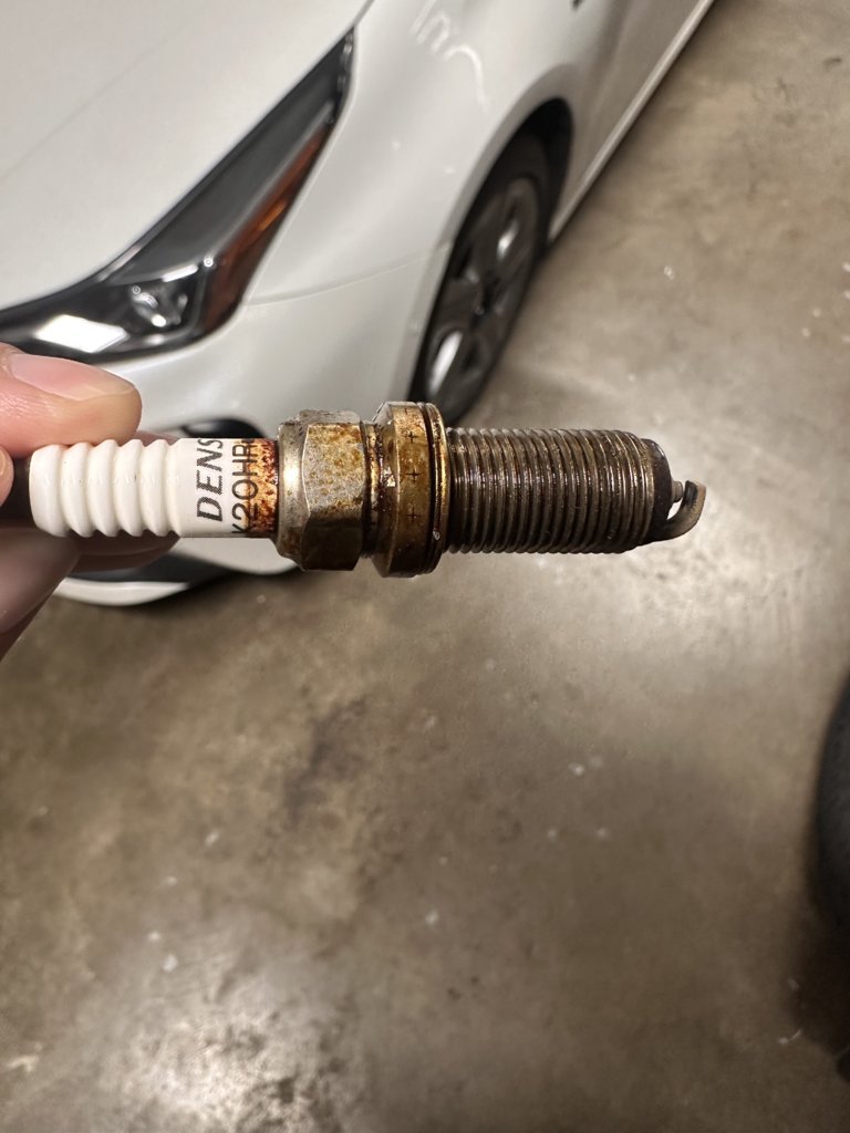

    6112/5160 Deaver stage 1 Are topper Steelies,255/80/17
    Looks like mine is the passenger front.
    All others looked great.
    Would you do just the passenger side?

    No, I did both - they're the same part, the same age, and the same condition, and in a motor known for these leaks being inevitable with time. The passenger is easier, and doesn't need the intake manifold off, but it's not THAT much additional labor and cost to do the driver at the same time if you're already ordering parts and taking the truck offline for maintenance.

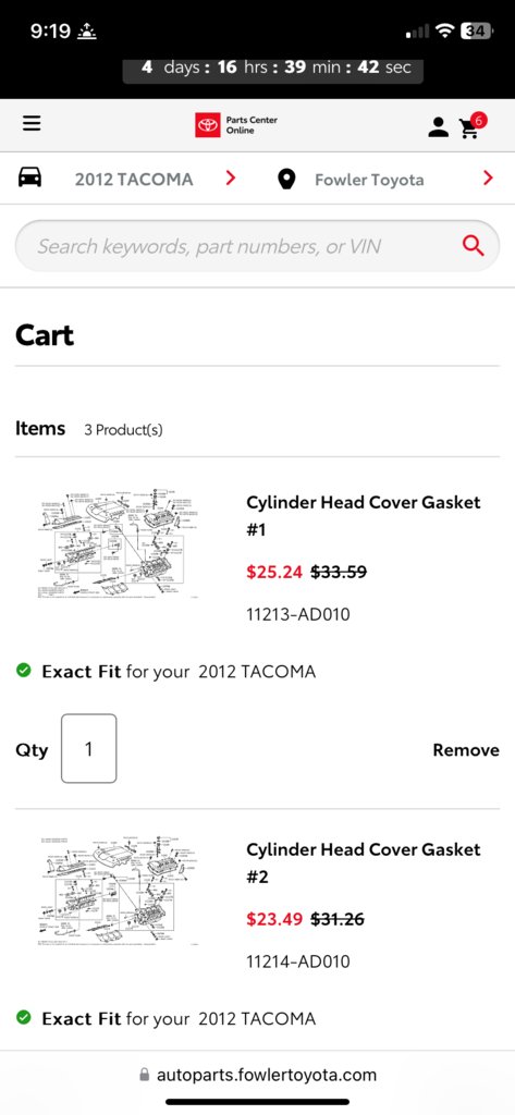

    Here is what I’m ordering,anything else except some black silicone.The covers come with little seals for the top of valve cover?
    Quinton
