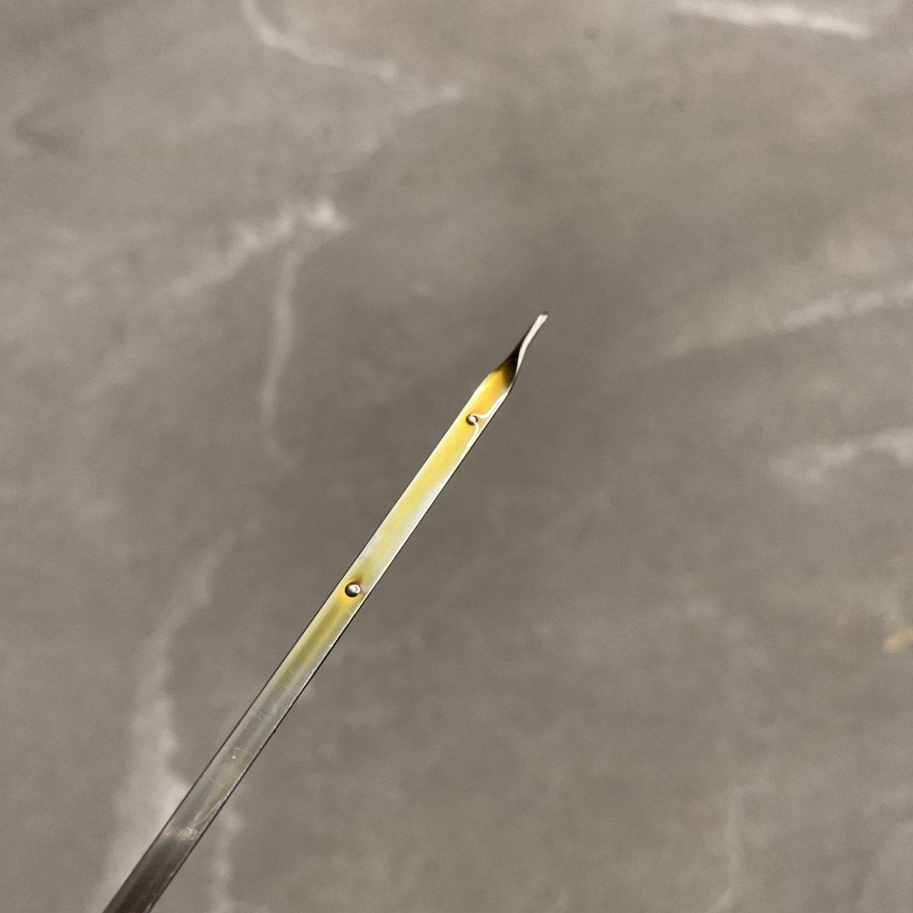

    Hi all,
    I had my truck (2015 Tacoma trd sport) in at Toyota for service including an oil change. I’ve driven about 500 km and I checked my oil as I typically would when I fill up my truck (Hot engine, after sitting for five minutes). It seems they overfilled my oil (pic attached). Based on the photo, am I safe to drive this way, can any damage occur or should I take it back to have them remove some oil.
    thanks in advance for any help or replies.

    If it worries you drain off 1/2 qt. Simple enough to do. The truck was leveled when you pulled the dip stick?

    hey thanks for reply. Yes - level at the gas station. It’s snowy and tough for me to drain the oil in this weather on my driveway...

    The only way to get a good reading on these trucks is to do it first thing in the morning before you start the truck. Make sure you park on a flat surface. Pull it, read it, and done. A little over the mark is no big deal, but I'm guessing it is not overfilled.

    More than likely, when you extracted your dipstick, it pulled some oil from the tube sidewall. Those dipstick styles can be a pain to read. I usually will check after about 10 to 15 min after I shut it off to get a more accurate reading but even then, one side of the stick will have way more oil than the other, I always use the side of the stick with less oil after it's been sitting. I'm 99% sure you're fine @norcojumper

    The way I check mine is when it is cold. Pull the stick out and wipe it. Leave it out for a few minutes to let any residual oil drain back down the tube. Then put the stick back in/out to get a more accurate reading.

    This. I have seen dip sticks like yours end up being a perfect fill. there is no discernible line to go by, and therefor wouldn't touch a thing until you do. New oil, especially warm, is very hard to read, it seems to need a few miles before it sticks correctly.

    Looks normal. Likely got smeared pulling the dipstick out to make it look overfilled.

    The dipstick sucks. If I put the specified amt of oil in after a change, it's always above the top dot. I have carefully monitored the level when refilling, and if I stop before the top dot, I'm 0.5 to 0.75 qts below what they say to put in......
    Which way is correct? Dunno.

    I had trouble reading this dipstick too. The trick is this, leave truck on level surface and remove the dipstick for 5 min. After 5 min, insert the stick and check the side that is lowest, the other side is usually messy and smeared, the cleaner and lower side is the correct side to read. Usually the side facing you when you pull the stick straight up is the one to check.

    Oil level is safe anywhere between the dots. You don't necessarily have to fill it to the top.
    You also have to consider gravity. The way you're holding the dipstick in the photo is allowing oil to run up the dipstick making it appear there is more oil in there than there is.
    Make sure the truck is on level ground and the engine hasn't been running for 5-10 minutes for an accurate reading. Clean the dipstick and insert, wait 5 seconds and pull it out. Make sure you hold it in a vertical position so no oil can run up the stick when you check it. Between the dots is fine. If slightly above the top dot I wouldn't worry about it, 1/2" or more and I might drain some out. When the oil level is on, or below the lower dot you add 1 full quart. No reason to add partial quarts when the oil level is anywhere between the 2 dots.
