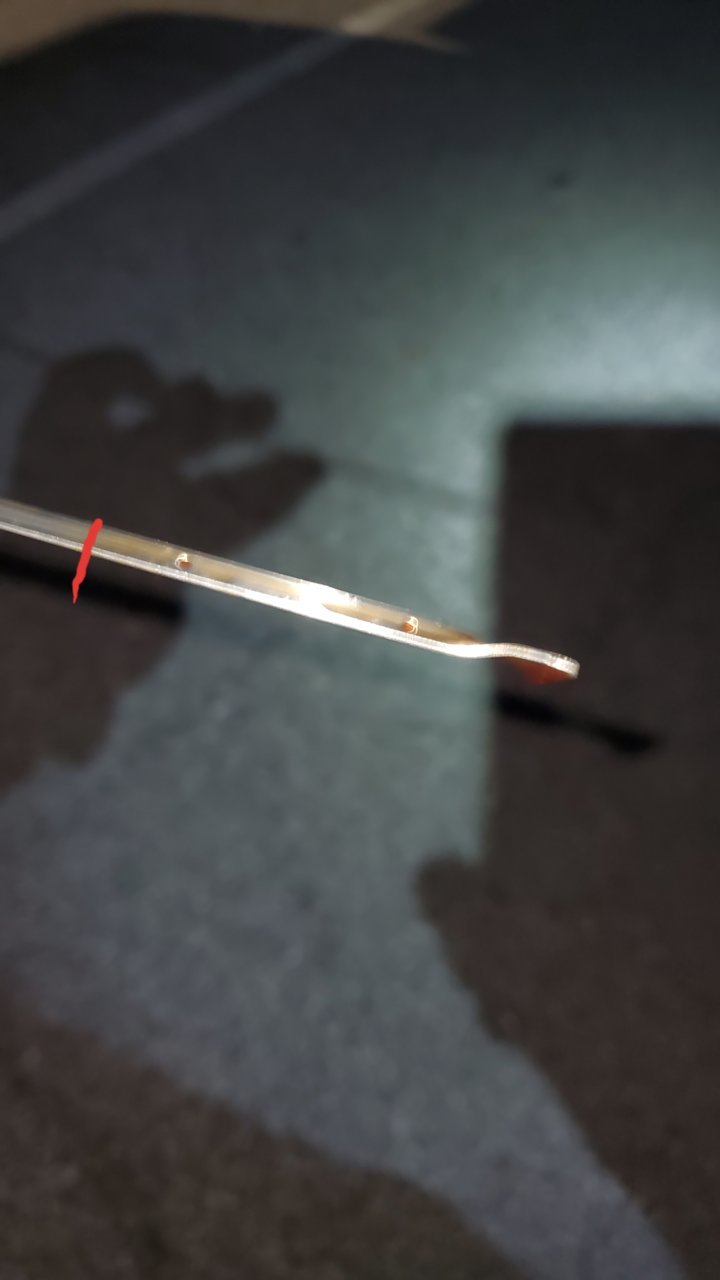

    Hi, everyone. I hope this finds you all well!
    So.. attached is a photo showing the oil level when checking it before leaving work. I hate to beat a dead horse but much like everyone else on here who has experienced a slightly overfilled sump it's been driving me up a wall. Picture quality is surely not the best so I've drawn a line to indicate the level. I've been driving it for bit but cant shake the overfill anxiety shenanigans. What do you guys think? (...new owner).

    Drain half a quart and see where that puts you on the stick. Then add if necessary. Definitely not worth stressing about!

    In your case I’d check the oil reading first thing in the morning when your engine is cold.
    If it’s still REALLY bothering you... change the oil yourself. then you know for sure.

    Always check it when cold and level. Allows any oil in the oil dipstick tube to drain into the pan and not mess up your readings.
    If it's still a bit high and it worries you. Drain a bit from the filter. Just remember to remove the cap underneath (if you still have one) and have something underneath the catch the oil.
