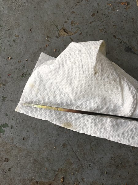

    So I took a little over a half out, and it looks like there's a line on the dip stick maybe quarter inch above the low line... and a blob about half inch above the full line... ??? I have no idea.. it's just so hard to read the dipstick.. guess the sheer math of how much is in there means it's ok..
    I drove it around the block and let it get up to temp after I took the oil out.

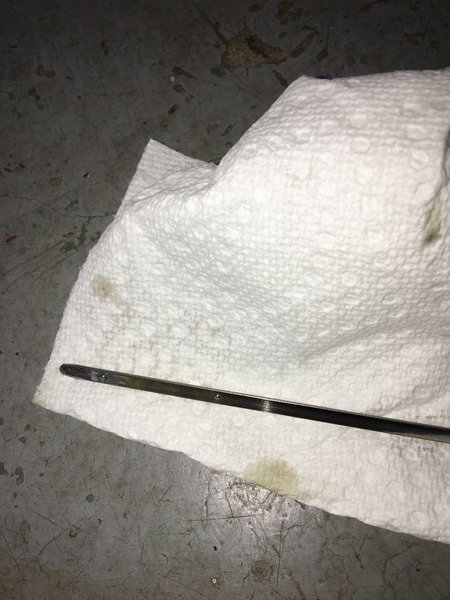

    2nd pic is horrible. Cant see anything.

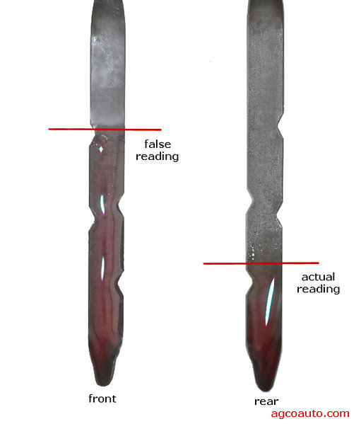

    This pic is from transmission fluid but still applies to engine oil.

    The issue is the dipstick....It will NOT read correctly unless you do this.....
    Pull the D/P and wipe clean.....set it aside....have a beer.....then (if you are on a level surface), install the stick and pull it once... it WILL read correctly.
    The issue is oil working itself UP the tube and messing up the stick reading. Try this OP, and then add the oil you are missing.!! :thumbsup:
