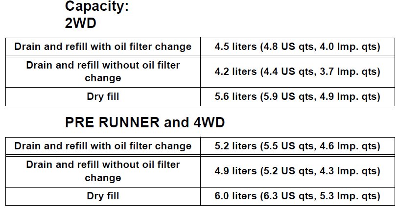

    Not true. The owner's manual only specifies capacities for w/filter and w/o filter. Factory service manuals specify those plus dry fill capacities.
    For 1GR-FE (4.0 V6):
