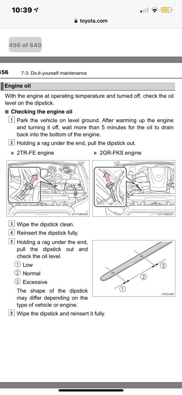

    Not sure why everyone is saying it’s fine, the owners manual is pretty clear on that.

    Because the dipstick in my truck is not accurate. The manual also says 6.2 quarts.

    Everyone is saying it because it is fine. It's true that greatly over filling the crankcase can do serious harm but a few ounces will do no damage whatsoever.

    looks like classic case of forgot to change the oil filter then added 6 quarts? just a thought.
    i change my own oil and filter, never had that happen. 6 quarts, just a little below max line when i do it.

    Judging by how much drains out of the filter housing and how much it's over on the dipstick, I'd say you're on to something.

    Mine used to do this too. I cut my dipstick down and haven't had any issue since! :thumbsup:
    Realistically, they probably just didn't change the oil filter.

    I found the best way to check the dip stick is in the AM before starting it, oil shows up best on the dip stick. IMO

    Moral of the story is he'll be fine with the oil at that level.
    If it's worrying then drain some out or take it back.
    The filter, if not changed, will(should) last until next oil change. Worse case scenario you blow the filter gasket and are left with a puddle of liquid gold under your truck.
