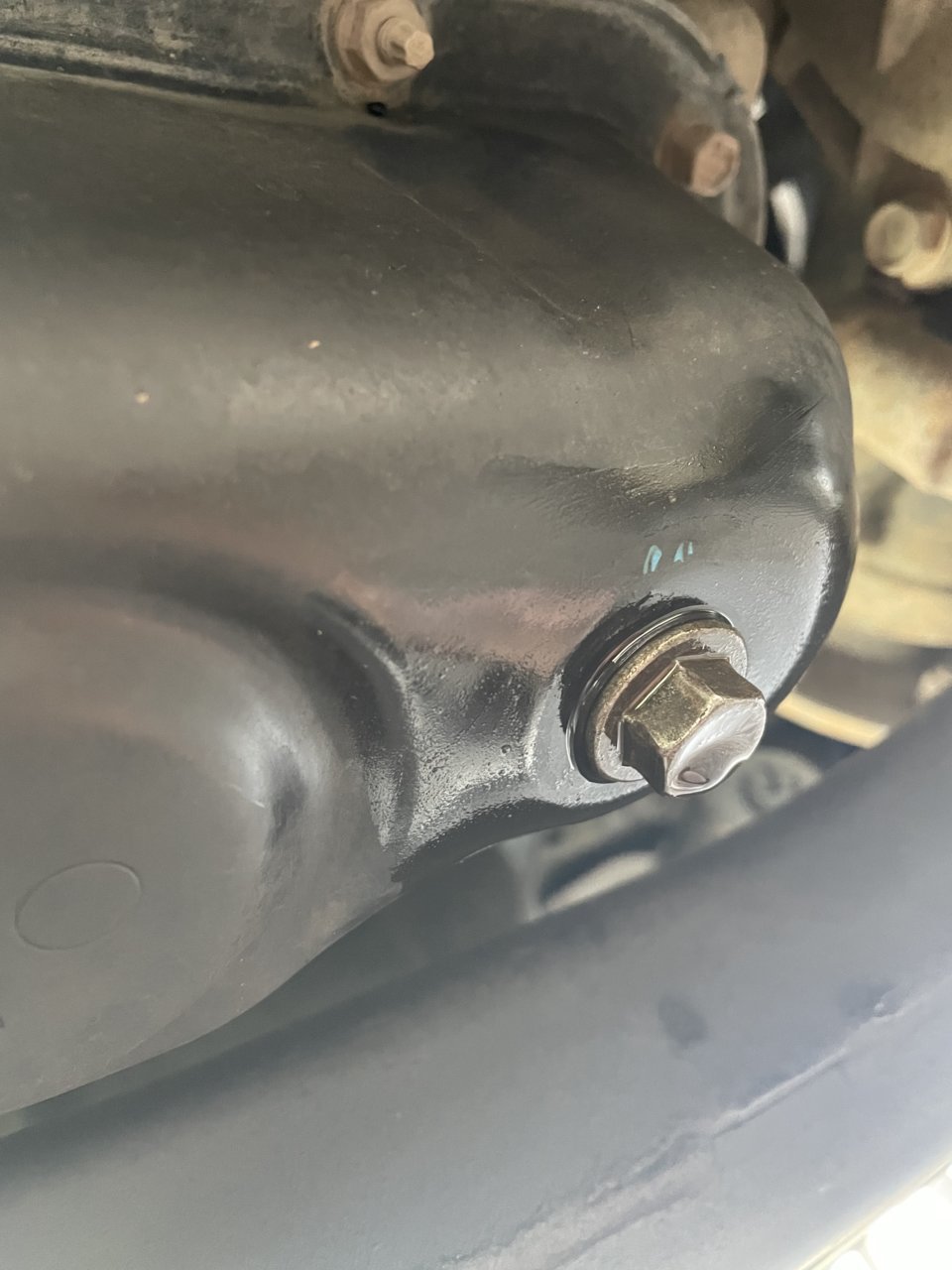

  17. Apr 26, 2022 at 5:10 PM
    #17
    Steelhead Bum
    Steelhead Bum Well-Known Member
    Aug 11, 2021
    #373986
    1,097
    Mitchell
    Eastern WA
    13 DCLB Sport 4x4, 92 AC MT 4x4
    Looking for advice/opinions.
    I’ve always done all of my service myself for as long as I’ve owned the truck which has been approximately 60k miles and have never had this issue. I switched over to the oem filters from Napa gold two changes ago after much reading on this forum. This is the first time I’ve used an oem gasket however. After using my last Napa gasket “soft clear plastic” on my last change I decided to head to the dealer and pick up some oem gaskets and another box of filters.
    So just like any other time after preforming the change I start it up and let it run for a couple minutes. Come back 10/15 minutes later and confirm the oil level and check for leaks. All good. Out of habit I always check the following day or two after changing any fluids to confirm nothing is leaking after normal use. Well the plug is leaking. I thought WTH did the plug come loose? Nope still snug. Leaking from above? Nope throughly spent a good 30 minutes inspecting everything. It’s definitely the plug.
    The mating surface of the pan is in perfect condition. The plug itself is in perfect condition. Threads are sound. Only thing that is different is the gasket. The gaskets I got from the dealer look nothing like the gaskets pictured on the top of this thread. The ones I received were rock hard and solid black not multicolored/layered. They look like they are made from paper/cardboard but are brittle as hell. Are the oem gaskets supposed to be like this?
    Im starting to think the new gaskets are the culprit? What do you guys think? Never had this happen in the 12 changes using a aftermarket gasket. Switch to “oem” and it leaks right off the bat.

    I think they gave you a fiber gasket. Had the same issue with my nieces Honda element where after changing the oil and using those types of gasket it will leak after wards. I just use aluminum crush washers that you can get from Amazon and never had a problem afterwards.
