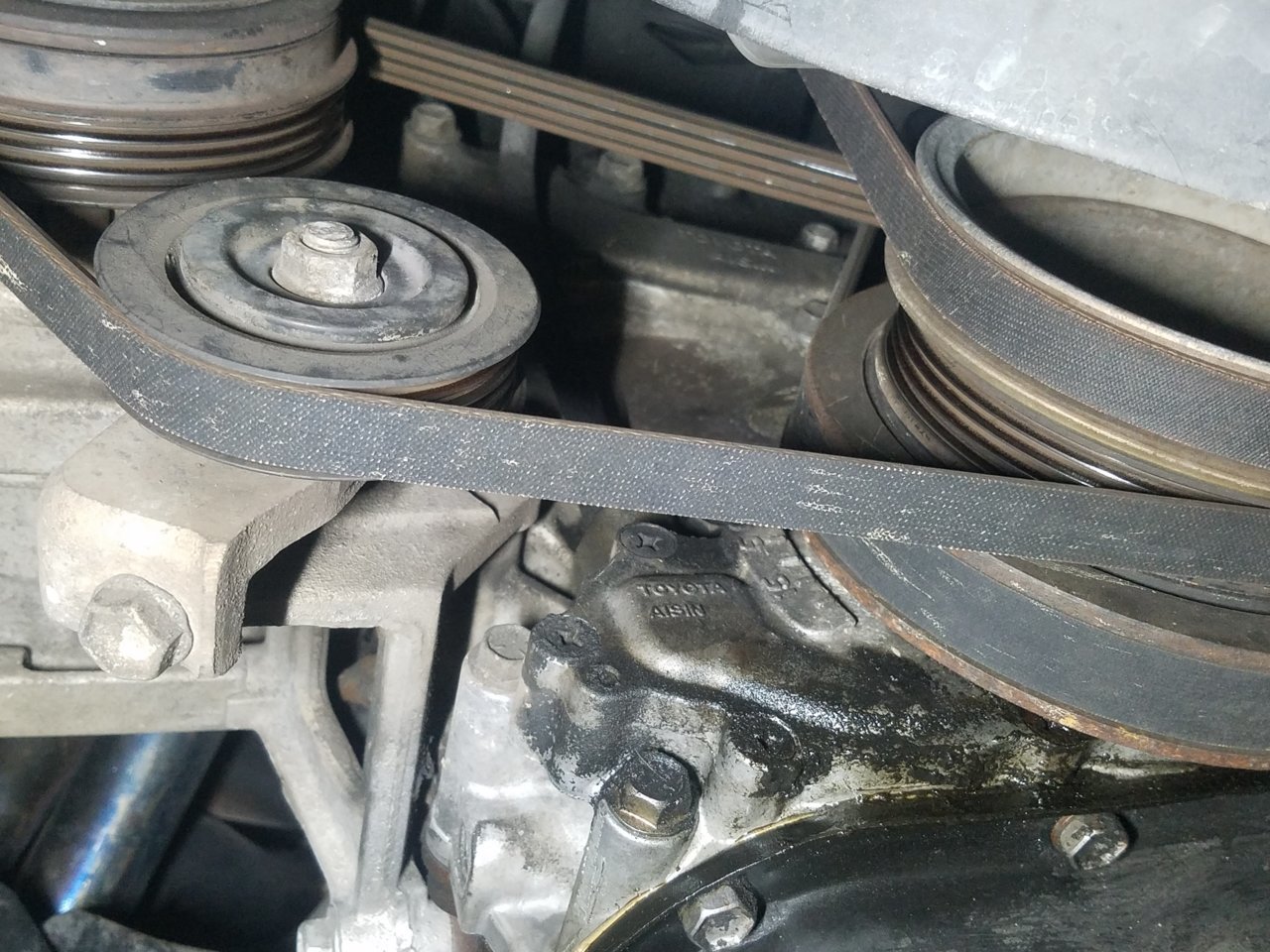

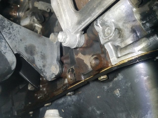

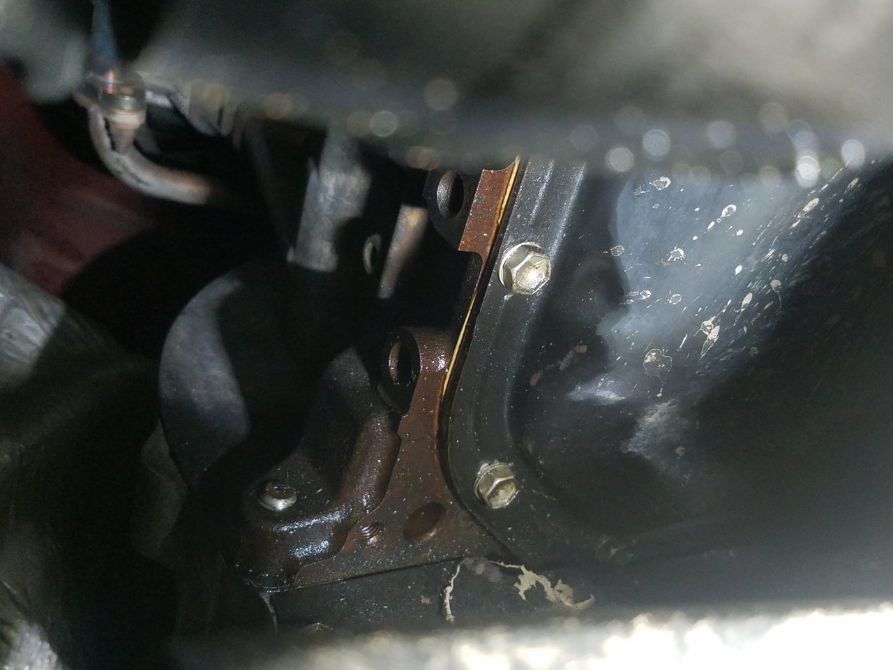

    I have 328K on my truck and have an oil leak that I'd like to fix. I'm pretty sure it's coming from the passenger side oil pan. Being a 4wd, it doesn't sound like a simple job. I'm not excited about dropping the diff and am leaning toward pulling the motor mount bolts and hopefully tipping the engine/trans enough to get it done. I have the NWOR header installed. Any advise is welcome.

    Leak looks like it's coming from above like valve cover gasket at left rear. 20200309_193649.jpg

    Thanks for advice and info. I just checked the oil pan bolts and was able to tighten them some; I suspect this will help. Truck has never leaked onto the driveway until the last 6 months or so. There has been oil in the skid plates but it never leaked on the driveway. Now there is a small drip where I park. I don't mind it leaking as long as it doesn't drip where I park. ;)
    The valve cover gasket is bone dry. I replaced it when I checked valve lash a few years ago. I believe the leak appears to be above the pan edge because wind from driving blows it upward.

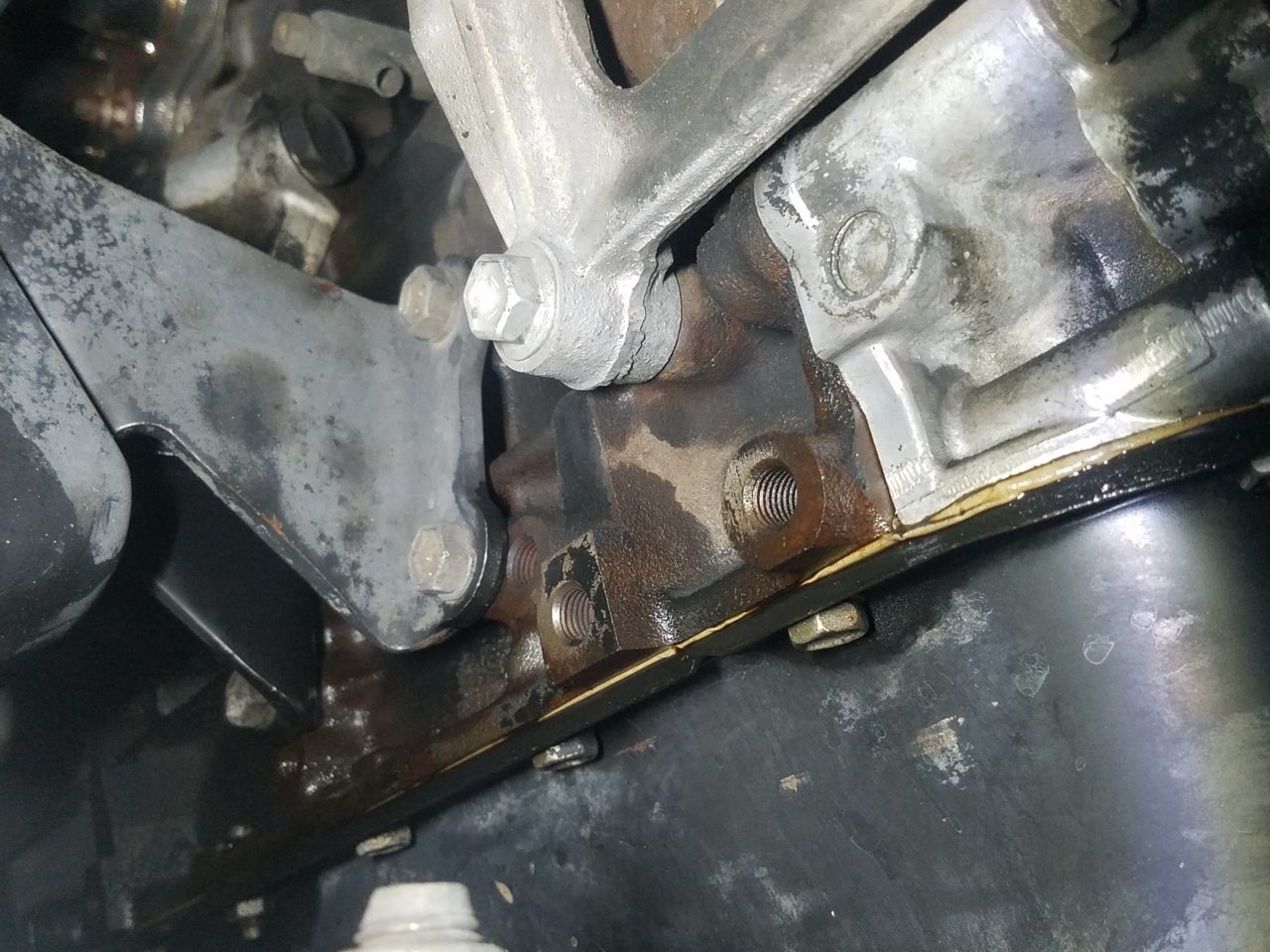

    May be an oil pan leak, but I think not. Most of the oily evidence is above the pan, which leads me to believe it's something else dripping from above. Spray brake cleaner and wipe it down and then check it in a day or two and see if you can trace it. Pic #2 looks like maybe a power steering leak/spillage and Pic#3 looks like it could be from a leaky crack shaft seal.

    I mean crank shaft seal.

    When y'all say "crank shaft seal", are you talking about front if motor or rear?
    six5crèéd likes this.
  16. Mar 12, 2020 at 6:39 AM
    #16
    six5crèéd
    six5crèéd Be the light
    Jul 9, 2019
    #298734
    35,347
    Southern Virginia
    8 lugs no plugs
    I understand it as front when someone says "crank shaft seal" otherwise it's referred to as "rear main".

    Gotcha. That doesn't sound too bad of a job. If thats the little cover down low on the front of the motor, it does look suspicious.

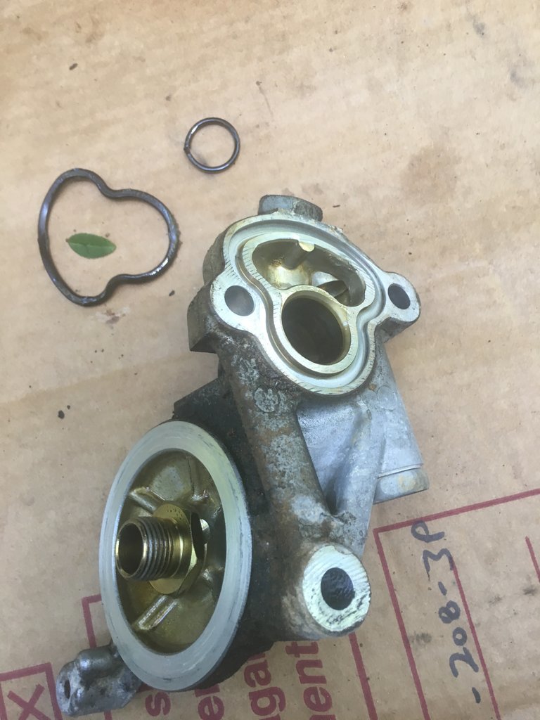

    Check the oil filter mount. Mine was leaking because the gaskets were starting to rot.
