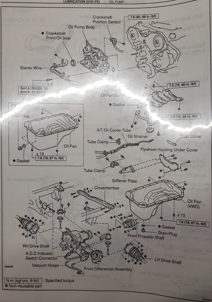

    One is plenty.
    OP, here's the fsm pages
    Key-Rei likes this.

    Being that resealing the pan is a time consuming project, why not just go with what Toyota recommends?
