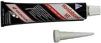

    Yes…I use Hondabond on everything myself
