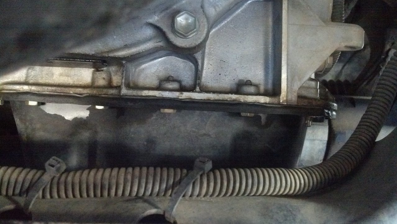

    I'll upload some pics (they are night time pics so bad quality).

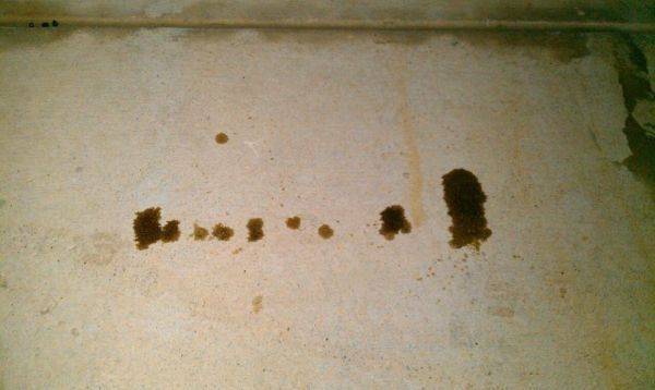

    So here is the drip I saw when I got home today, I know it has been there no more than 3 days, but I'm pretty sure it was not there yesterday afternoon.
    It is about 2 ft. across (dripped onto the frame and dripped down from there is why it is so long)

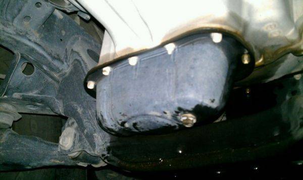

    This is viewing the pan from the front of the vehicle

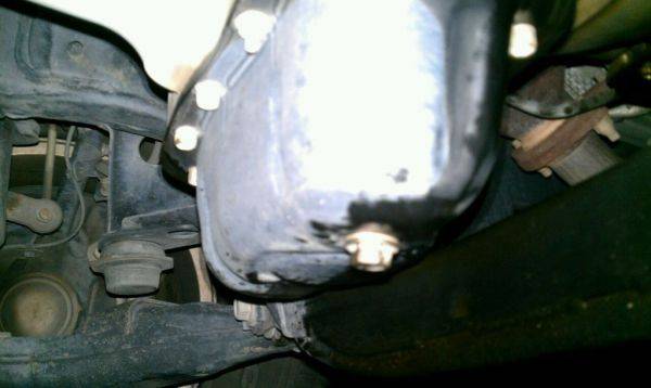

    This is from the back, where it appears most of the leak occurred

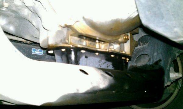

    And a fuzzy view from the driver's side

    It looks like you have a pretty good leak. What you gotta do is get some simple green and a scrub brush and clean up as much of the oil splatter as possible and hit it with a hose. Then run the engine hot and see if you can spot where the leak is coming from. You may have to ride it around the block to get it to show you.

    Ya... depending on the year and engine model (that doesn't look like my 2.7), there may or may not be an actual gasket.
    Starting back in the 90s, Toyota started moving away from gaskets as much as possible and using RTV instead.
    That first pic looks like it may be coming from up higher though.
    What has recently been done? Is there a chance that it's running down from the oil filter mount?

    I thought it looked a lot higher too first, but traced it as best I could and it looks as though it has splashed up and over everything else (including the tranny).
    I think this was just confirmed. I cleaned it up real good (not with a degreaser or anything), wiped it up with paper towels. Then examined it real closely, had my wife start her up as I watched it, nothing. Drove it about 5 miles, checked it out and where the gasket/rtv would be, it was very saturated.
