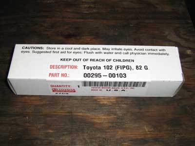

    I know it’s a little pricy but this is what Toyota uses
    for oil pans and water pump’s.

    ^ripoff

    thanks guys for all the great replies, i mean it. keep up the good work. hey beef taco, i don't know where you live at, but i think your dealer is r.y.n.o., i actually called me dealer earlier in the week, and the price here in God's country was 16 bucks for a tube of fipg.

    I said it was a little pricy I have been using it 9 years longer than you have been alive I would not use anything else just my opinion to each there own.

    beeftaco, that stuff must be the balls and the cock if you have been using it for 33 years.

    I have worked for Toyota for over 27 years and have used it fix a whole lot of other things than just cars even used it to seal some toilet plumbing once.:p
