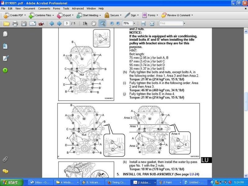

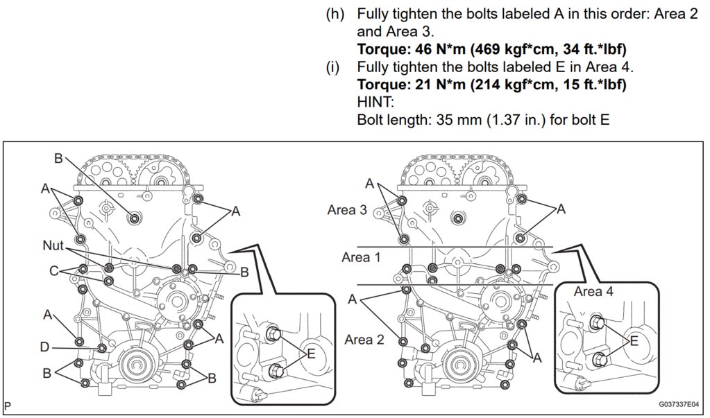

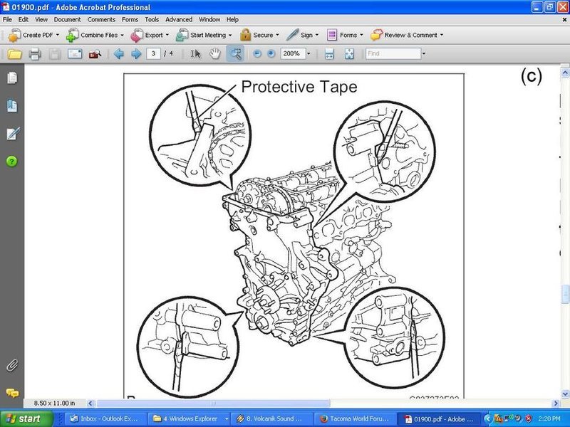

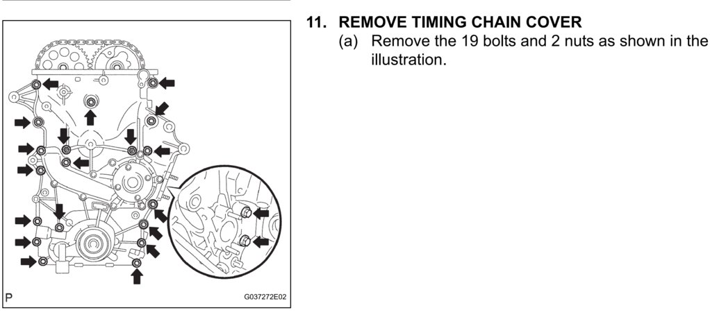

    There's a spot made for prying on it. So you dont mar up the sealing surface. Also I think there are a several bolts from the upper oil pan that go into the bottom of the timing cover.
  11. Sep 4, 2025 at 12:04 PM
    toyodajeff
    toyodajeff Well-Known Member
    Nov 11, 2009
    #25817
    2,548
    jeff
    06 reg cab sr5
    Top pic is prying spots on head.
    Bottom should show you all the bolts to remove timing cover except the ones that go through oil pan

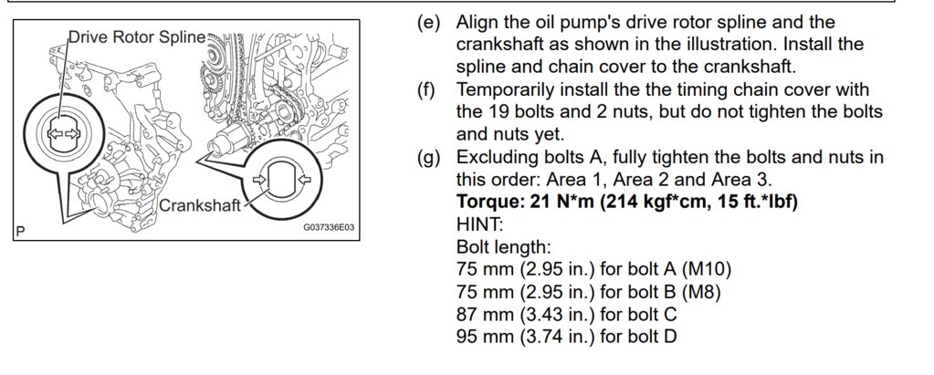

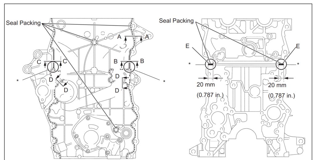

    The reason you have to take off the oil pan is so that you can real the bottom portion of the pan to the timing cover.
    You have to take off the lower oil pan to remove the upper pan.
    Technically, you should not have to remove the pan to remove the timing cover.
    But you'll need to once you go to reinstall the timing cover.
    On installation. Be sure to apply RTV to the circled positions shown below (A, B, C, D, E)
    If you don't, it WILL leak.
    Next, install the cover.
    Be sure to follow the steps here.

    Thanks a lot for the comments and pics of prying spots… I didn’t have one of the last bolts removed that goes into the oil pan and the timing cover (because this truck had an oil leak and lived in dirt roads it was caked in gunk covering it).
    I still am having a hard time trying to pry it off and I got all the bolts off in that photo, the 4 underneath it and the 2 nuts and 2 bolts going in on the back driver side…
    I don’t have a garage so removing the motor to take the pan off isn’t really feasible for me (atleast at this point) . I’m gonna try using the prying locations u sent and update yall if I’ve pulled it off then.
