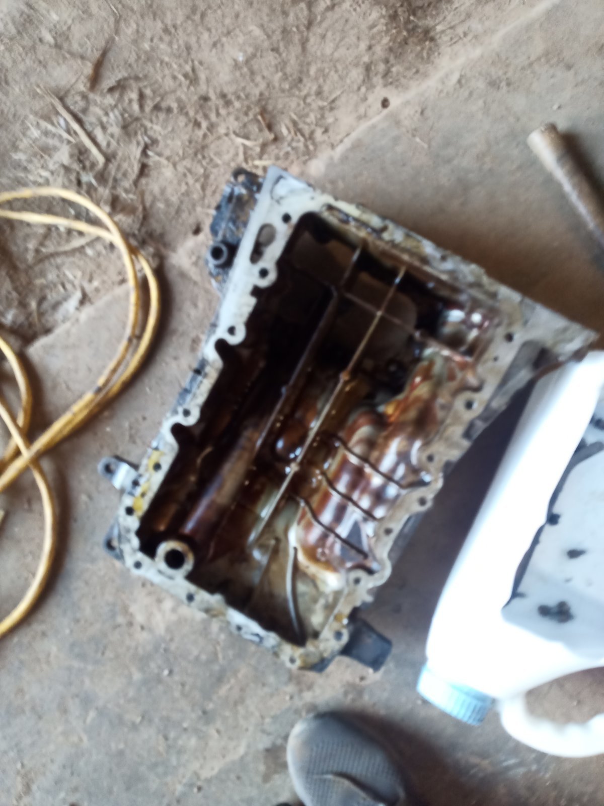

    I need some help with this...

    So not the lower steel pan but the upper aluminum pan?

    Yeah, I worked on it a few hours today, cross members, power steering, studs, tensioner... Something was just barely in the way regardless of which corner I was trying to get to come out

    It's a pain, its been years since I've done the aluminum in the truck.
    I believe the rack has to come out, but you can try loosening it off (2 giant 19mm), and disconnecting the shaft to the rack to gain more clearance.

    I took those 19mm out and even put a ratchet strap on it to pull it forward to try and take advantage of the taper to the front of the pan... But I still need 1/4" of clearance everywhere I tried. I guess I'll disconnect the rack and give that a try

    I've done a good deal of wrenching on Toyotas, and excluding having to disconnect the engine mounts and jack up the engine on a 2az fe to replace the belt tensioner, because one of the bolts was 1/2" too long to come out without hitting the frame (or they could have put an access hole a socket and extension would have went through...) this project has made me question a few decisions made by the engineering team... Like seriously the rear cross member could have been moved back 1/2"... I kept telling myself not to grab the grinder or zip saw lol

    I did it to mine before. Put a hoist on the engine. Took off the top nut to both engine mounts. The 17mm nuts. Jacked the engine up as much as possible. Then dropped both pans.
    Don't forget about the two 10mm bolts holding the rear main to the upper pan, and the bolts that you can only gain access to once the lower pan is off.

    I would have missed those two bolts had I not found your post. I pryed on that thing for 20 minutes wondering what the heck kinda rtv had they used lol
