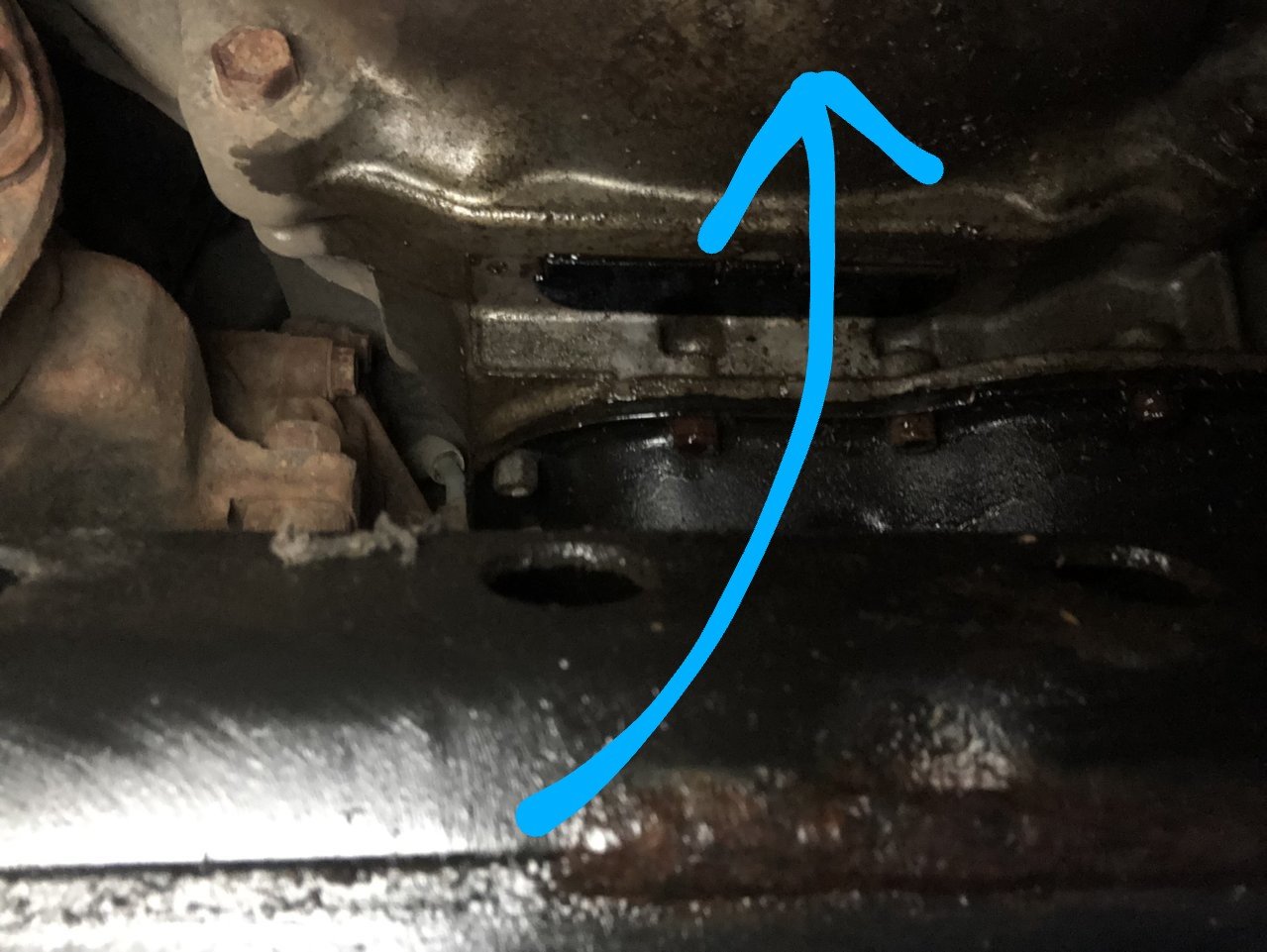

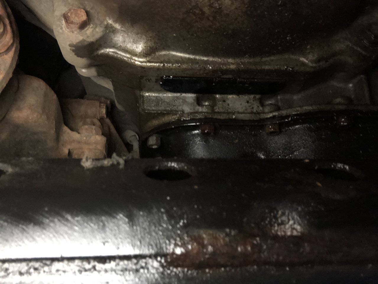

    Anyone blow an oil pan seal yet? 2016 104k miles.E27436CE-8EEB-44AB-A280-F5C8F3798404.jpg75F6C6E0-152C-4A9D-8EB4-BCDC01EEE6AE.jpg

    The oil pans (yes plural) are selaed with FIPG which typically doesn't fail.
    Looks like you're in for a rear main seal given it's heavier around the weep hole for it.

    where would that be located in relation to the photos? Where that black metal tab is?

    Between the engine and transmission, it seals the crankshaft to the rear end plate, your leak looks exactly like mine when my rear main seal went bad, the front main seal was starting to fail around that time too though not nearly as bad.
    You must pull the transmission to replace the rear main seal.
    It's way up in there behind the torque converter.

    Leaks are almost always from the highest point. Looking at your bellhousing there like others have said kind of looks like a rear main seal. A rear main seal is the seal on the end of the crankshaft that keeps engine oil in. Depending on the vehicle to replace them the transmission needs to be removed unless it is a two piece seal which I don't think they do anymore.

    Thank you very much fellas, I ended up finding another post about this as well. Looks like I’m about to shell out some cash!
