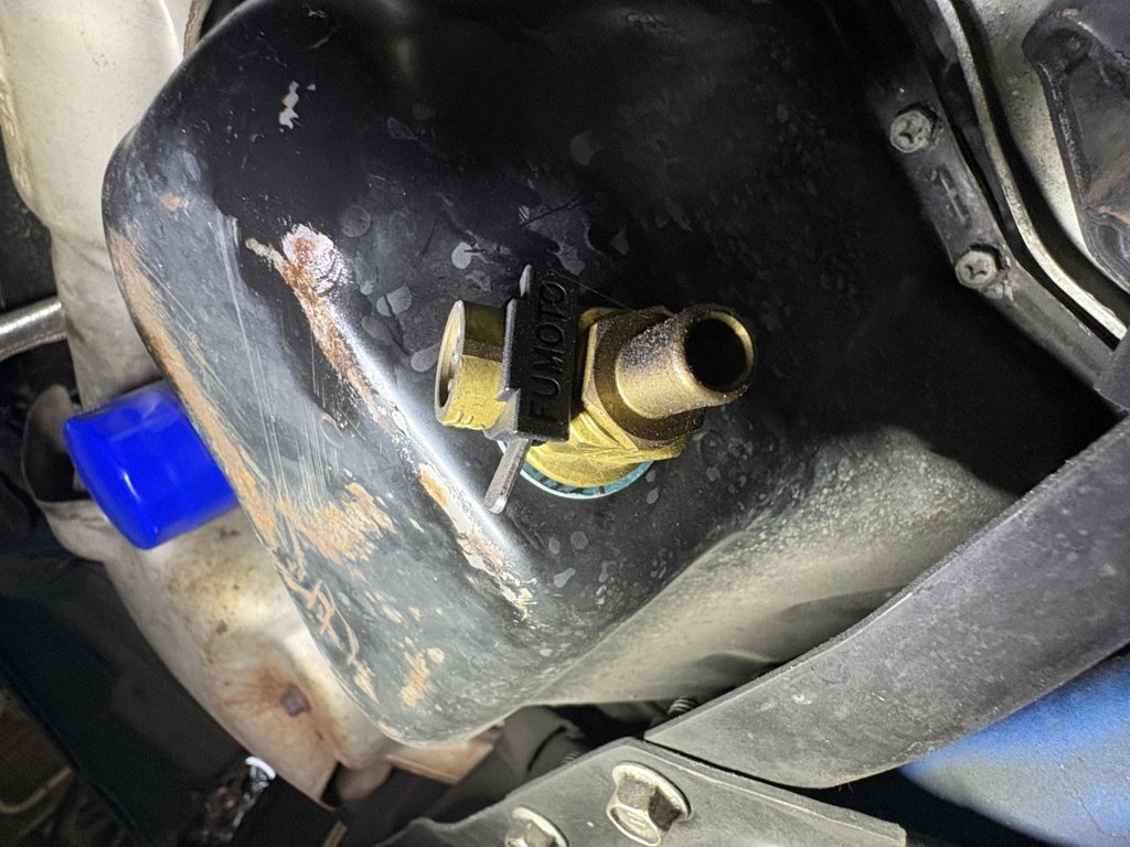

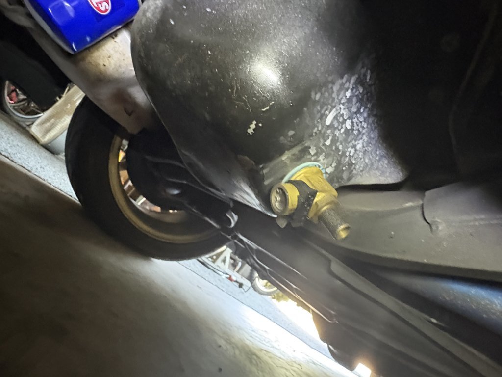

    Jul 22, 2023
    #429578
    3,468
    Steven
    Sugar Land TX
    1996 Taco 2.4L 2wd Automatic
    Clock Volt meter/LSPV Delete/Hyundai 16’s/FP gauge/after 9months of wrenching ZERO oil leaks
    Ugh
    Sorry OP
    Here’s my Fumoto Quick valve
    Zero issues 4yrs
  14. Jul 29, 2025 at 4:59 PM
    #34
    ControlCar
    ControlCar My Moto: Help & Learn…period.
    Jul 22, 2023
    #429578
    3,468
    Steven
    Sugar Land TX
    I just got off phone with my oil field welder friend
    He 1st said the proper way to weld a a new bung would have to be done with pan off
    Outer/clean then weld the inner
    That fumoto valve is brass as well(cannot weld brass to steel (only solder))
    The biggest reason for this is thinness of the pan and the weld needs to hold a petroleum product
    he said a chance that outer only weld could hold for a while if done/metal prepped correctly. This could be difficult bc no matter what….some residual oil will seep out and contaminate welding surface
    Also stated that the bung has to be shallow….cannot extend too far up in the oil pan bc will not drain fully
    as we talked, a die thread cutter was brought up……but typically the sets we have seen are pretty small……then changed my search pattern…..
    Success!
    this:
    https://www.ebay.com/itm/1546446072...pRRWS2rd_JPH96rtXj5dV2DXcvNJXJmQaAqjBEALw_wcB
    More better quality out there
    Comes with taps and matching new drain plug bolt
    just need to make sure of size!!
    GL
    #34
