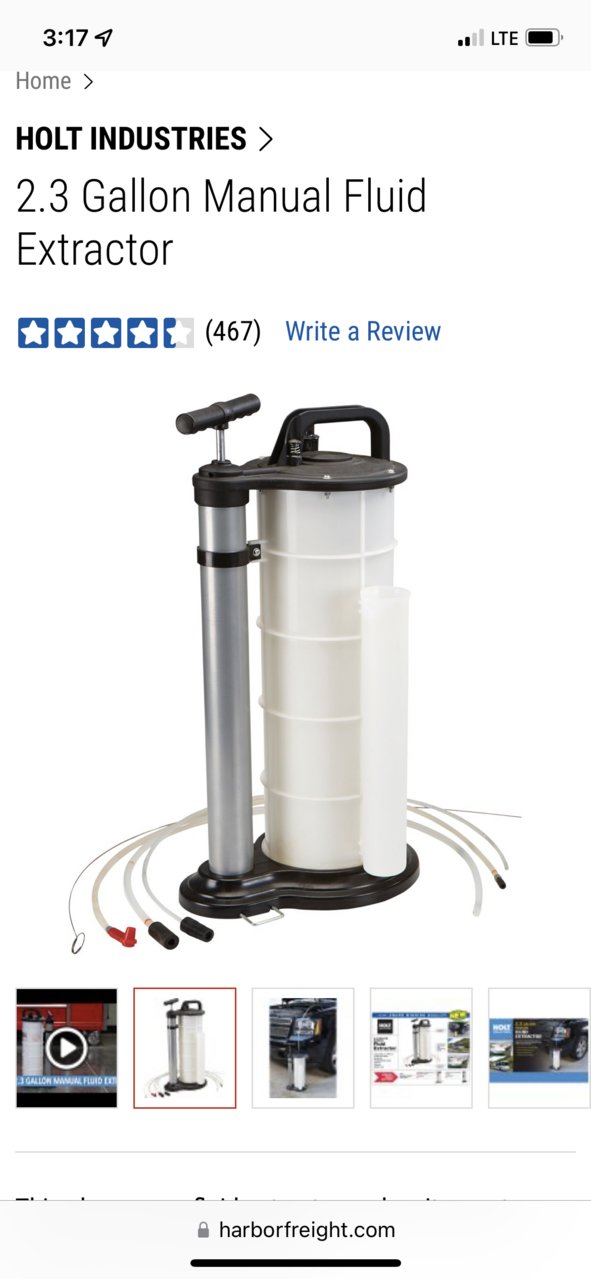

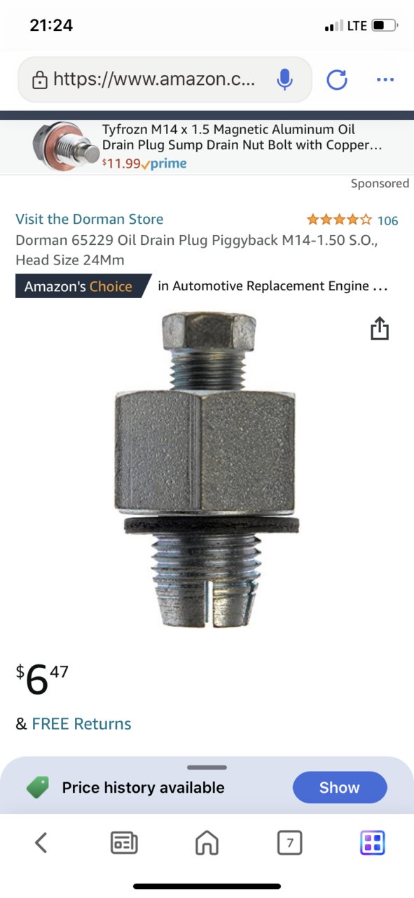

    You could put an oversized plug in it. They basically cut new threads but once you take it back out that’s pretty much it so you will need something like this so you done have to take out the plug to remove the oil. You can just extract it from the dipstick tube. 04DBA36D-2581-4C12-B2B1-C36D3E74E1FA.jpg

    Not a bad idea - the material by the time you get out to a size M14 might not be as thick as the material they use to thread the original plug into. May want to throw a tack on it if it seals.
