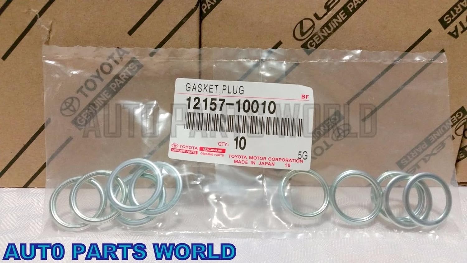

    I’m a bit confused. Which one is the correct oil drain plug washer the “felt washer” 90430-12031 or the crush washer 12157-10010?

    My 2014 came with the felt covered washer, but either one should work.
