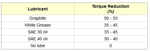

    I stripped my transmission drain plug by torquing to spec. I learned the hard way that torque specs are normally given for dry, unlubricated threads. Wet or lubricated threads materially reduce the torque required. I knew the plug was stripped because next time I went to change the transmission oil the plug was hand tight. Since then I don't use a torque wrench on wet threads.
    Let's assume that your torque wrench is accurate, and for wet threads you should use 75% of the dry torque spec. (This 75% is an estimate and there could be a wide range here).
    Dry torque of 30 x 0.75 = 22.5 for wet torque (again 75% is an estimate). Your torque setting of 35 (5 above 30 standard) is 56 % above 22.5. Hopefully the threads on the drain pan aren't damaged, but there shouldn't be a need to over tighten a drain plug to stop it coming loose. I have a 2010 too, with 44 oil changes, no issue with the original drain pan or original drain plug (hand tightened snug - no torque wrench)
