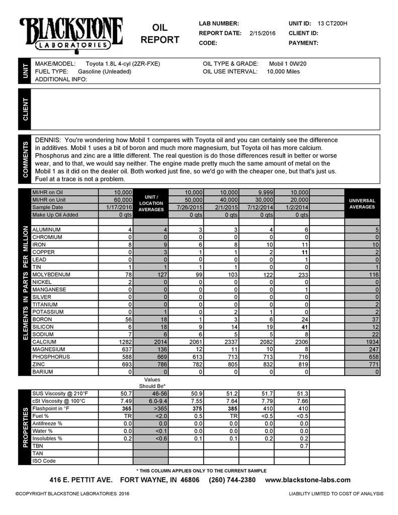

    Personal preference as Mobil 1 UOAs show no real benefit to the Toyota oil. Here's one at 60k miles where the others were the Toyota Synthetic. PUP, used on my other vehicles, showed significant reductions in oil consumption as well as cam/valve noise and UOA's have always shown good shear stability.

    Thanks.
    As for Mobil1 vs Toyota branded oil similarities that's not real surprising... :D
