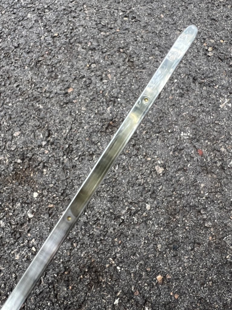

    I am not arguing with you. If you all are telling me it won’t affect oil pressure then I accept that. Dip stick readings are high which is my main concern. I thought oil pressure would be a proxy for oil levels that but sounds like it’s not. They overfilled my truck the last time (before my last truck was stolen) but nobody would pay any attention when I sent an email and had no time to book another appointment. They never showed me anything—my experience is all they say is oh it’s supposed to be that way no matter what you put in front of them, whatever it takes to make you go away. I’m not necessarily the wrong party. Just asking for some help.

    #448730
    193
    1/4" or so high on the dipstick is not going to harm your engine. Probably translates to about 1/3 qt or less. Be glad that the dealer did at least that. I had a Nissan dealer once that failed to put any oil back in after an oil change. Caught it before leaving the lot. Always check your oil before leaving the dealer!

    Yeah. I did check it. Also checked the skid plates and bolts. The issue isn’t me not checking it’s just the mindless “that’s normal” when I showed them the dipstick reading. They just keep repeating that until you go away. But thanks for this feedback.

    #448730
    193
    Well, it's their 'normal'. Every 2024 Tacoma that gets their oil changed there probably has the same dipstick reading. Probably a particular notch on the oil gun. The lower notch, not enough oil. The higher notch, too much......much more than yours. So that's where the tech puts it.

    LOL. That’s 100% true. And the average person gives zero fucks. I’m going to start changing my own oil.
    I wonder how many quarts the low versus high notches are. I remember the old 3G manual had that level of detail.

    Manual (p526) says 1.5 qt.
    Says to add oil if at or below the lower mark.
    Also warns about not exceeding the upper limit.

    Exactly. And it looks like I could be 0.5 to 0.75 overfilled.

    agree. It's about a half qt by my guess too.
    I checked the oil in my truck after a couple thousand mile road trip. Cold engine, thought the truck was flat. For some reason it looked about a half quart low. Still between the dots though.
    Added a half quart while on the trip. Thought everything was fine, got back home a few weeks later and noticed it was over the full line on the dipstick.
    I'm a little OCD about it so I drained about 400ml out.
    Now it's just a hair above the full line.
    Either I screwed up measuring it, or there's some sort of crazy fuel dilution. I would put the odds on my error.
    In either case, I don't think I have qt is really going to make a damn bit of difference.
    The moral of the story don't fill it to the full line, go about 3/4 between the dots. And don't stress about the oil level as long as it's between the dots.

    Just dropped kids off at school. Going to test level again and post here.

    Northern California
    2024 Bronze Tacoma TRD Off-Road
    Use a file and score (light passes are fine) both sides of the acceptable read area on the dipstick. Just remember to clean it before re-inserting...

    slater
    slater Well-Known Member
    Apr 16, 2024
    #448066
    2,699
    San Diego
    24 white Tacoma TRD Sport 2wd
    a pick / scribe....

    Got her warm on an 25 mile drive, and let her sit for an hour. Clean read.

    OK, now move on…
    It’s not overfilled, your oil pressure is OK!

    Not Enough
    Sanding and or filing will work in most cases. I have always beadblasted the ends of all my dip sticks.. I need all the extra help to see with my senior eyes.. just like everyone has said clean clean clean before inserting
