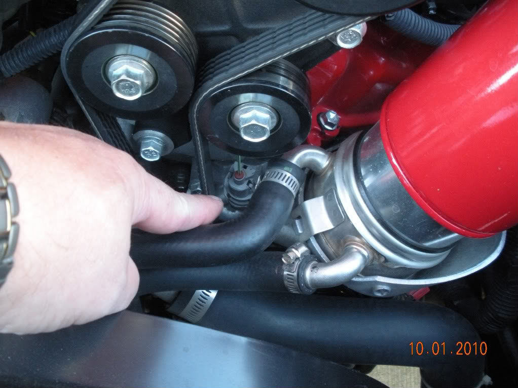

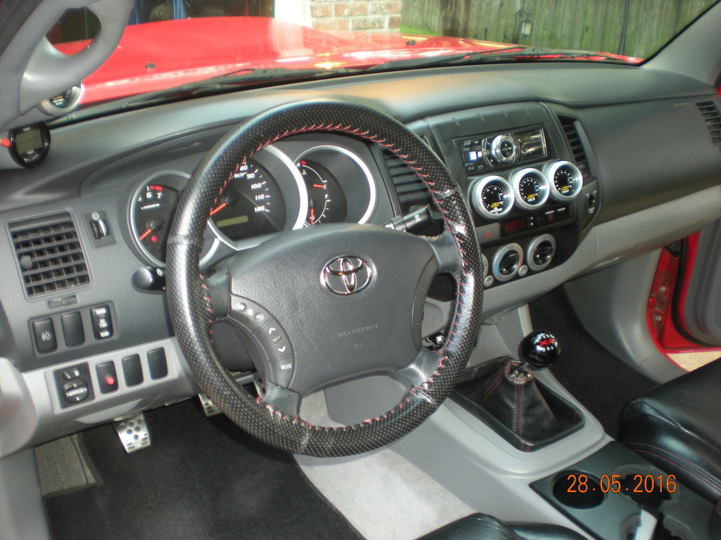

    I made this triple gauge panel out of a single din radio mount.
    You will see boost, oil press & volts.

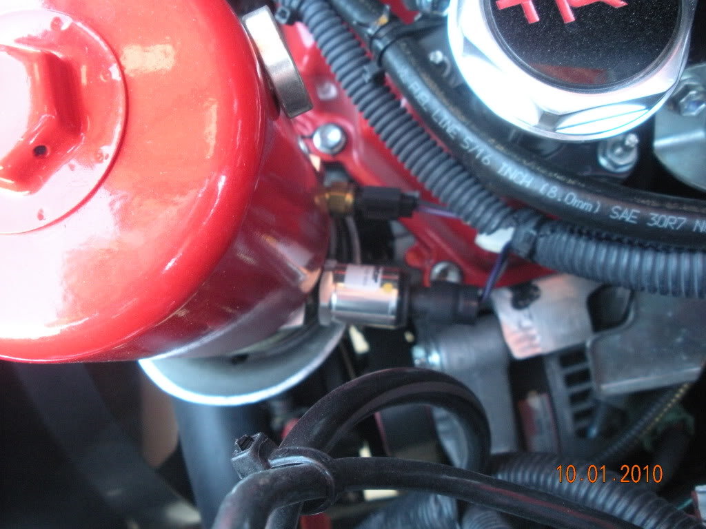

    You have a couple of choices for the sender.
    1. You can use a sandwich plate between the oil filter and the engine.
    Look at the oil filter and you will see a shiney spacer under the filter.
    Look at the back side of the oil filter (towards the firewall) and you will see the senders jutting out of the spacer.
    2. In this picture, there is no spacer. There is a pipe plug under the engine oil filter mount. You might need a mirror on a stick to see it. I can not remember if it is 1" or 1/2" npt. You can use a pipe reducer to adapt to a sender unit. That is what I have done in this pic.
    This is just for reference, but I am pointing to the factory oil pressure sending unit. It should be noted that if you try to tap off of this, the threads are NOT npt. There are BSPT (British Standard Pipe Threads). You can get fittings at McMaster Carr.
