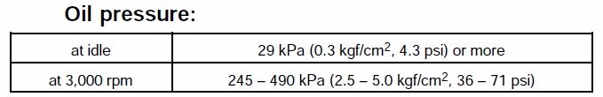

    An easy way to test this hypothesis is to take the pressure switch sender off and connect a pressure gauge
    These are manufacturer specs (I believe it should be minimally 10psi per 1000 rpm
    It may be low
