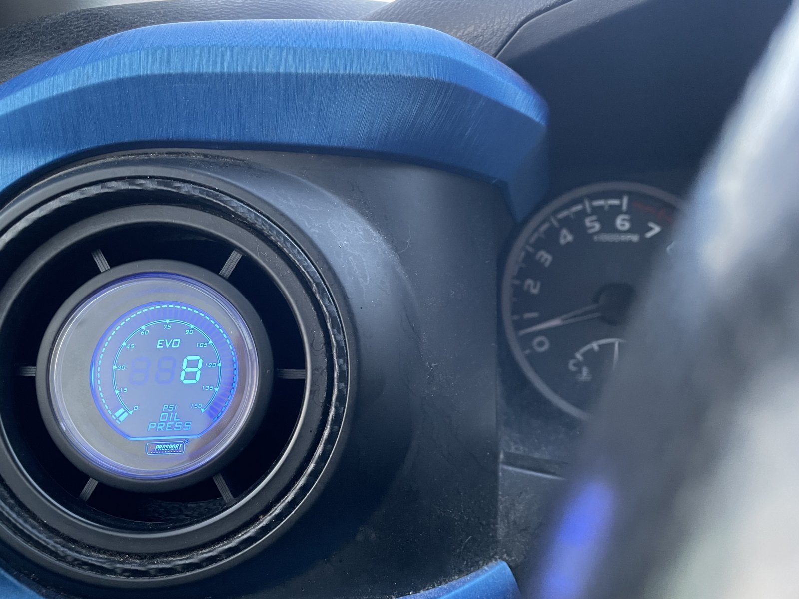

    I recently installed a Prosport Evo oil pressure gauge on my 3rd gen with the 3.5 V6 and am curious on what oil pressure values others are reading at idle.
    I’m getting down to 7-8 psi at idle (500 rpm) which seems really low to me. At 2500 rpm I’m reading 35psi, 4500 rpm is 55psi
    anyone else been tracking oil pressure?

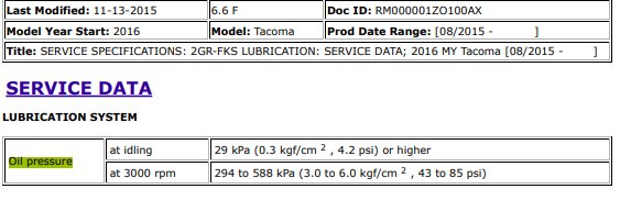

    The pressure at idle is fine. 2nd gen is the same , about 4.2 psi

    @Vlady coming in handy with the data, thanks much. What is that you're using for reference? Looks useful

    Sorry, here is Tacoma's 2GR-FKS numbers

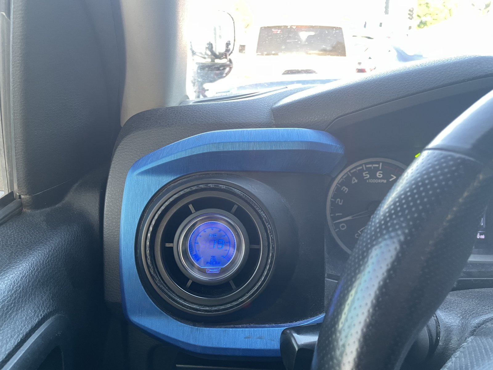

    how do you like your gauge? the glare on the pictures makes it look like it will be difficult to read during the day
