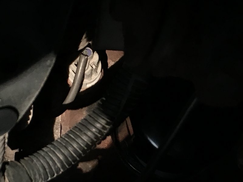

    So I mistakenly busted the wire on what I believe is the oil pressure sending unit while changing my oil filter. I also noticed my tach, speedo, temp, and gas gauges aren't working.
    Is this due to the busted wire or did I break something else and not realize it? How do I fix the sending unit? Can the wire be spliced onto a new unit?
    Also, the guy at the dealer gave me a yzzd3 filter instead of a yzzd1. I didn't realize until it was too late so I put the 3 on. Should I switch it back to a yzzd1 ASAP?
    Here's a pic of the busted wire.

    That shouldn't effect the other gauges. Check you gauge fuse

    if the wire is broken right at the plug and not enough length to crimp or solder back together might be best to just replace the connector entirely
    maybe theres a speciality tool to remove the wire from the plastic connector but not sure on that and would probably cost as much as the new part anyways

    May need to buy the terminal from Toyota

    Right, If it's just the electrical connector that can unplug from the unit where the wires broke you may need to buy a replacement connector and cut and splice in the wires from Toyota or may have luck if you cut your broken one off and bring in to a parts store to match up a replacement... Or cut one off a junkyard motor. Shouldn't need to replace the whole unit if just the detachable electrical connector broke
