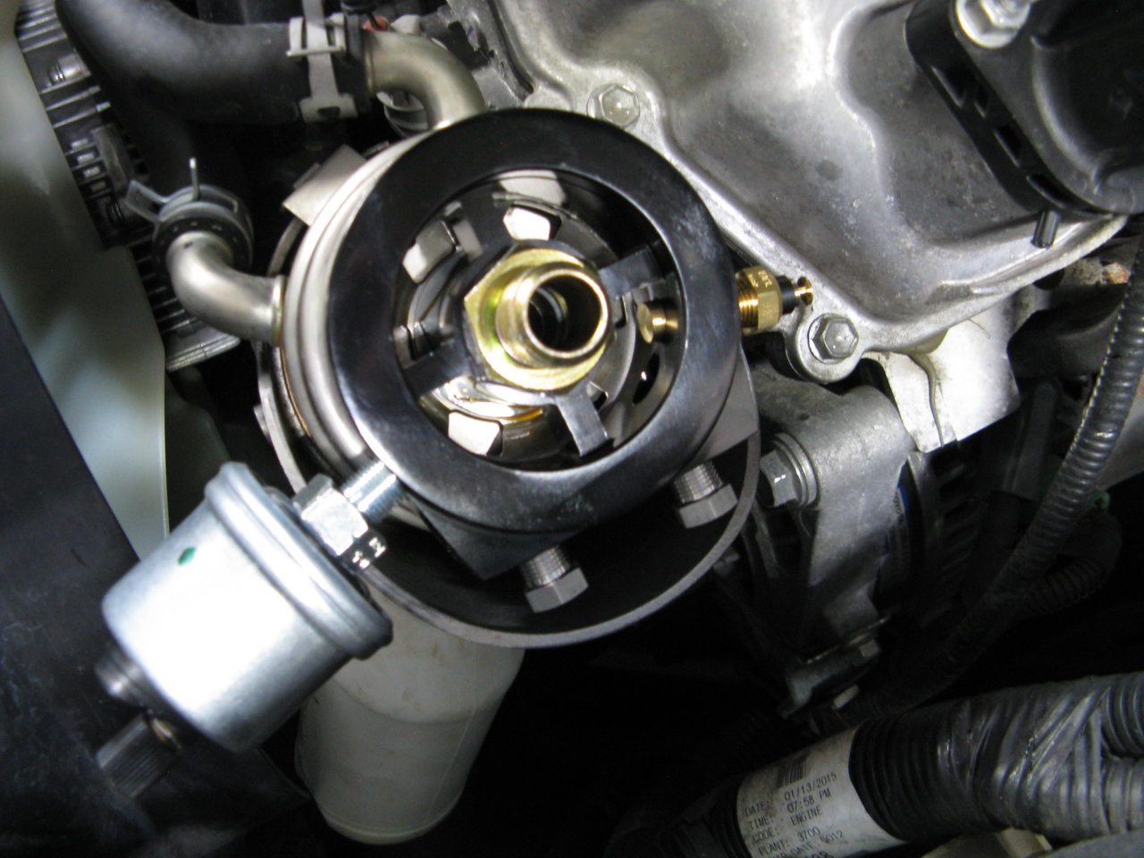

    My experience parallels Dave B.in Va (in fact, my install was inspired by him in a post some time ago). My adaptor plate has never leaked nor have any of the senders. My plate adaptor was installed using thread locker. My oil temps mirror Daves. I run VDO gauges, because I had them laying around from a past project. My gauge lighting is on with the ignition. I replaced the incandescent gauge lighting with LED's and silicone sleeves (red). The lighting is subtle but effective and the LED's should last the life of the truck.
