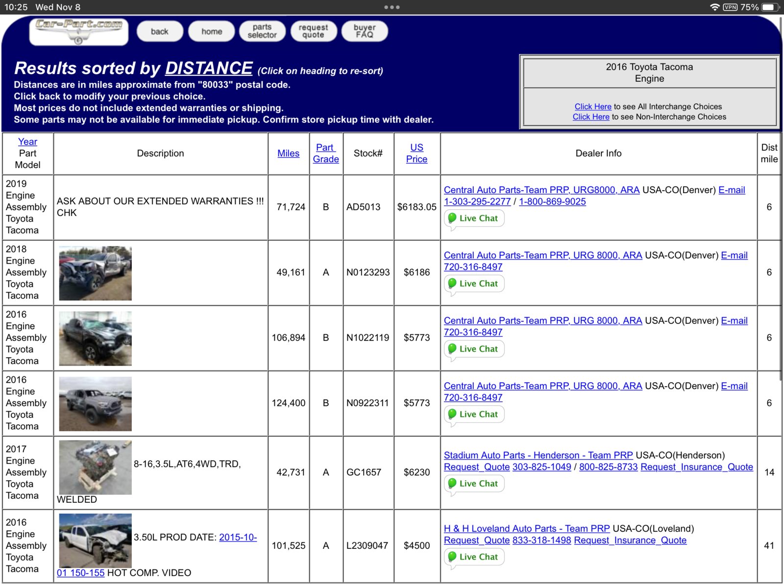

    I’d press Toyota to help out on this for you… though even if they cover 50% or all parts, you’ll still pay the other half or labor etc and it won’t be cheap.
    I like the idea of a low mileage motor out of a newer taco. Direct swap over. Believe these motors go for around 5-7k used, and you should be able to find a shop to drop it in for a few grand. Will be far cheaper than the stealership, likely even if Toyota helps put.
    Good luck… sucks all around. My truck is at 91,750 right now so can feel your pain.
    edit… you can search for a motor at www.car-part.com. It’s a nationwide search at salvage/junk yards. Likely someone has a motor close to you in a totaled Tacoma.

    Some examples…

    Now rebuilding a 3.5L... these blocks are not rebuildable. The have very little room for boring the liners and relining it would be too costly. So I would be very skeptical of any rebuilt engines on offer...
    This leaves new or used as options. New, well. That would be so costly, you might as well look at a new truck...
    So used, a quick look on Car-part.com, there are quite a few used engines across the country. On Craigslist, in my area there is a 47,000kms engine listed. This will most likely be the most cost effective way to go.
    Look for something that offers up a decent warranty on the part. A good auto recycling company will offer them. Then find a quality shop to do the swap. Not the dealer... unless you are fine with the high labour costs.
