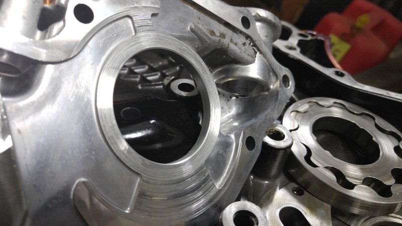

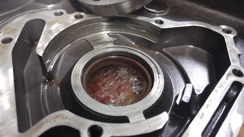

    Oil pressure light on means 20 psi or less.
    You have to pull the timing cover to replace the oil pump. If the timing cover is scored then JB weld, or fork out for a new one.
    This is one that ran out of oil on a dyno.
    Here is a good one.
