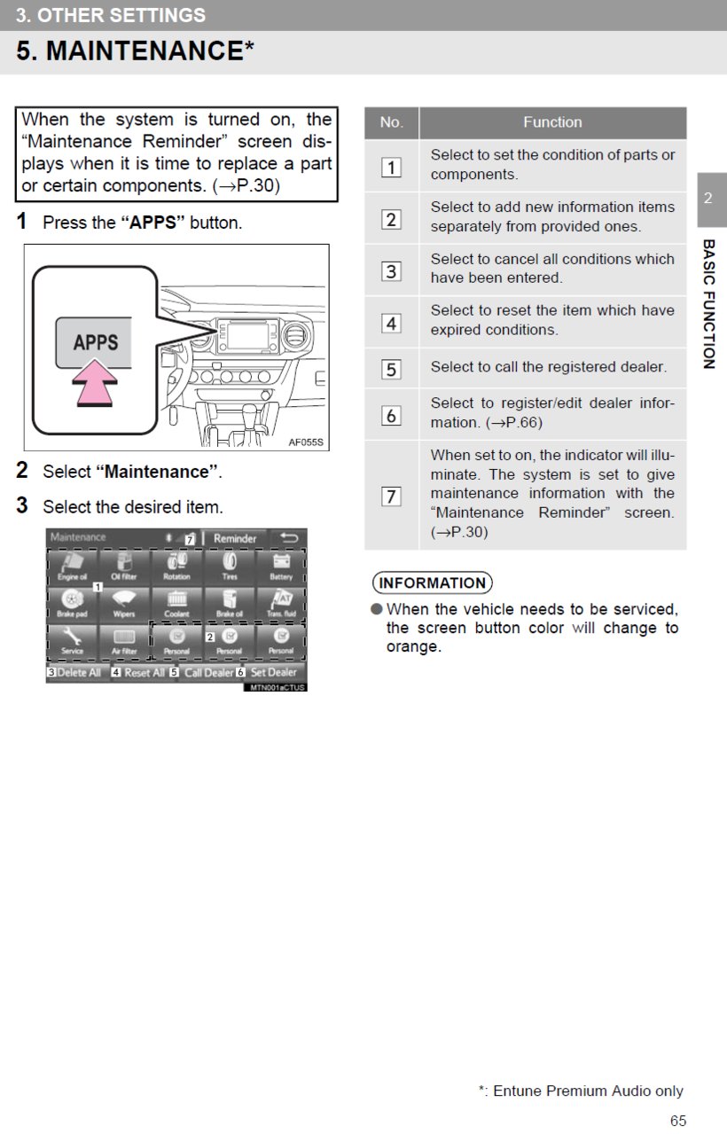

    I have a 2021 Tacoma off road with premium audio how do I reset the maintenance reminder it's not on my steering wheel when I go to the gear and scroll down found maintenance on the main screen under vehicle is that the only one to reset

    Here you go:

    I don't have that and tried the trip A hold it still nothing was reading if it has premium audio it's on the main screen

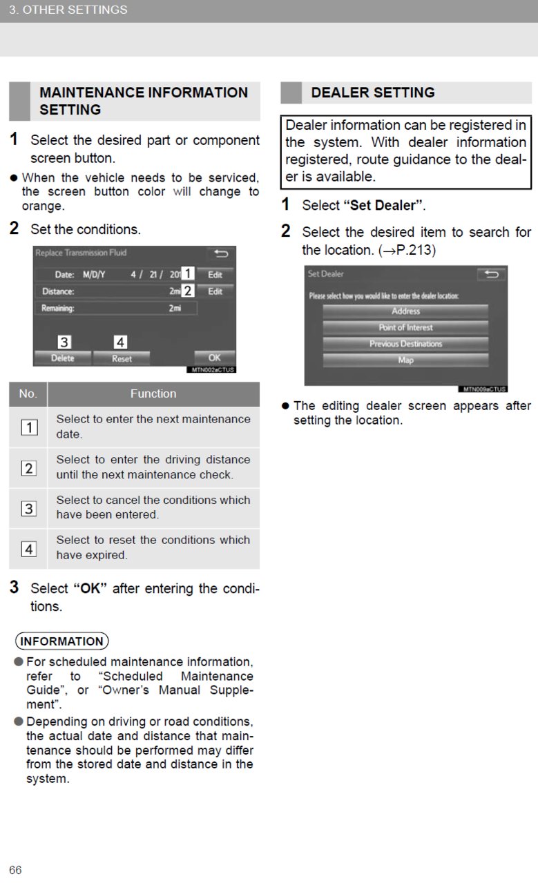

    I was confused by what you were saying. In the head unit, you can delete all maint reminders. The Trip A reset will only clear the one one the center stack. You will still get the center stack one every 5k, but the others will be gone.
