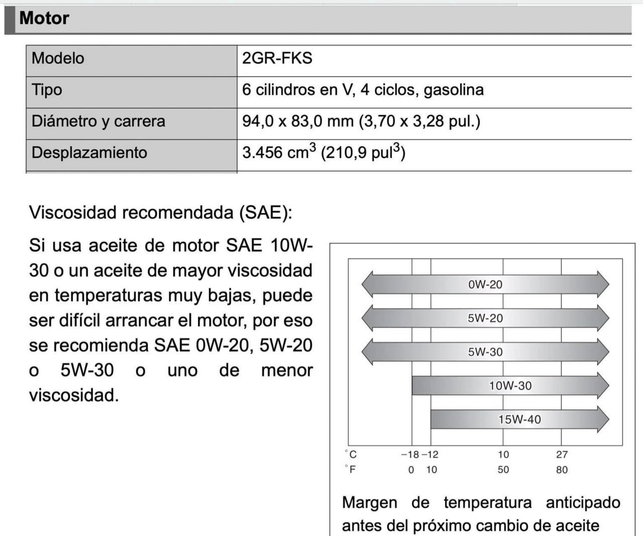

    The EPA literally dictates to the manufacturers what can be printed in the owners manual, what the maximum and minimum mileage intervals of maintenance can be, etc. I know researching substantive law and policy is difficult -it is made this way on purpose, but all the data you need to see that you are spreading misinformation is available at your finger tips through some diligent searches.

    My 2GR runs exactly what it is designed to, which is a 20, 30, or 40 weight oil based on driving style and temperature and climate.
    See again page 574 of the U.S. 2017 Tacoma Owner's Manual: "The 20 in 0W-20 indicates the viscosity characteristic of the oil when the oil is at high temperature. An oil with a higher viscosity (one with a higher value) may be better suited if the vehicle is operated at high speeds, or under extreme load conditions."
    Now to answer the OP's question accurately: You can use 0W-20 to 15W-40 in the 2GR-FKS engine based on your area's climate and your driving style. Do not use a 50 weight oil. See the Mexican Owners Manual for the 2GR-FKS below.

    I think there is some misunderstanding here. The EPA mandates CAFE which is the average fuel economy across the brand lineup. If they don't meet the CAFE, they are fined for it. They use thinner oils to help meet CAFE. What they design and test the engine on and get fuel economy estimates for, is what they have to recommend to the owner to use in the USA. Hence why the USA owner's manual says only 0W-20, or 5W-20 temporarily.
    In other countries there are no such rules, so the Tacoma in Mexico gets the go-ahead to use all of the viscosities listed earlier in the thread: 0W-20, 5W-20, 5W-30, 10W-30, 15W-40. Obviously, alternates of the same weight are fine too, so 0W-40, 5W-40, and 10W-40 would also work.
    20W-50 is not that far from 15W-40. It would likely be just fine. It is not technically listed by Toyota, so probably best to stay with 15W-40 and below.
