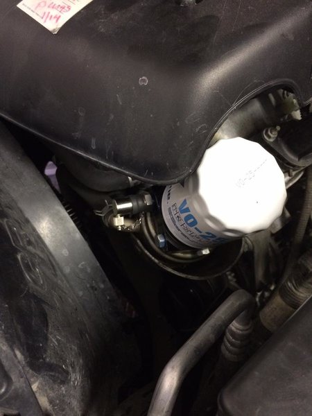

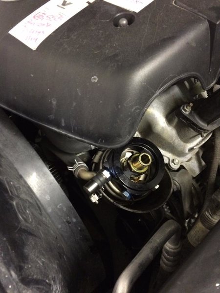

    Here is a pic of oil sample port installed, I can now push a button with engine running and collect an oil sample, this will save a ton of time and can easily sample between oil changes

    To pull a clean oil sample to submit to lab

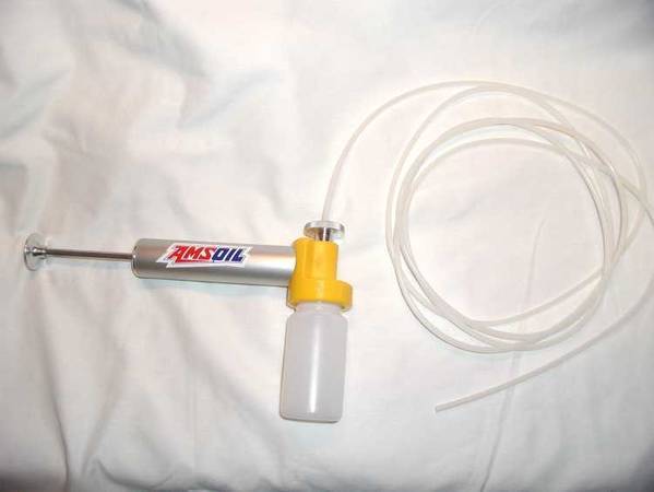

    This is what you use to pull oil samples. You want the oil at operating temp and pull from the oil pan. not the bottom not the top but the center. I have been doing oil samples on my customers engines for 20+ years. I do not like using this type of port due to it using the engine oil pump pick up that sits very low in pan. I would not trust a sample done in this way. I have seen too many samples come back bad due to the sample being pulled incorrectly from the bottom of the oil pan.

    so with that vacuum pump you will pull a sample from the bottom of the pan picking up accumulated wear metals, showing artificially high wear, I should have phrased differently," easy way to pull sample before an oil change" Or in my case doing trend analysis to find the optimum change interval, If it is such a stupid idea, why does cat equipment and most major HD engine manufacture's provide a sample port?

    agree probable over kill, just don't like the mess of mid drain samples or, vacuum pumps, Works like a champ start engine put a sample jar below checkfluid valve push button takes about 30 seconds to fill a 4 oz. sample jar, Hind sight should have teed off of oil sending unit and run a hose to a good spot, just watching oil analysis close seeing fuel dilution 3-4% at 5k intervals, going to see what 3 and 4k samples look like
