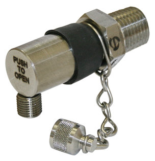

    HAS ANYONE FIGURED OUT A WAY TO INSTALL AN OIL SAMPLE PORT, THERE ARE PARTS AVAILABLE FROM CHECKFLUID, I HAVE USED A KP PUSH BUTTON ON HEAVY EQUIPMENT AND FIND THEY ARE A GREAT WAY TO PULL AN OIL SAMPLE, I HAVE A 2012 TACOMA AND TRYING TO FIND SOMEWERE TO TAP INTO PRESURIZED OIL TO PULL A SAMPLE WITH THE ENGINE RUNNING, ANY IDEAS WOULD BE APPRECIATED

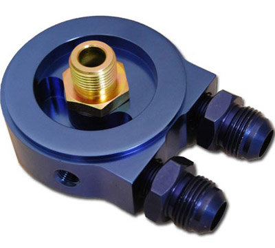

    Maybe an oil filter sandwich adapter?

    the above picture I want to install

    Yeah, put it in one of these.
    Just plug or cap one side, install your sample port on the other.

    I like oil sandwich adaptor were would I find one

    perfect idea thanks

    A metric shit-ton of companies make them. I can't remember the thread pitch offhand.
    I've been thinking about getting an Amsoil adapter to run a bypass filter system.
    Edit: Looks like 3/4-16 for thread.

    found one on Amazon $23 sounds fair
    thanks for the idea

    From reading these threads and former folks who use one the Greddy seems to be the best rated sandwich plate. Just an FYI. I have one and it hasn't leaked yet.
