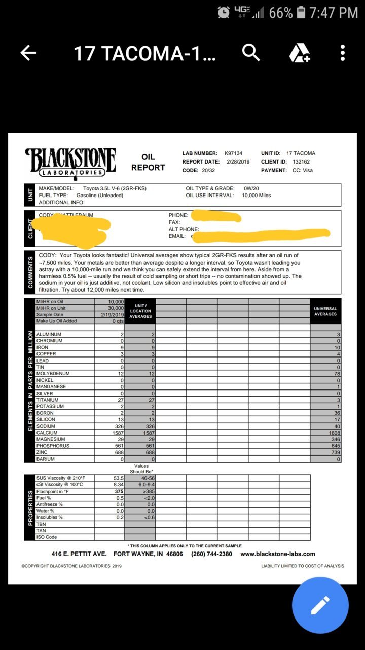

    I had my oil tested by blackstone labs. Look at my report. They say I could move to 12k if I wanted. 20190304_214205.jpg
    rlx02, HAIRYTACO, xxTacocaTxx and 3 others like this.
