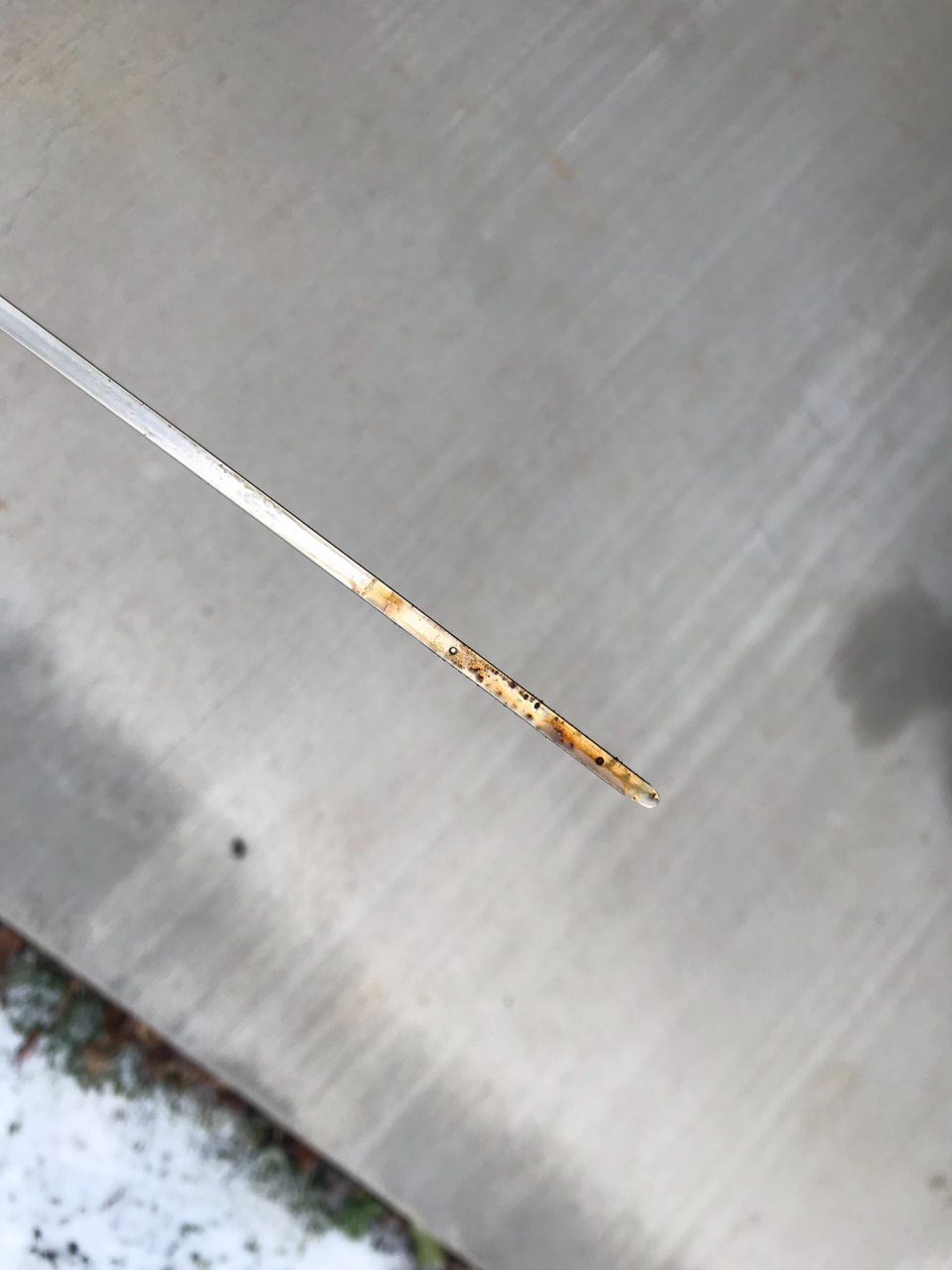

    10 k is fine but that oil looks dirty. I sharpie the filter but normally watch them because the tech is asking so many questions.

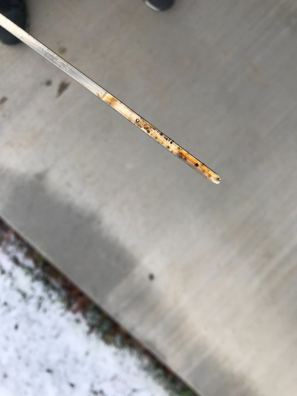

    I think there is something else going on. If they didn't change the oil it would be darker, but not.. "clumpy" There is literally a chunk of something on the edge. I've seen some dirty oil, but nothing like that. I would definitely get it tested. I don't know if its condensation or some other contaminant.

    Yup. I too think it's a symptom of something else.

    Perhaps the barrel they keep the oil in has this stuff in it.... wonder if it’s metal or...
