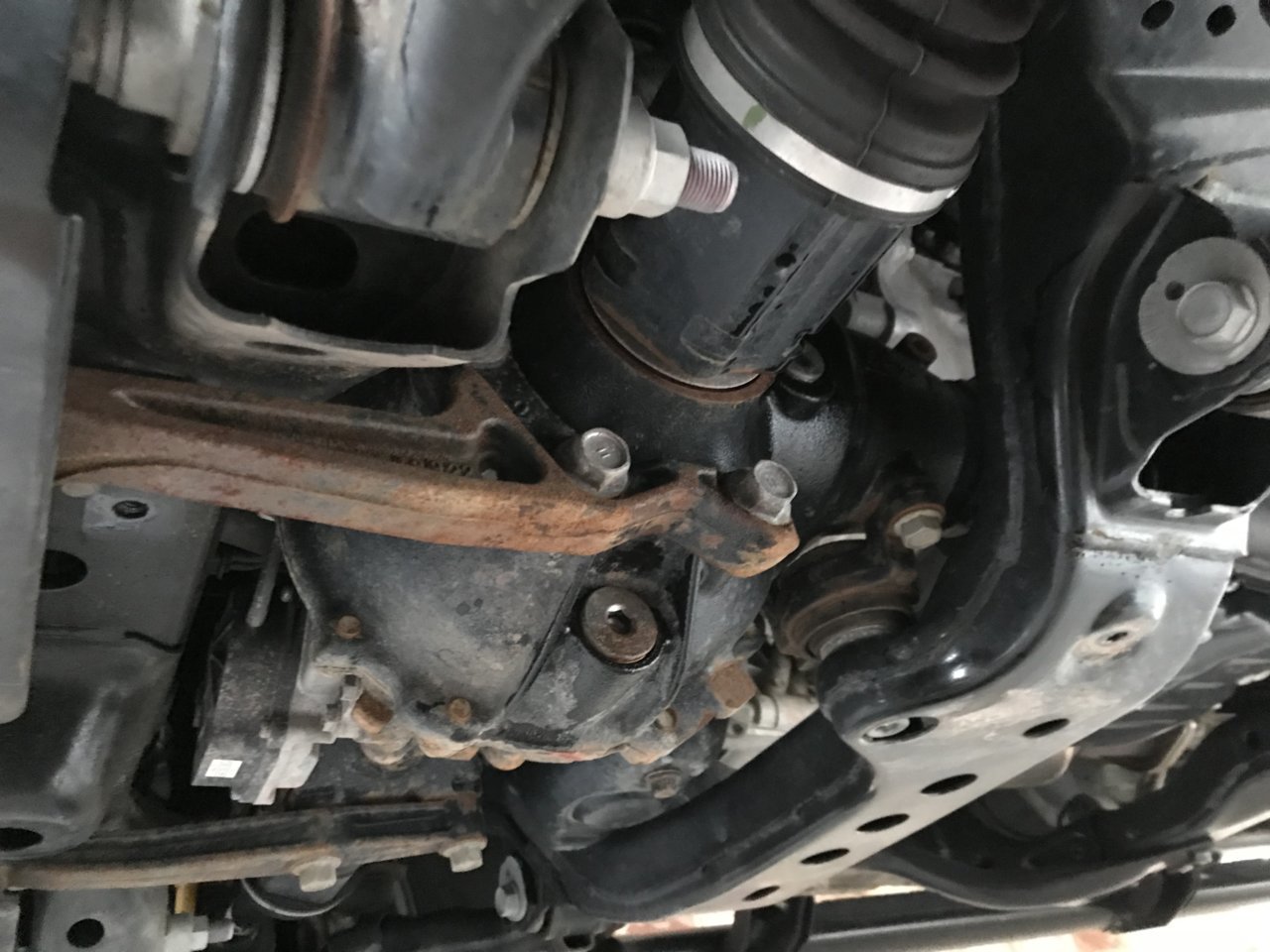

    133
    I noticed the rust near the front differential when I was changing differential fluid. Probably because I drove across 2 ft deep creeks a few time before and didn’t rinse the bottom. Should I worry about it and treat the rust with something?
