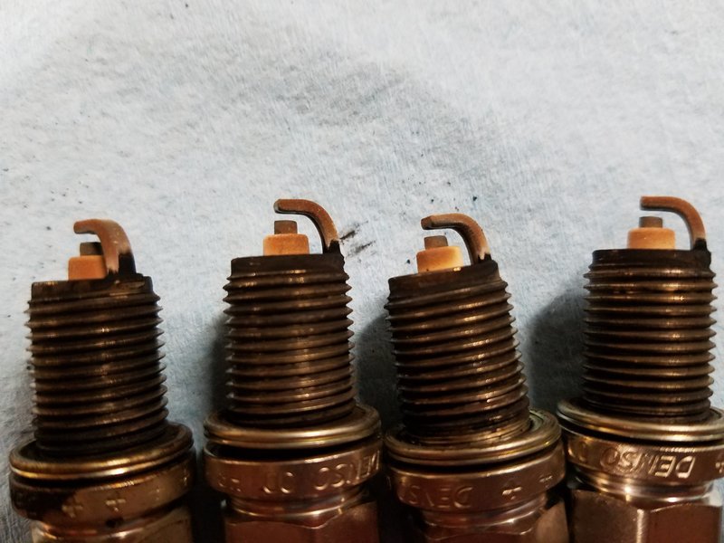

    Sounds like you have a couple problems, I would try to isolate them and deal with the easiest/most obvious one first.
    Determine if you have an exhaust leak at the manifold. If you do, fix it. See if anything changes. A leak may be caused by a failed gasket, along with a broken or loose header stud that is rattling.
    If it is burning oil, look at the spark plugs, if any of them have oil on them or are coated with heavy residue, you may have excessive blow-by. Do a compression check, should confirm this suspicion.

    Edge insight, doesn't do much for the older style cause of the ecus but it's great cause I can look at other stuff and like corrected speed for having larger than stock tires and what the stock dash can't offer. You can buy different models of the edge for like newer vehicles with more advanced ecus and can like add tunes and such. It has like 0-60 and quarter mile timers and can read trouble codes on the fly which is mostly what I bought it for but they aren't cheap but like mine the insight will read so many different types of vehicle http://edgeproducts.com
    I will definitely check my plugs again. Here is a picture of the old plugs I had in the truck no more than 2-3 couple months ago. It's weird cause I would get this rattle sometimes from my exhaust and I have had to tighten bolts from time to time around the cat and after the muffle ( it's a lce header exhaust and hi flow cat ) btw today it sounded like my cat was rattling from inside
