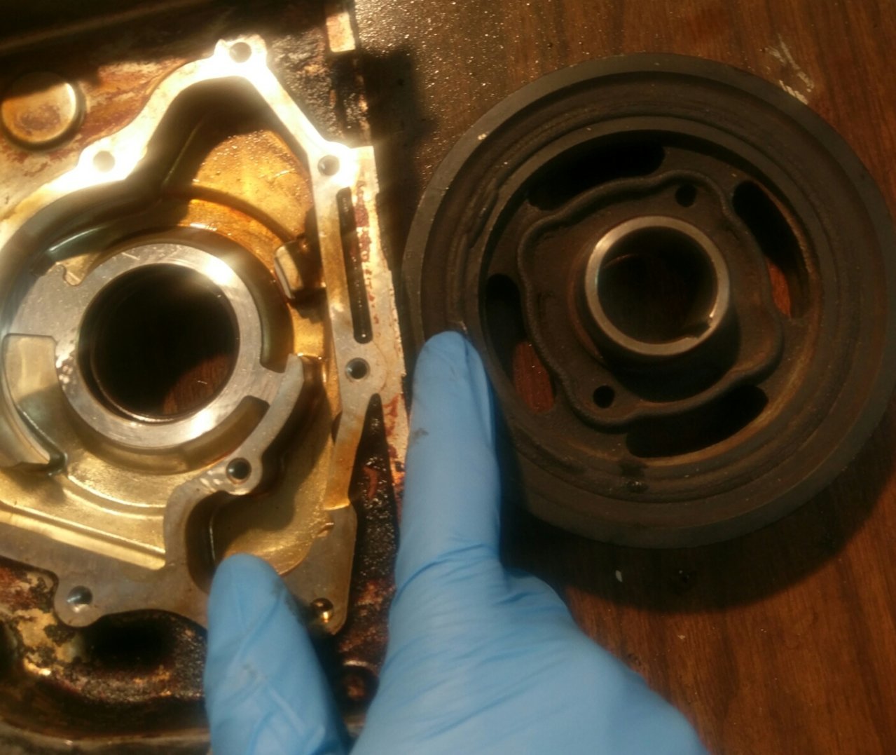

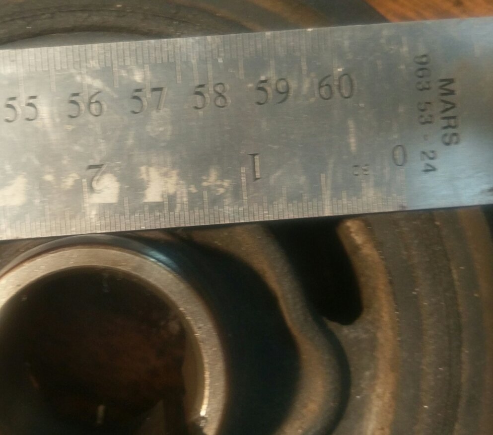

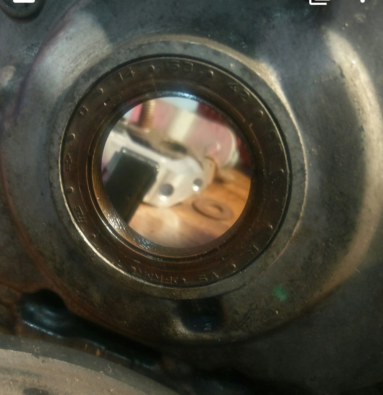

    Was about to go to bed, but this has me perplexed, so headed out back to the shop.
    For some perspective, here are some pics.
    First Pic is of an average timing cover for 100k mile 1GR-FE. in comparison, OP's looks like it hasn't been taken care of.
    Second pic is showing an inside view of timing cover and harmonic balanced.
    Third pic shows that the separation between the inner and outer is at about roughly 2" on center. Even after separation, I don't see how those gashes happened.
    I know this doesn't make sense, but looking at the poor shape of the gasket and damage, almost looks like the crank moved???
  12. May 7, 2019 at 12:13 AM
    #72
    Jimmyh
    Jimmyh Well-Known Member
    May 16, 2012
    #78991
    14,281
    SC
    2012 Prerunner SR5
    I smell fish. This doesn't add up.
    I don't see how the harmonic balance wheel did this it is too close to the seal IMO. Not trying to say that this did happen, but it looks like while attempting to remove the seal with a screwdriver and hammer they missed the mark and popped the old aluminum.
    Running Board Man and adamant365 like this.
  13. May 7, 2019 at 2:22 AM
    #73
    682bear
    682bear Well-Known Member
    May 1, 2018
    #252192
    142
    West GA
    2006 SR5 DC and 2015 TRD OR DC
    Or maybe trying to pry the balancer off with a prybar?
    Idk... just guessing...
    -Bear
  14. May 7, 2019 at 2:26 AM
    #74
    682bear
    May 1, 2018
    #252192
    142
    West GA
    Maybe a piece of gravel somehow got behind the balancer... wedged in... when the engine was cranked, it grabbed on the back of the balancer and was pushed through the cover?
    Just spitballing ideas...
    -Bear
    Running Board Man likes this.
  15. May 7, 2019 at 4:27 AM
    #75
    Torspd
    Torspd Tor-nication
    Sep 18, 2009
    #22958
    26,453
    Tor
    The Great America!
    MMVI 4.4L 4x4 Access Cab
    Torspd Custom Turbo kit [] Borg Warner 9180EFR Turbo [] Haltech Elite 2500 [] TiAL Q BOV [] TiAL V44 Wastegate @ 15psi [] CP Pistons [] CP Carrillo Rods [] ARP Head studs [] ARP Main Studs [] ARP Header - Head Studs [] Ported Heads w/ 1mm oversized valves intake/exhaust [] Brian Crower Forged Stroker Crank [] Darton M.I.D. Sleeved Block [] Kelford Camshafts [] Torspd 160* T-stat mod [] APR Large Fuel Rail [] Walbro 460 LPH E85 Fuel Pump [] FueLab FPR [] APR T56 Conversion Kit [] KP RACING Built T56 [] McLeod Racing Custom Twin Disk Clutch [] One Piece Aluminum Driveshaft [] MGW Shifter [] Custom lowering kit [] Ohlins Front Coilovers [] QA1rear shocks [] Custom Ron Davis Radiator [] Dual SPAL Electric Fans []
    That hole looks like it was punched inward.

  17. May 7, 2019 at 4:40 AM
    #77
    98tacoma27
    98tacoma27 is going full "SANDWICH" Moderator
    Dec 18, 2008
    #11714
    67,858
    Ben
    Not Beech Creek
    05 Tundra SR5 (+295k AND COUNTING), 2006 F350 King Ranch 6.0L
    Some stuff. Not a lot, just some.
  18. May 7, 2019 at 5:05 AM
    #78
    TheDevilYouLove
    TheDevilYouLove You can’t polish a turd, but you can polish a TRD
    May 26, 2016
    #187953
    2,886
    Steve
    Marylandistan
    2010 Tacoma TRD Sport Access cab 4x4 silver streak
    The lack of emissions BS on a pre-2012 makes them more expensive?
    Crodell6 and EatSleepTacos like this.
  19. May 7, 2019 at 5:40 AM
    #79
    adamant365
    adamant365 Well-Known Member
    Sep 24, 2012
    #87614
    168
    Adam
    Kentucky
    '09 SR5, DCSB, 4x4
    It almost looks like there's a couple tool marks at the bottom right portion of the hole. And also what looks like a scratch at the center/bottom left as well.
    Not saying that happened either, but if a downward (inward) force was applied on the cover at the bottom of the hole, it would pop that part down (in) and the top part up (out). The crack pattern on the hole would match those forces.
    I'm certainly no expert and would need input from OP. It is very curious indeed.

  20. May 7, 2019 at 7:21 AM
    #80
    HillBillyRedNeck
    HillBillyRedNeck [OP] Well-Known Member
    Feb 6, 2013
    #96974
    88
    JOSH
    Arlington, Wa
    2010 Tacoma SR5
    cheap spacer lift for now
    I think a rock got wedged in between the balancer and the timing cover. I don't think I'm going to swap it, I'm going to buy a new cover and do the timing chain at the same time. My pickup has been sitting for the last two years while i was stationed in Virginia. I just got out and moved back home and started driving it again. I removed the balancer by putting a breaker bar on it then using the starter to break it loose, then it just wiggled right off the shaft.
