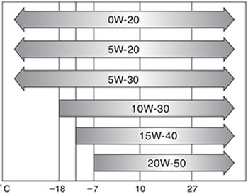

    Toyota 2TR-FE Recommended Oil:
    65 °F = 18.3 °C, so you can use 0W-20, 5W-20, 5W-30, 10W-30, 15W-40, or 20W-50.
    Jeff
