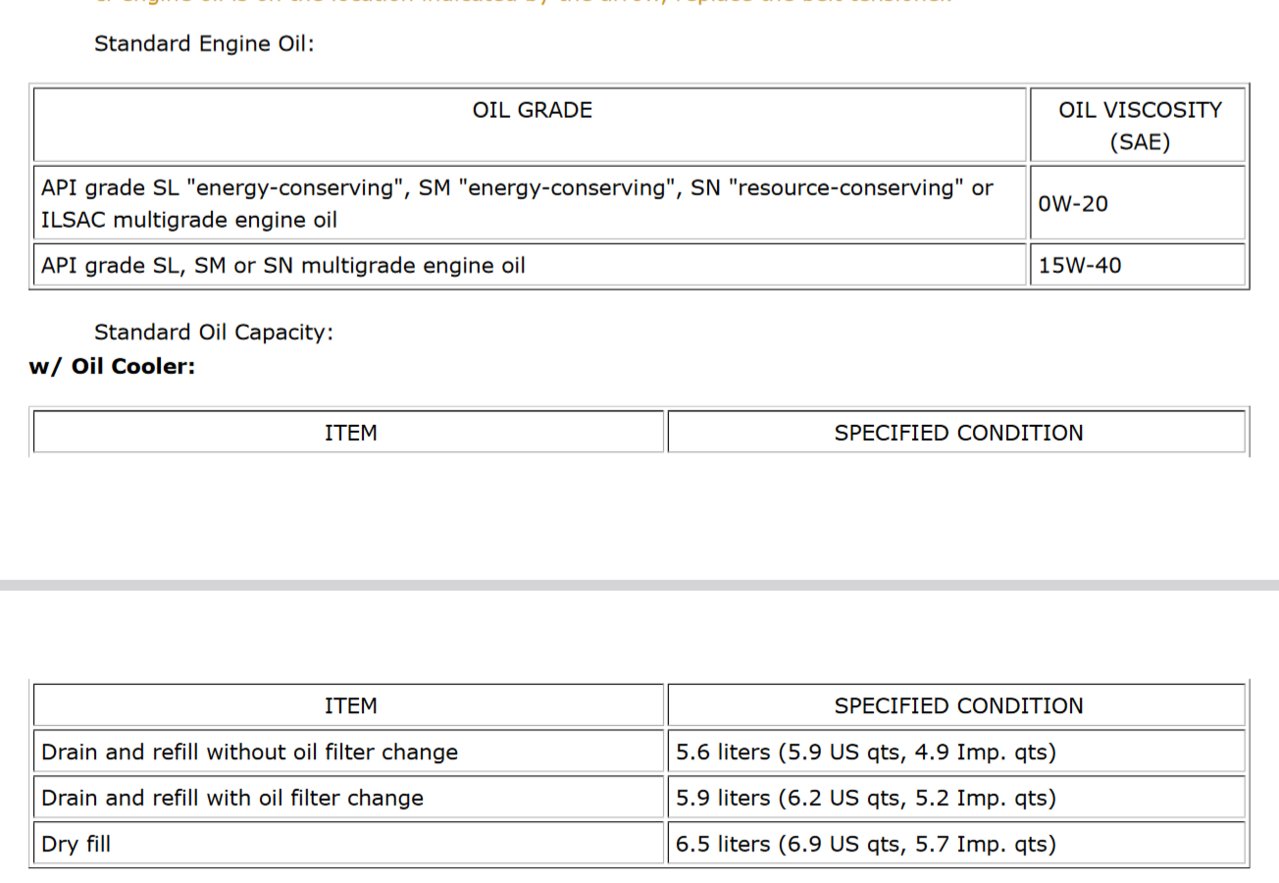

    Was looking for something else in the service manual last night and noticed this while crtl+Fin
    cryptolime[QUOTED] likes this.

    i saw that too. weird how they go from 0w-20 to 15w-40. nothing in-between. wish they went into more detail on that.

    They only list the 0W-20, but 0W-20, 5W-20, 5W-30, 10W-30 all fit in the upper left box description. So that’s why. 15W-40 is officially not in the “energy-conserving” category so it’s in its own line. Those 5 viscosities are the ones in the Mexico manual which are the 5 supported oils for the 2GR.
