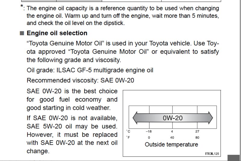

    Yes is probably is buried in the manual just like the Corolla but it doesn't say anything about just changing from the recommended viscosity for ever and ever. It says it is allowable if the recommended oil is not available but at the next oil change it should be replaced with the recommended viscosity oil

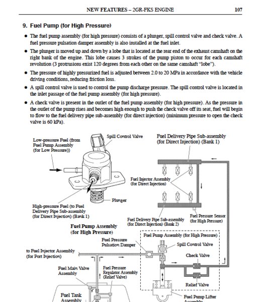

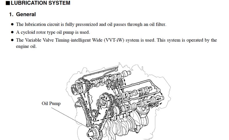

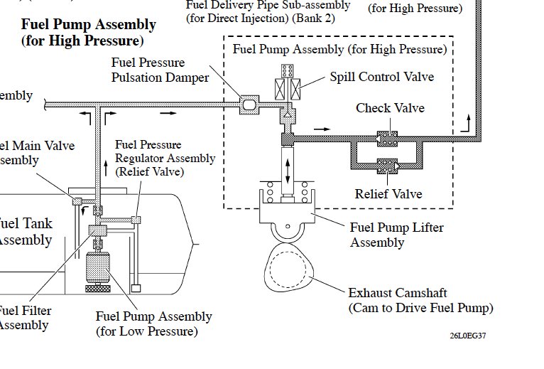

    Do you know if the Toyota pump uses a roller or plunger piece that contacts the cam lobe? If it is a roller design I wouldn't think that oil viscosity would be as critical to that part of the system, but I may be wrong.
  15. Aug 16, 2016 at 10:58 AM
    #55
    The hammer
    The hammer Who’s the Wrench?
    Mar 7, 2016
    #180475
    3,880
    '16 Tacoma SR5 4X4 DCLB TSS Pkg 17X8" BSW-Cooper DIscoverer AT3 4s P265/65/17
    Underworld Flex trifold, tinted, TRDPRO grill, TRDPRO shift knob, etc,etc
    It’s roller (see engine image) type I believe. And they appear to be concerned about the breakdown of regular oil and the build up of the sludge as it breaks down.
    Also unlike synthetic oil which doesn’t breakdown at anywhere near that rate its a safer bet to protect that very expensive cam driven high pressure fuel pump. I would never anticipate that problem because I'm anal about maintenance lolo!
    Hope that helps
    Cheers!
