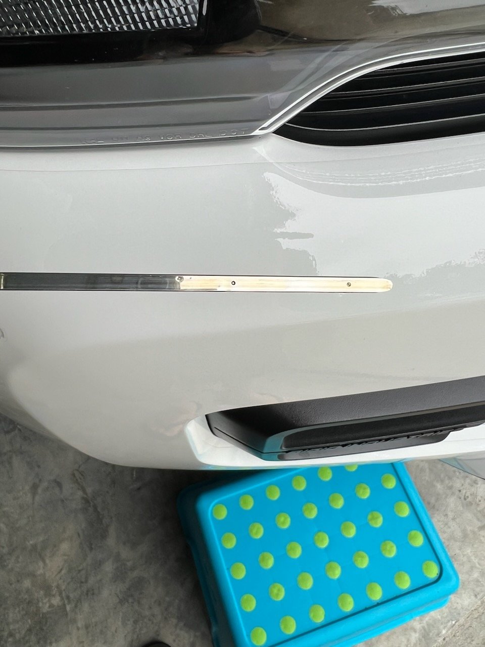

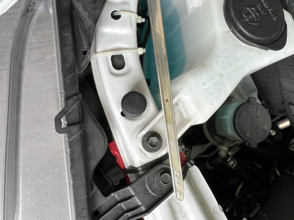

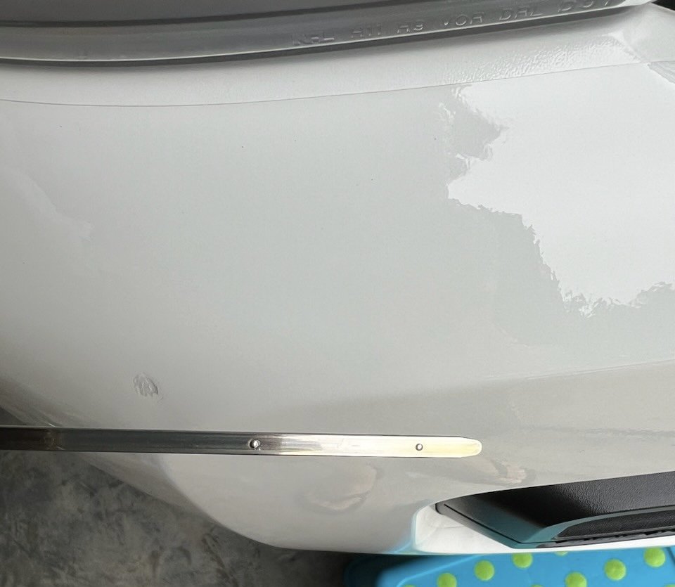

    This is my stick. Do you read the dip dot or raised dot?

    I keep my oil level near the higher dot. Pull the dipstick out after the truck has sat for awhile and look at the level before swiping. I then, swipe the dipstick and recheck. The second time is harder to read. Others have said you can rough the dipstick with sandpaper, but my way is fine for me.
    I check my level frequently after an oil change and also look for drips under the truck. Otherwise, I check the oil level once per month as my oil level does not move between oil changes.

    When oil is full it should read between the dots.

    so early morning is a good time to check? You can only check the stick max of two times in a row? Maybe thats why mine is streaking. Tnx

    I check my oil anytime of the day when the engine has been off for a couple of hours. When you first pull the dipstick out without wiping, there is no streaking. Every additional wipe and check has streaking for me. I could call it good after that first check but I am a little OCD and always double check everything on my truck.

    Check both sides of the dipstick to be sure they are close to the same.

    No, it is either half empty or half full. :p
    Actually between the dots means it's adequate.
