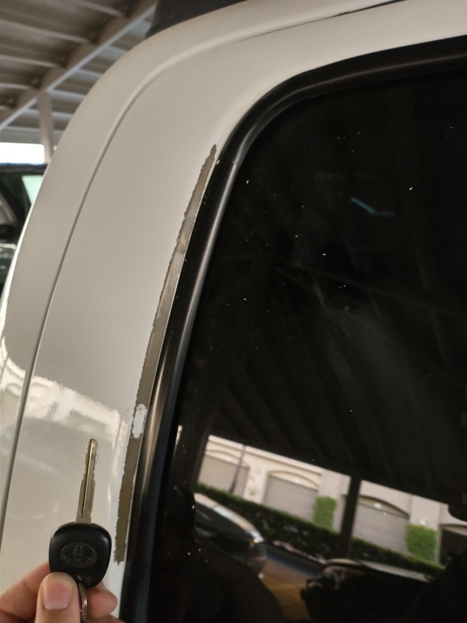

    So on my 07' Super White Tacoma I have the paint flaking off on the inside edge of the door.
    I did buy a can of Dupli-Color and have experimented on a scrap body part before even considering trying it on my truck - not sure yet if I will attempt to go this route
    Did you fix it on your own and if so how - did it turn out well?IMG_1466[1].jpg

    My son's white Tacoma is doing that all over. It also started in the door frames. Nothing you can do short of repainting.

    That area is not so visible after closing the doors so I would just use touch up and call it a day.

    What did Toyota say about it? That is obviously inferior preparation prior to painting.

    There are several threads about Tacomas having this issue both 2nd and 3rd gens. The newer trucks Toyota seems to be fixing but mine is now 14yrs old and I have had it since it was new and everytime I look at it - being disappointed would be a major understatement.
    I am currently on the fence about if I want to keep it and get the door repainted at a body shop or just get rid of it for a new truck.
    With many members having a problem I wanted to know what worked for them (DIY) if it did

    I used the duplicolor spray cans to redo my truck. Did the roof, hood and cleared the doors, you can tell as its not as glossy but its been a year and its still holding up.
    I might redo the clear and actually polish it this time to try and blend it in some but on a truck I beat on off roading and hunting, its hard for me to get motivated to redo it just because its not perfect.

    Its easier to fix the clear than the actual paint. If its just the clear coming off making it look faded (white residue) just knock that out now before the paint gets really bad. That was my mistake, put it off for too long and it was 4 times the work but yeah the paint is horrible on these trucks. Remindes me of the 90's GM paint but that stuff just peeled off in chunks down to the metal.

    I understand why you said this, but let me assure you that the water borne paint is just as good, if not better than solvent based.
    As referenced above GM had major issues in the 90's long before water based was being utilized. The problem that the majority of 040 (super white) owners are experiencing is simply delamination where the base, and subsequent clear coats fail to bond with the sealer.
    My recommendation is to have the panels stripped and refinished. This, for a plethora of reasons isn't viable for most of us. I would say that getting 'something' done whatever that may be for each individual is very important to do as soon as feasibly possible as the sealer that becomes exposed has no UV protection. Rattle can, touch- up, wrap, whatever suits your case. Just do it as soon as possible to avoid complete failure.

    As for what I did, I went back to the used car lot I bought my truck from and kept bugging them (politely but repeatedly) and they eventually caved in and painted the 2 door/window sills with flaking paint. For new instances of flaking paint I do a light sanding, clean it really well and put several layers of touch up paint. Light sand again and buff to desired finish.
