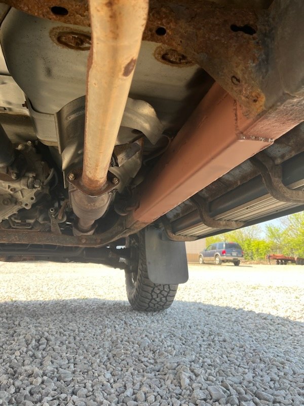

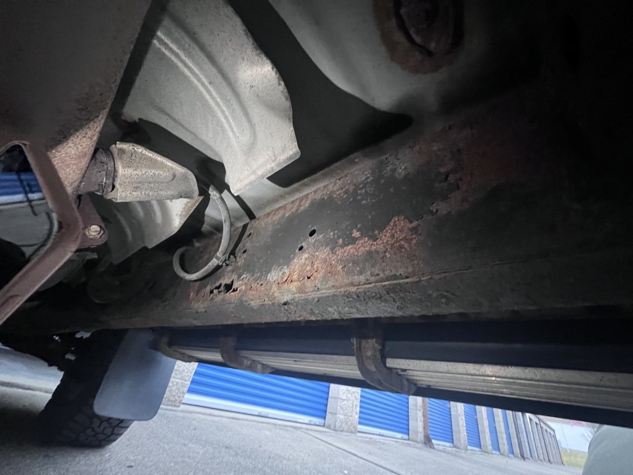

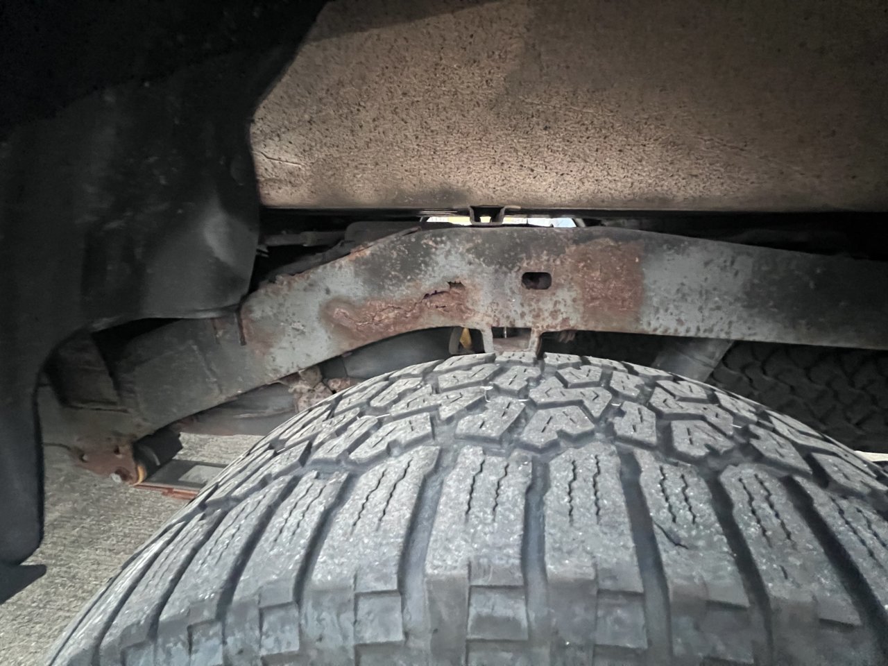

    Saf-t caps? What's the best plates to buy to get welded on the frame?

    That might be worse than it looks, I’d hit it with a hammer to see how bad the rust is in that area

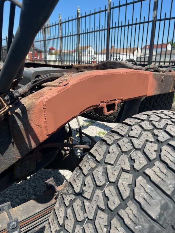

    I had similar rust like like this I can post pictures of and I had a local welding shop clean and weld some plates on. Am in talks with them about just building a new frame completely.

    Just a couple before and after spots.

    nice! that looks like the first repairs done to mine. which now has layers over the layers.
    for the OP: yeah that would be an easy fix if it passes the hammer test. grind it out, weld it up & then plate over it.
    you can tell the type of people we are by whether we use some flat plate, angle iron or buy the fancy patch sections.
