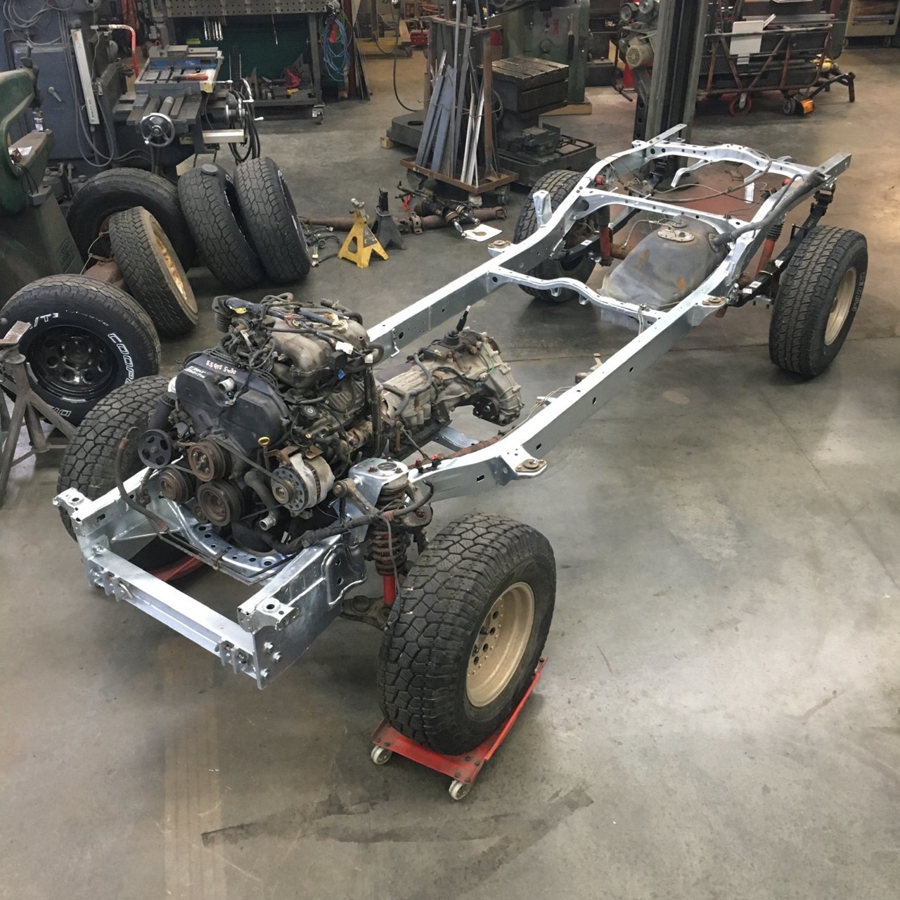

    Absolutely; I was not denying that. I was suggesting there's a better way to protect your new frame from corrosion than to cut the lower half of it off.

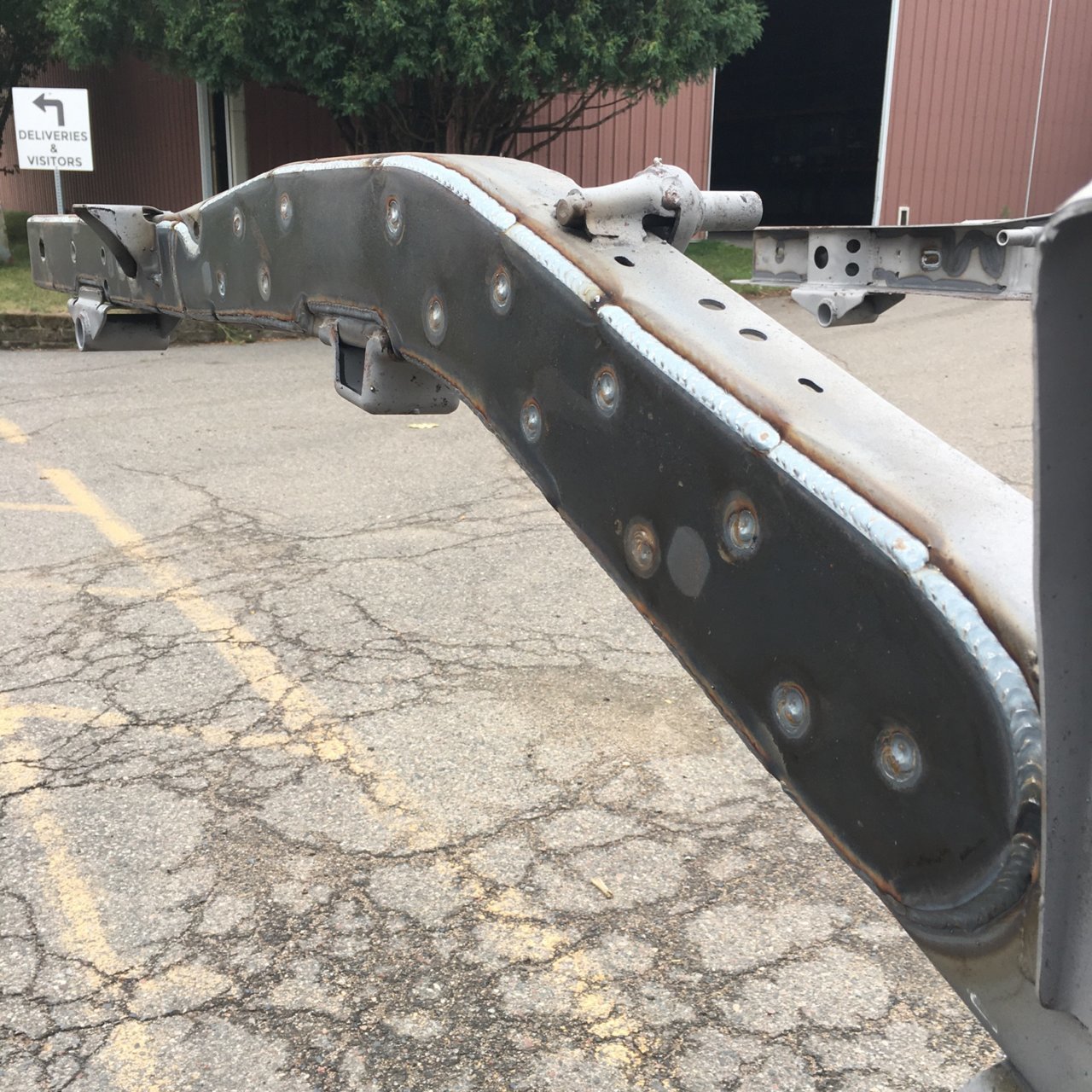

    300
    03 Taco TRD
    ColinD=== dude THAT is a plate job! friggin wow!!
    if you did both sides of the truck? did you ad about 150lbs to the back end? that aint going nowhere.

    Yeah, both rails plated with 3/16". Keep in mind, you need to sleeve and widen your receiver hitch by 3/8" if you go all the way to the back like I did.

    For the time being, I'd drill a hole at the end of the crack to stop it from spreading further. 1/4" or so
