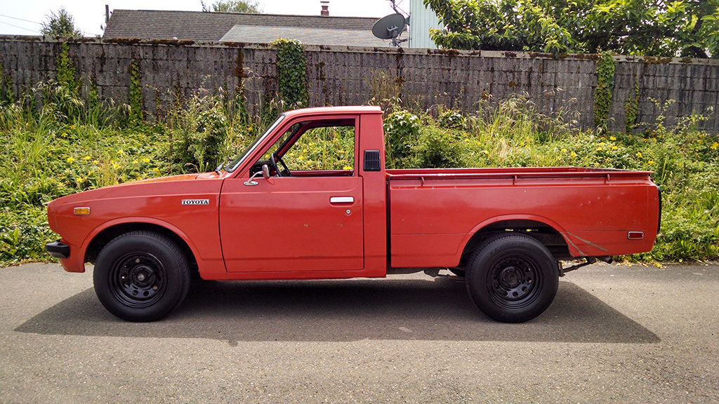

    Hahaha I wish... Didn't have cell phones or digital pics back then... It was sweet though, MT of course, had a hard shell cover for the tools, lasted forever. Picture this but in that Toyota dark blue.
