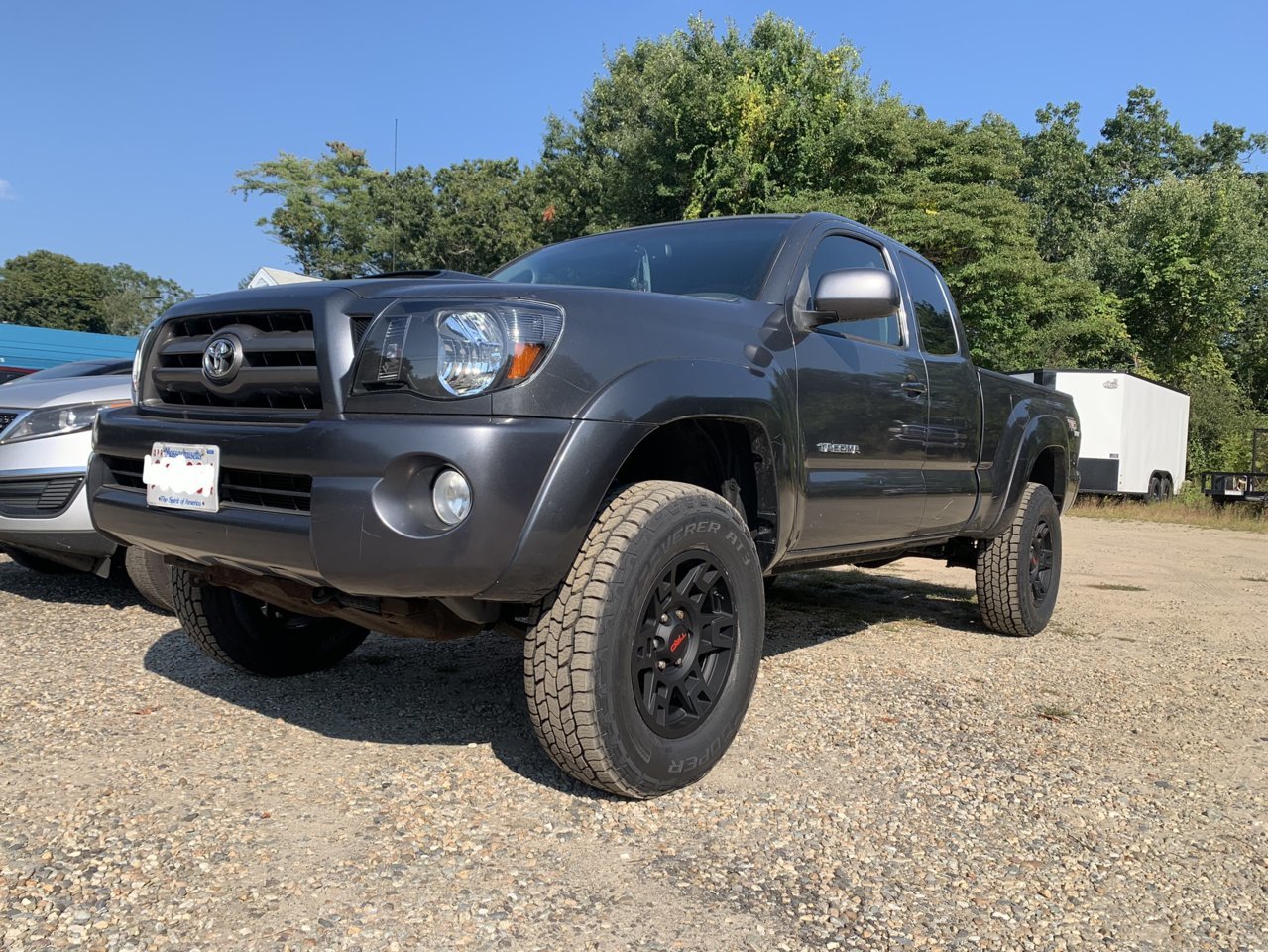

    Thanks!! I really appreciate the response. Have a good one

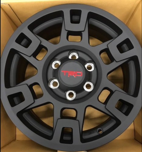

    Yes, they are the 4Runner SEMA wheels, and you’re correct… 17x7 & +4mm offset. IIRC, the wheels say “Japan” on them.

    Does your truck have rear drum or disk brakes? I think people with rear drums are the one’s saying those rims don’t fit. Thanks

    The rims Brian2sun (older SEMA 4Runner) has are no problem on any Tacoma. The 2021 4Runner has an updated design wheel that looks similar to the older ones, but that wheel does not seat properly on Tacoma rear axle shafts. It has nothing to do with drum or disc, it has to do with the hub pilot on the rear Tacoma axle shafts being too deep and bottoms out on the 2021 4R wheels.
    the fix for that, if desired, is to put a chamfer on the axleshafts, or bore the wheel bore a bit deeper.

    Pretty sure those were the new style. Pre-2021 SEMA’s should work.

    Those are not 2021+ 4Runner wheels. Those are the ones that fit a Tacoma fine. They are a lot flatter of a face.
    These are the ones that do not fit. These have a deeper dish face because of the way the lug nut area is set back from the face of the rim.

    The link didn't work, but I could see the part number in the link and googled that to make sure. The part number in the link was the older SEMA wheel, which works on all 6-lug Tacomas.

    All 3rd gen Tacos have rear drums and front discs.

    Thanks again. Plus they increased the inside wheel base from 55(stock) 3 “ to 58 “
