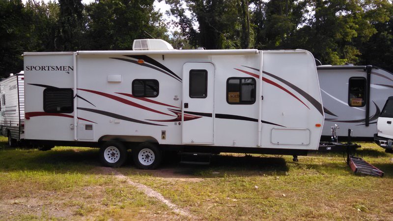

    I agree with @Lawfarin, don't forget what and who you will be hauling in the truck. you need to count all of that as the tow weight. You should be looking at anything that is an Ultra Lite Trailer, be sure to keep your tongue weight around 600#, a good WD is a must, break controller, and seeing that you are towing that far and probably a lot of weight in the truck, I would consider the Fire Stone air bags...just my 2cents.
    Here is what I tow...it's a 24', overall length is 26.5'

    Thats about the size I am looking for. Thanks for the visual.
