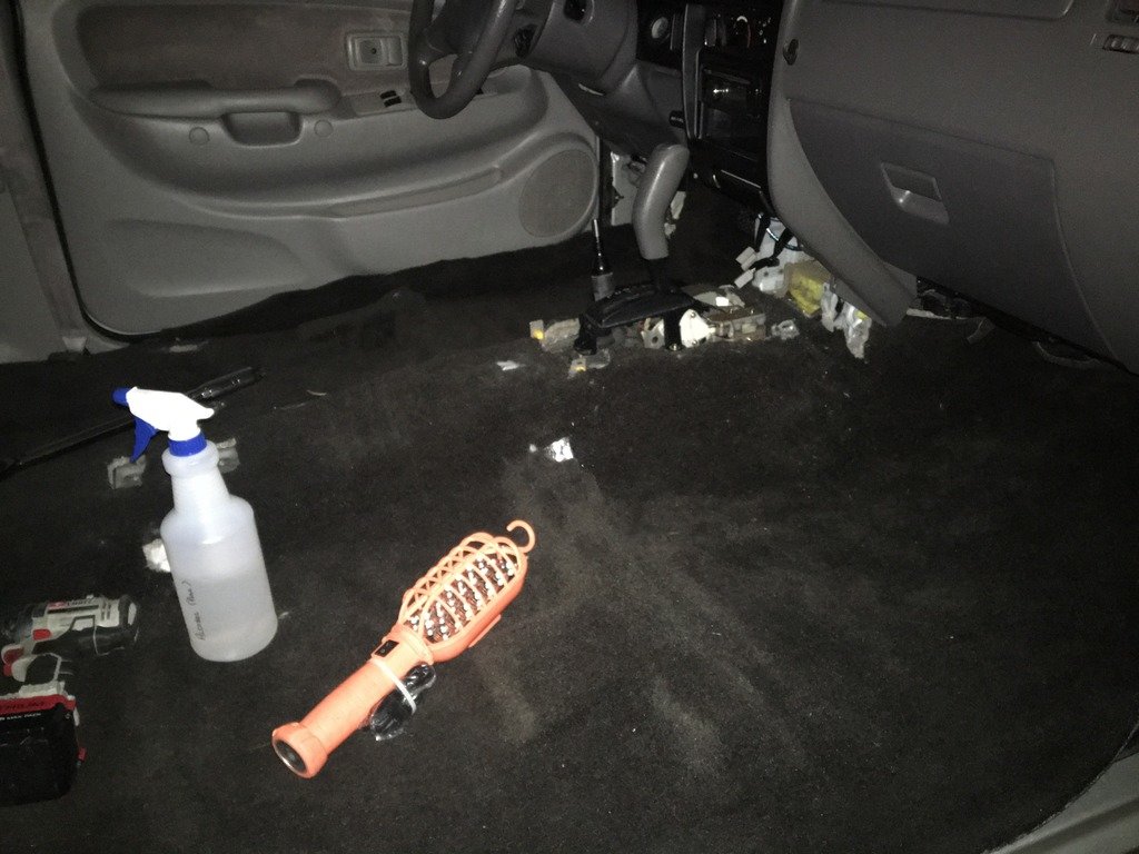

    I'll even do a step-by-step of how to remove your seat cushions so you can throw them in the washer and they'll look damn near brand new. My wife even goes "are those the same seat cushions?!?" If it made a woman do a double take, it's better than good enough for me- that's for sure.

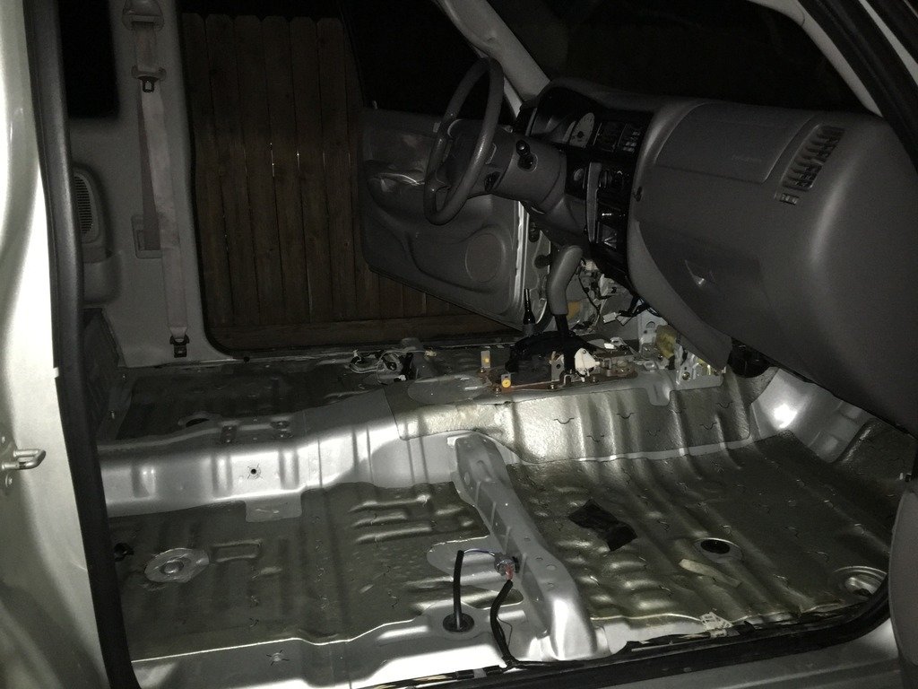

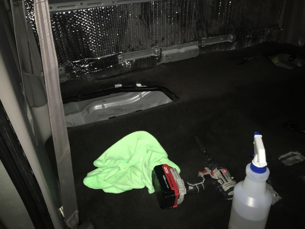

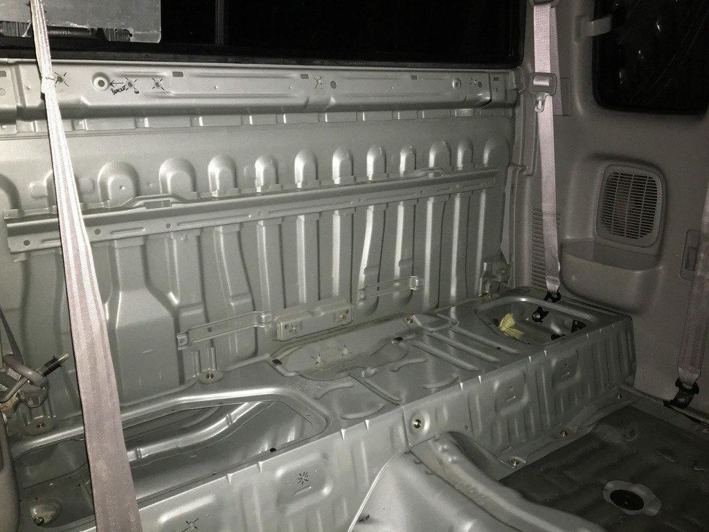

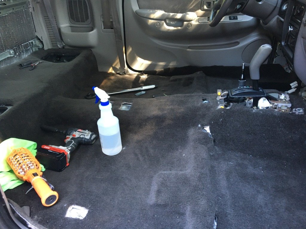

    Basically, this is what I did:

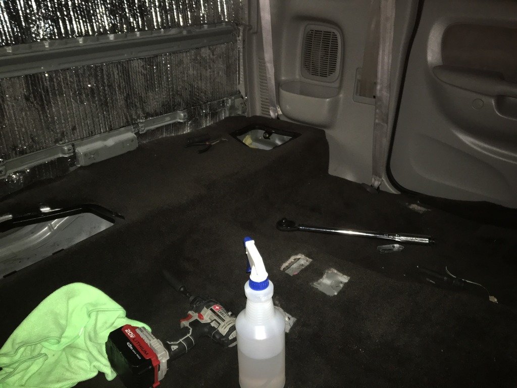

    -Ripped out "old" or "former" interior
    -Cleaned/Vacuumed/Scrubbed the interior with pure alcohol to kill/clean everything- literally everything could see I cleaned
    -Re-Insulated the entire inside as best I could with a "Frost King" type of insulation
    -Cleaned the dog :poking: out of everything inside of the interior with alcohol- including the screws so they would look nice :)
    *Also completely took off the seat covers, washed them, and put them back on
    *There was some rust on the ends of the seat brackets so I wire-brushed them and got all the rust off
    -Replaced the broken rear window latches with brand new ones
    -Took apart some of the mounting brackets on the center console, wire brushed, alcohol wiped and primed for rust prevention
    -Replaced the "cup holder tabs" in the center console
    -Installed brand new carpet on the interior
    -Got everything put back together and torqued to factory spec (minus 1 coat hook screw with didn't want to work with me) :anonymous:

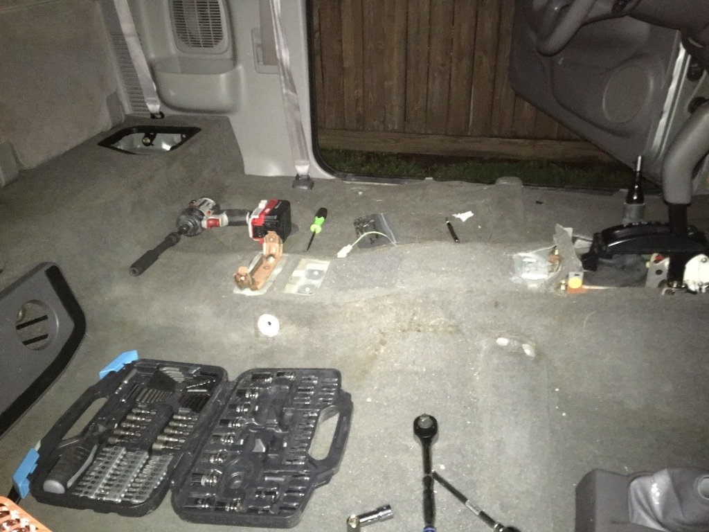

    Getting everything out of the interior isn't hard. An impact gun (my electric was perfect) did fantastic and it wasn't really a hard job at all. To get EVERYTHING from basically the steering wheel back, all you need is:
    -Impact Gun / Ratchet
    -Short 3-4" Extension
    -10mm Socket
    -14mm Socket
    -15mm Socket (I think I used it once)
    -Phillips Head Screwdriver

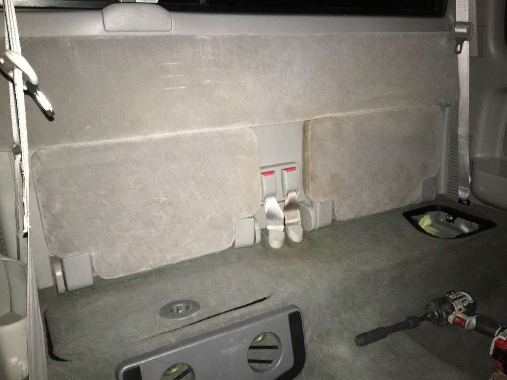

    Start in the back at the top plastic panel (first one under the sliding window), pop that off, and everything is pretty intuitive from there. It's not hard at all. Once you get that thin, long top panel off between the back rest of the jump seat and below the window (LITERALLY- just pop it off and go from there) off then just start taking everything out.
    One thing that I did that really, really helped me getting everything back inside the way it looked before it came out- as you take something out, put it further back, and put it on the side that that it goes back into. Also, for every single screw and bracket- I took ziplock sandwich bags (the skinny ones) and I labeled what it was, what side it went on to, and put it into an old box that I literally used as a screw/nut/bolt filing cabinet. As I took the bolts out, I labeled it, put it in the box and so on and so on for each piece.
    When you're ready to put everything back together- start at the back again and go in reverse. Put the brackets, seats, back panel, back rest of jump seat w/ bolts, and top panel back in. Then go to the console and start closest to the engine and work your way back, then put the seats in. It's not hard, it just takes a little time. I figured there were enough "rip out interior" write-ups on here that you didn't need me to do one for that, but that's how it goes. If you're reading this, and you're not sure where to start- read 2 paragraphs up and take a look at the BOLD. That's important. Start there and work your way forward.
    **Tip** It's much, much, much easier to get your console out with the passenger and driver seats out. They were already out when I started getting the console out, but I would at least take the passenger seat out before you start- super easy.

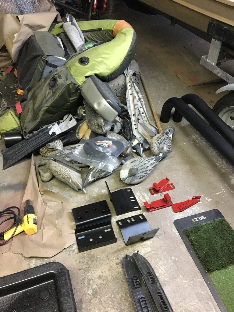

    Now. The moment you've all been waiting for! PICTURESSSSSSSS!!!!!!
    This is what it looked like before
    http://[URL=http://s1146.photobucket.com/user/RLP_USMA/media/IMG_9248_zps00fheevl.jpg.html][ATTACH=full]1621877[/ATTACH]
    You can see how ugly that seat cover was. I think it was a coke or something exploded and got all over the seat and no one ever cleaned it up. When I got it, it was like that from the PO.
    [IMG]http://[URL=http://s1146.photobucket.com/user/RLP_USMA/media/IMG_6227_zpssu4gkzh3.jpg.html][IMG]http://i1146.photobucket.com/albums/o523/RLP_USMA/IMG_6227_zpssu4gkzh3.jpg
    Also, in the above pic, you can see where you need to start when you're looking to rip the interior out.
    http://[URL=http://s1146.photobucket.com/user/RLP_USMA/media/IMG_0108_zpskhsiyrjz.jpg.html][ATTACH=full]1621909[/ATTACH]
    [ATTACH=full]1621883[/ATTACH]
    [IMG]http://[URL=http://s1146.photobucket.com/user/RLP_USMA/media/IMG_0259_zpsxjhcqnxk.jpg.html][ATTACH=full]1621883[/ATTACH]
    In the above pic, you can see where I took a Sharpie and marked off what the holes where there for and where there bolts that went into them, so if I was tired or had a brain melt down I could the whole thing back together. Also, another thing I did was take a sharpie and put a * on each location where a bolt went into so I would be able to find them easy.

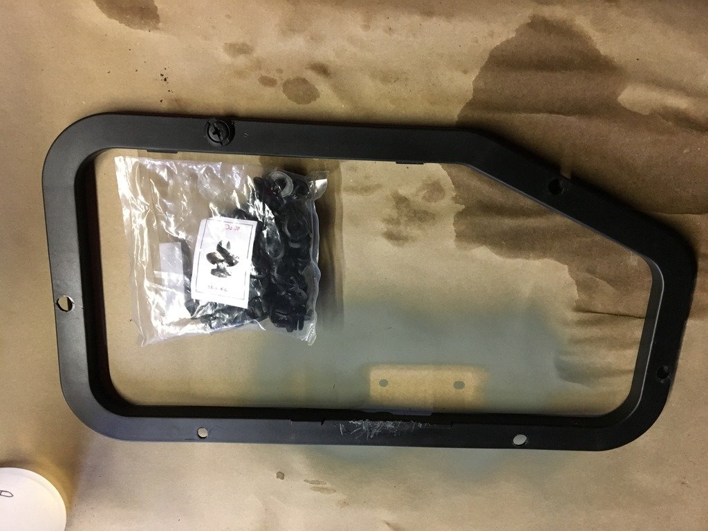

    I had to fix the one below because it is no longer available... Only the driver's side can you get from Toyota. I sanded it, cleaned it, and painted it so it would look "cleaner" along with the new one on the driver's side.
    P.S. Those things are pretty pricy for a little molding.

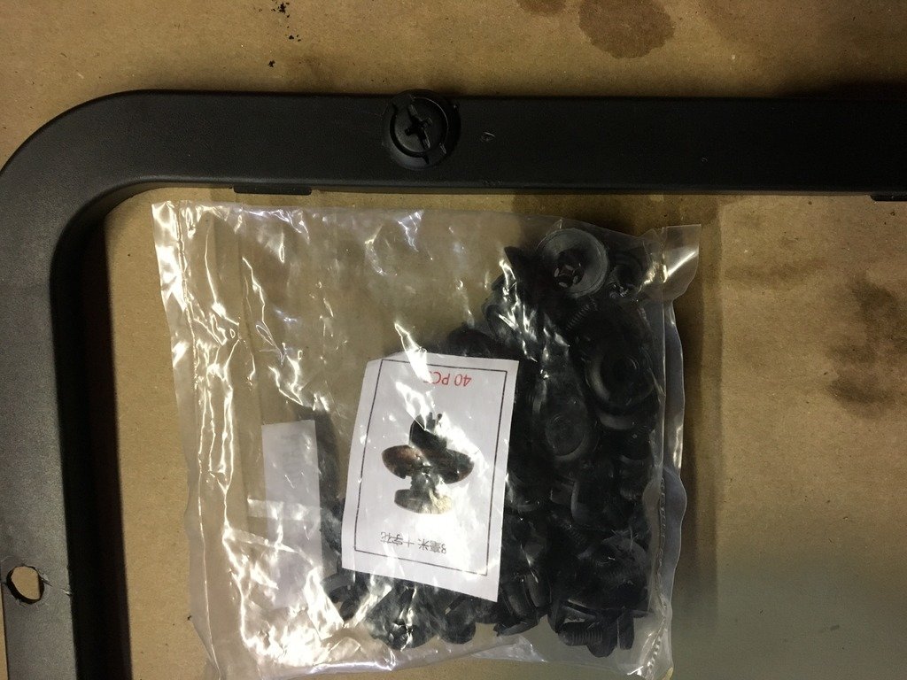

    Also, you can see the black screws I used. I don't read/speak/write Chinese, so I'll tell you that they are 8mm and they worked great. I got a bag of them for just a few $$$ on Amazon.
    http://[URL=http://s1146.photobucket.com/user/RLP_USMA/media/IMG_0165_zpsxge99kyk.jpg.html][ATTACH=full]1621923[/ATTACH]
    [ATTACH=full]1621926[/ATTACH]
    You can still get this one at Toyota... I finally broke down and got a new one for the driver's side.

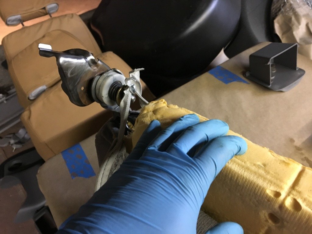

    [ATTACH=full]1621932[/ATTACH]
    As you're looking at your seat, you can see there are 2 brackets at the top, and there is 1 screw in each of those. You'll need to remove those with your phillips head screwdriver
    [IMG]http://[URL=http://s1146.photobucket.com/user/RLP_USMA/media/IMG_0734_zpsy6tt2fcs.jpg.html][ATTACH=full]1621937[/ATTACH]
    [ATTACH=full]1621943[/ATTACH]

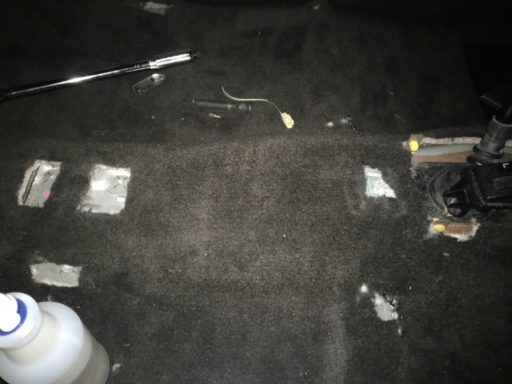

    I ordered my carpet from stockinteriors.com. It's a molded carpet, and mine is in the "charcoal" color, which is just one shade down from black. When I got it, I took it out of the box, and hung it from the rafters in my garage with rubber C-Clamps. I then took a steamer and steamed it until most of the wrinkles form the box were worked out. I also used about a whole bottle of Scotch Guard and let that sit overnight as well.

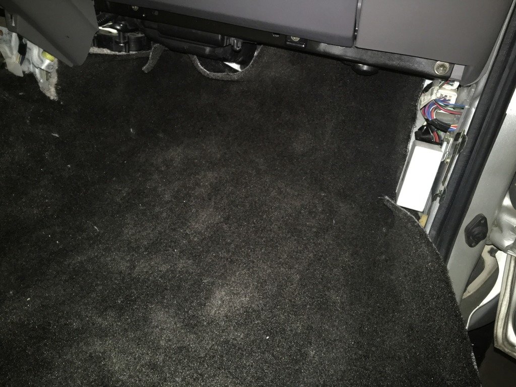

    At that point, you can see where the molding is in the carpet. I vacuumed it and got it ready for the install. I kept the old carpet to use as a basic overlay to I could see about the general area where I would need to cut, and I used a piece of chalk to outline on the new carpet. I watched the video they had on the web-site about 3 times and then started to install.
    This was a long project, and you'll go through about 5 razor blades when you do this. I don't have many pics of the install itself, but watch the video and they'll give you a good idea of how to do this.
    Here are some ***TIPS*** for the install if you want to do this:
    -I wouldn't get more than the "plush" carpet, or the basic one they offer online. They offer a super plush, and you can also order one with some type of backing on it. I wouldn't do that. The carpet they are going to give you is about 4 times- literally- thicker than the carpet in your truck now and it's going to be even that much harder to install if you get thicker and more backing.
    -When they tell you to "make small cuts" and go from there. Do it. Take your time on this and be patient. Patience is something I'm not great at, but take your time and be patient. I only had 2 sort of "screw up" cuts, but otherwise it turned out great.
    -When you're cutting the holes for the seat/seatbelt mounts in the carpet- make some small cuts and adjust. Remember, you can't get a cut back, but you can always cut more.
    -Get an entire pack of razorblades before you start this- you'll need them.
    -This carpet is much, much, much, much thicker than your stock carpet, so you'll have to work with it. Again, be patient.

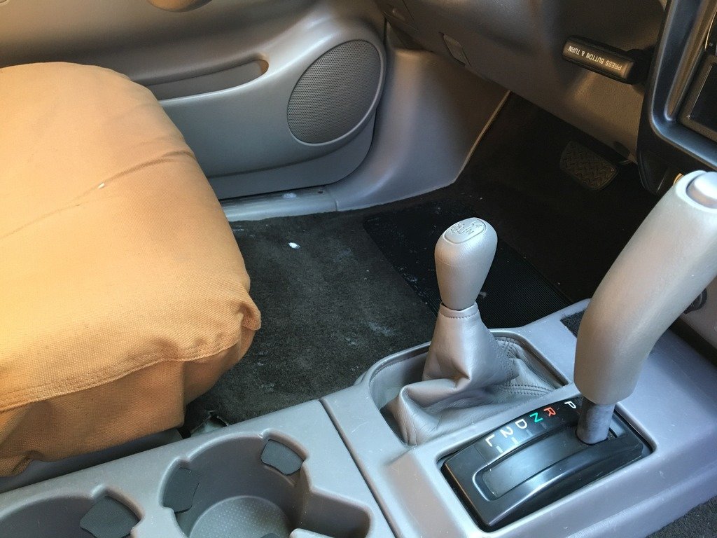

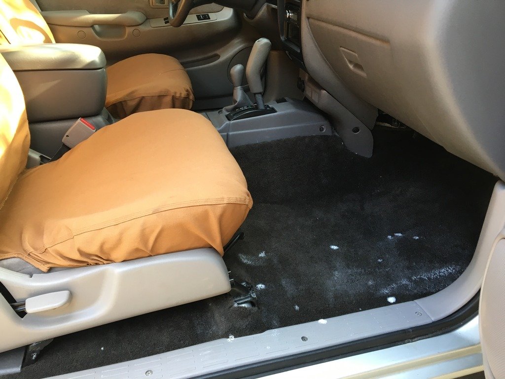

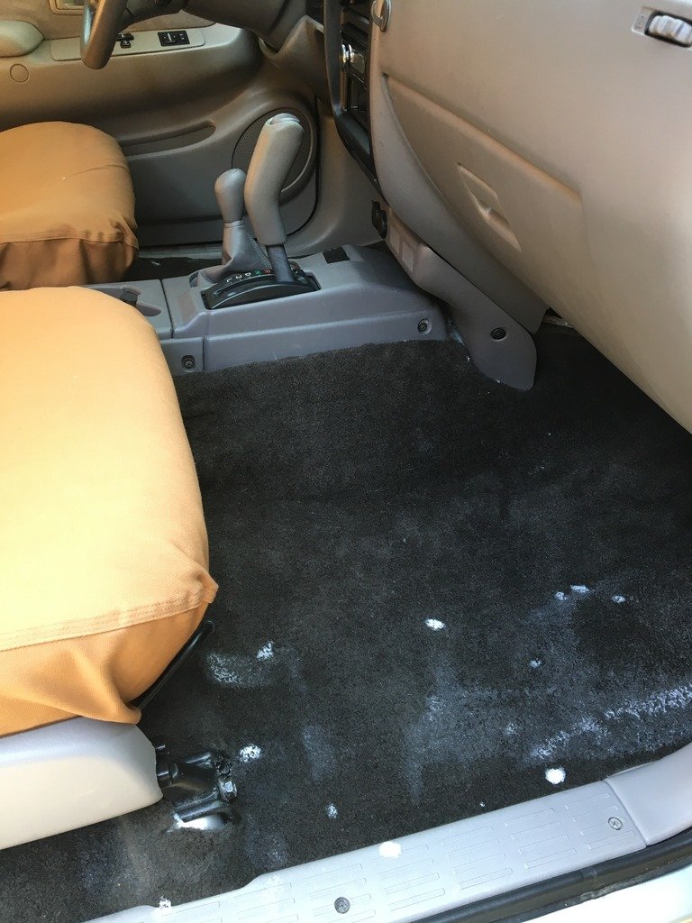

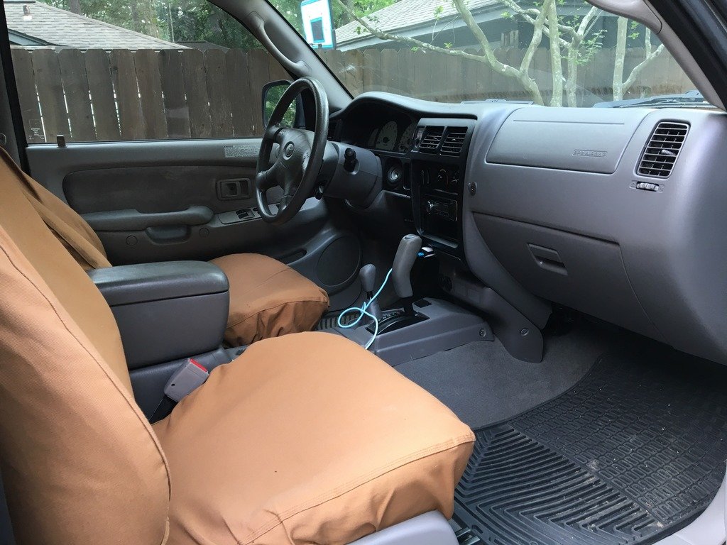

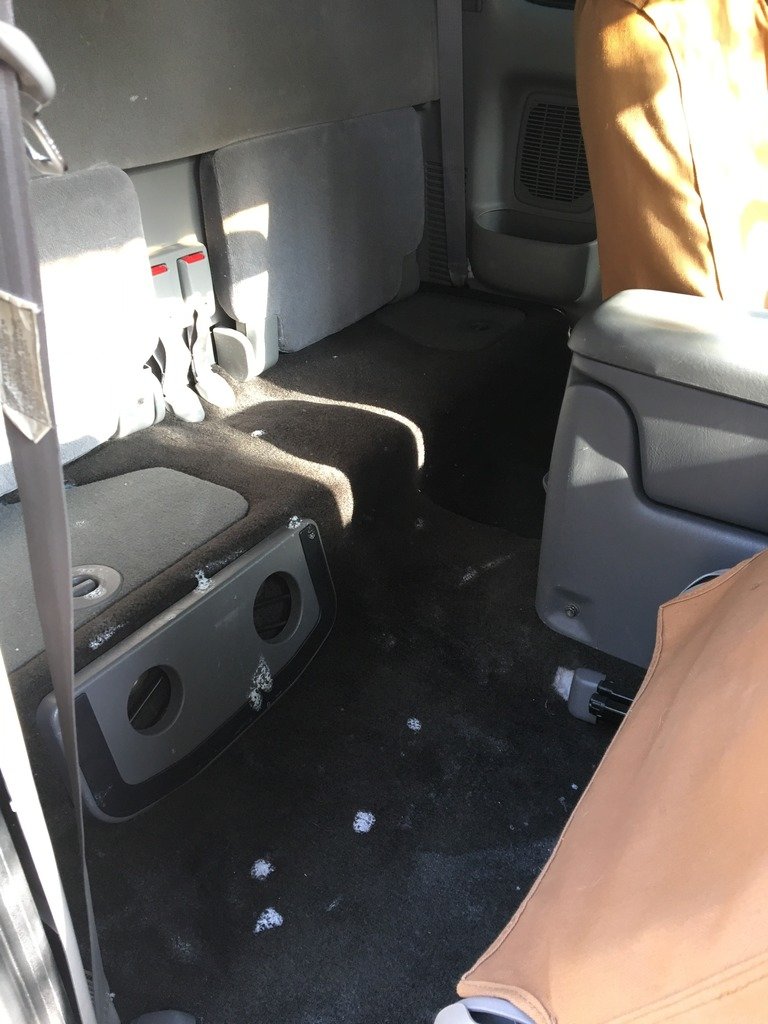

    All that being said, I'm about 95% happy with the finished product, and it's not the carpet's fault on the last 5%- it was my own fault because I've never done this before. It's a little more challenging.
    Here are some "after pics." P.S. The white spots are where I used Scotchguard 1 more time and they are drying...
    You can see on that mount where I cut it too close...
    Install Complete! With clean seat covers....
    Before:
    After:

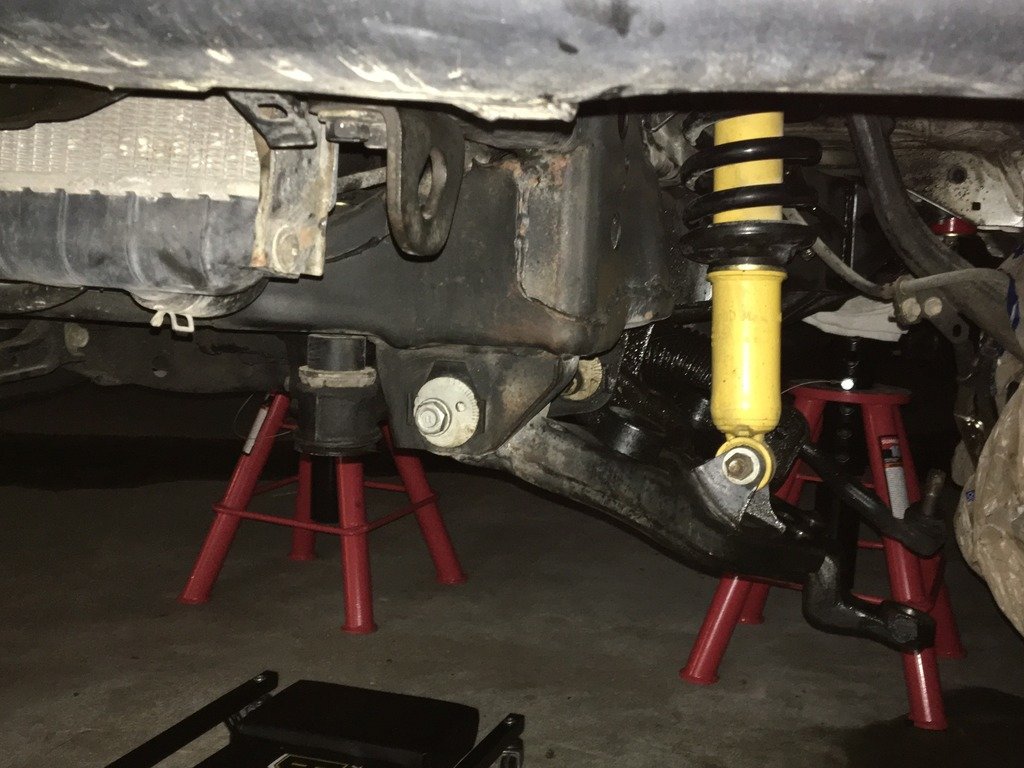

    *Finally got my jack stands (10 ton) in from Northern Tool so I'll get getting the truck lifted up and work on the front end.*
    Interior:

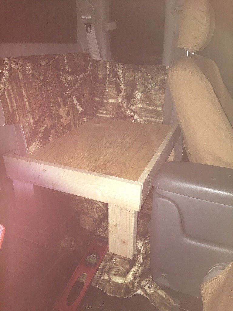

    -Install/Make a Custom Dog Hair Cover/Protector in Truck
    -Re-Make Custom Rear Dog Platform in truck
    Exterior:
    -Replace CV Axles
    -Replace Lower Ball Joints
    -Replace Anti-Sway Bar Bushings
    -Replace Steering Rack Bushings (maybe??? Probably...)
    -Paint Break Calipers (Candy Red)
    -Paint Rotors (Candy Red)
    -Install Stainless Still Braid Brake Lines (Wheelers)
    -Replace Diff Fluid (already drained for CV work)
    -Drive Truck Around for 2 Weeks
    -Replace Drum Brake Pads in Rear
    -Paint Drum in Rear (Candy Red)

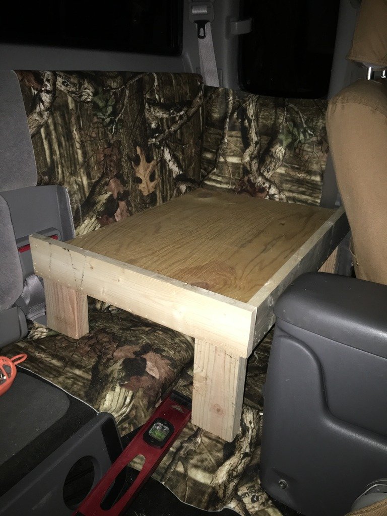

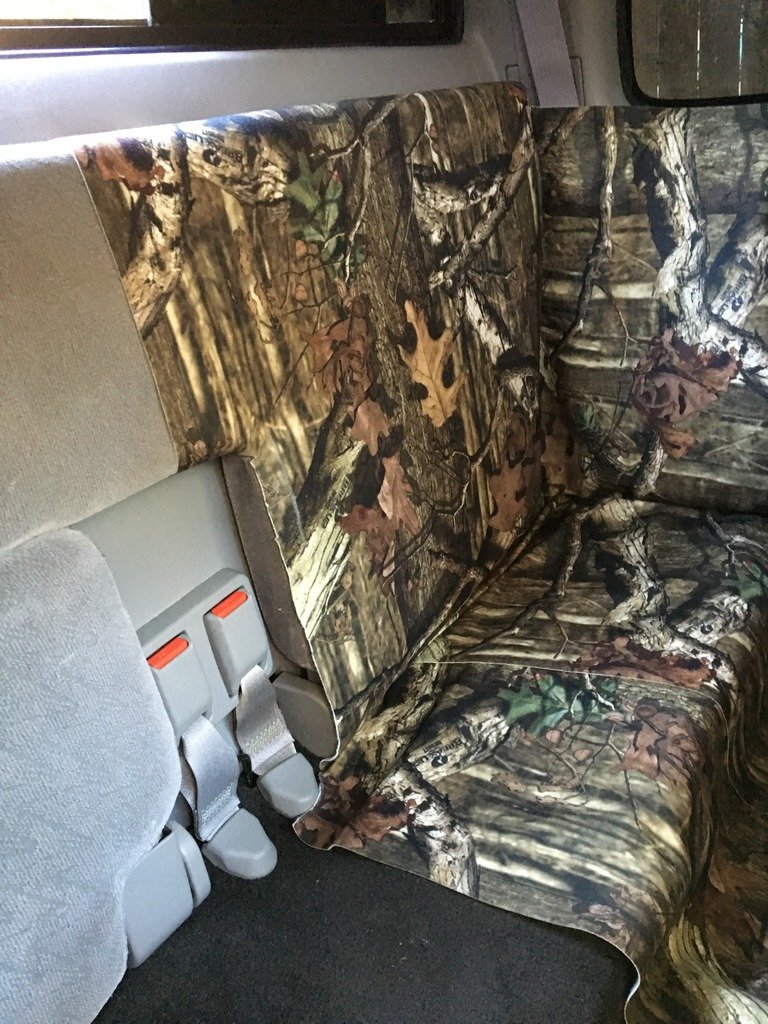

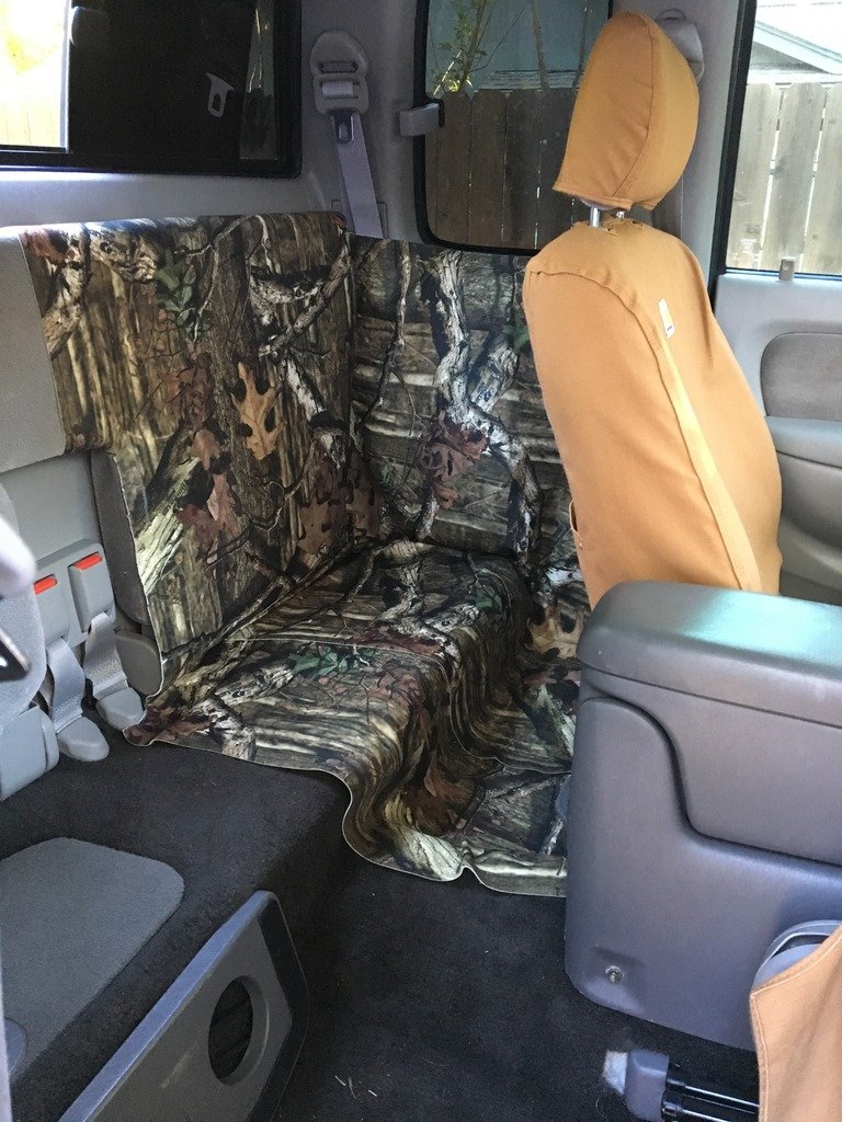

    Alright, I got the [hopefully] dog hair carpet protector installed in the inside of the cab. I used this stuff:
    http://www.academy.com/shop/pdp/mossy-oak-infinity-carpet-floor-mat
    I used some velcro strips to keep it tight/flush against the back panel. It's not "perfect" by any means and I kept it doubled up in some places along the seams to add even more protection. It doesn't look horrible, and frankly, I just care about the functionality even more than I care about the "look". It's not like this truck is going to any kind of show... It doesn't look bad, it's just not all completely seamless on the inside. I just need it to keep hair and dirt off my brand new installed carpet. Hopefully this does the trick.

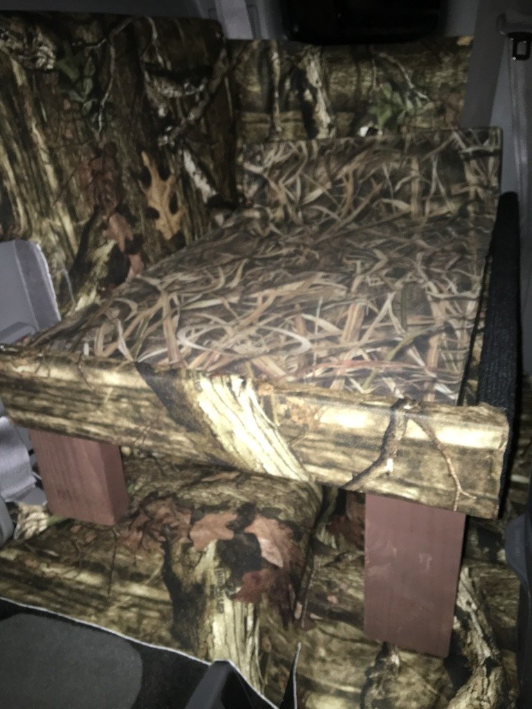

    I also got the new platform built on the inside of the truck for the dog as well. Last time I used a 1 x 4 base and thought I'd upgrade to 2 x 4's to make it a little more sturdy since I had them still from the rabbit cage I built. If you want the exact dimensions I can give them to you, but I'm really pleased and it turned out really well. It's even level! :bananadance:
    *If someone wants the dimensions, boards, sizes of everything, I'm happy to do a post on it, I just didn't want to do it all if no one cared about it or wasn't going to add it.*
    I still need to paint it and put carpet on it, but it'll be good. I have Mud River "kennel pad" that I'll use to go over it, but I think Grace (my yellow Lab) is going to like it better than her other one.
    Here are some pics of everything here:
    I'm getting the list together for all of the other stuff I need so I can see how much $$$ I'll need when we have our killer day in the market so I can go on a shopping spree??? :typing:

    Love the idea ryan, specially since u have dark carpet now and a yellow lab :D
    I also put together a nice stand for my dog. However, I made it at the same level of the seats and on both the driver and passenger side, since I have 2 dogs.
    By the way I'm really liking where you heading with this build.:thumbsup:

    I really appreciate it. It was pretty cheap and saved me a trip from having to go the fabric store to find something else... :eek:
    You really will only see part of it because it'll be covered by the stand. I'm about to get out and get it painted tonight. I have some old/unused rattle spray cans from when I did my boat so I'll see what I have left over and get it painted up. I'm going to carpet that little lip that goes around it and then carpet the bottom of it as well so her kennel pad won't slide around so much.
    I realized when I took her [my dog- Grace] old platform out I was like- WHOA!!!! LOOK AT ALL THAT HAIR DOWN THERE!!!! It was literally a little 1 inch thick line of hair and dirt (labs hide dirt really well in their fur) all the way around her platform. That other side I have to keep open for my "can't get wet" gear like my pillow. It's big enough under her old platform that 2 shotguns fit down there perfectly, but I'm going to add a sort of "emergency" dry box under this one since I increased the height 2 inches.
    Every little inch of this truck has a space that is planned out and it all fits perfectly since it's not a double cab. My wife RARELY rides in it- and drove it once... I think my buddies and my dad have spent more time in the front seat than she has!
    I'll get it all finished up tonight and post up some pics tomorrow.

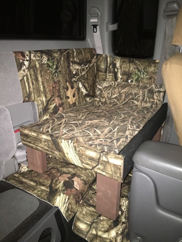

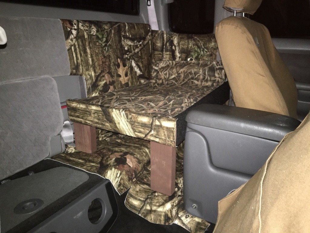

    Interior is COMPLETE!!!! (Until I add a CB Radio/HAM Radio and wire up the switches for the extra lights.) :ohsnap:
    If somebody wants the dimensions, I'll go out and take them, but you can see what it looks like complete. I sort of got this thing thrown together using wood, nail gun, staple gun, extra/left over camo carpet from the "protective liner" and I had some old bunk board carpet that I used to keep the wood from rubbing against the seat.
    I also made this thing 2" taller than my last one, so I'll be able to fit an "emergency" dry box under it between the rear jump seat pan and the driver's seat. I'll get together here soon, but the interior is complete until I start wiring for other electrical "extras".
    I also hand scrubbed with Dawn soap and a brush to clean these as much as I could without a power washer (the preferred method).
    Here is what it looks like done.
    Yes, that's my frame down there rust-less. It's a Texas truck... I have kept it "mav coated" because I go in and out of a boat ramp all the time and it's done a really surprisingly great job. I think the Mav Coat even adds a little darker tint to the factory paint, but it's good.

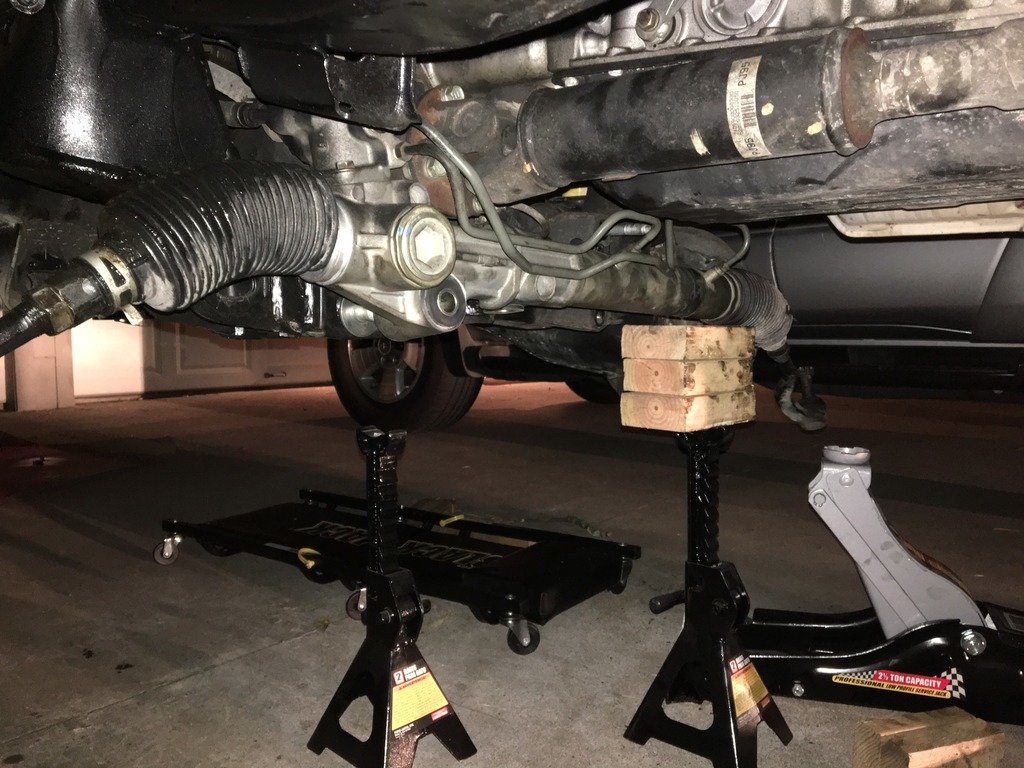

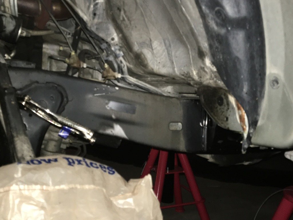

    Here is what we got in the works so far:
    Got the front driver's side basically ripped apart, but we're waiting on parts and paint right now... :annoyed:
    Here's where we're currently at:
    I got the driver's side basically ripped out and ready to go. I got the new CV axles ready to go, but I'm trying to get everything cleaned up, sanded, painted and have everything ready for the install once everything gets here. I WAS going to paint the calipers, but decided against that and went with the "big brake" upgrade. My garage is a wreck and it's a damn wonder anything can be found in there right now, but surprisingly, everything shows up when it needs to. I got the passenger side wheel off and most everything in there ready to go as well. I kinda wanted to keep at least one side as complete as possible so I could use it as a frame of reference. I think once all these parts come on, we'll be ready to rock and roll. I'm hoping to have all current mods complete in 2 weeks. Waiting on parts and my case of paint to get here.
    :fingerscrossed:

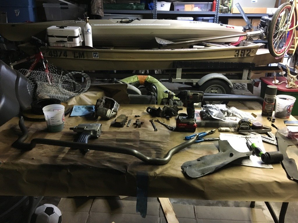

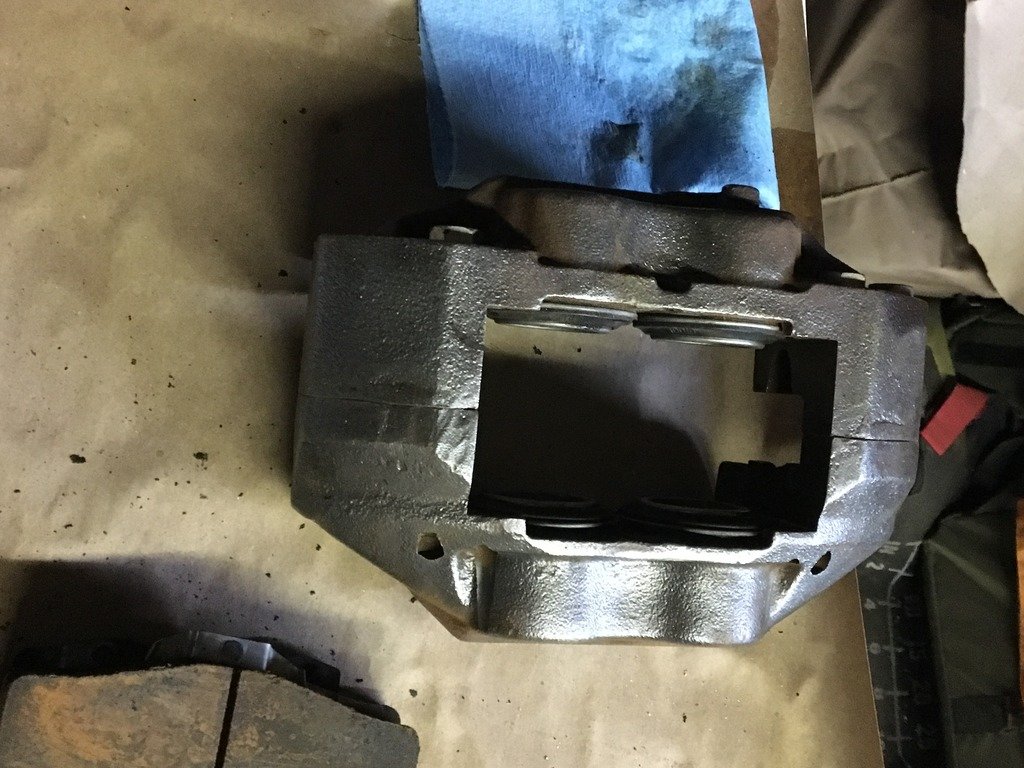

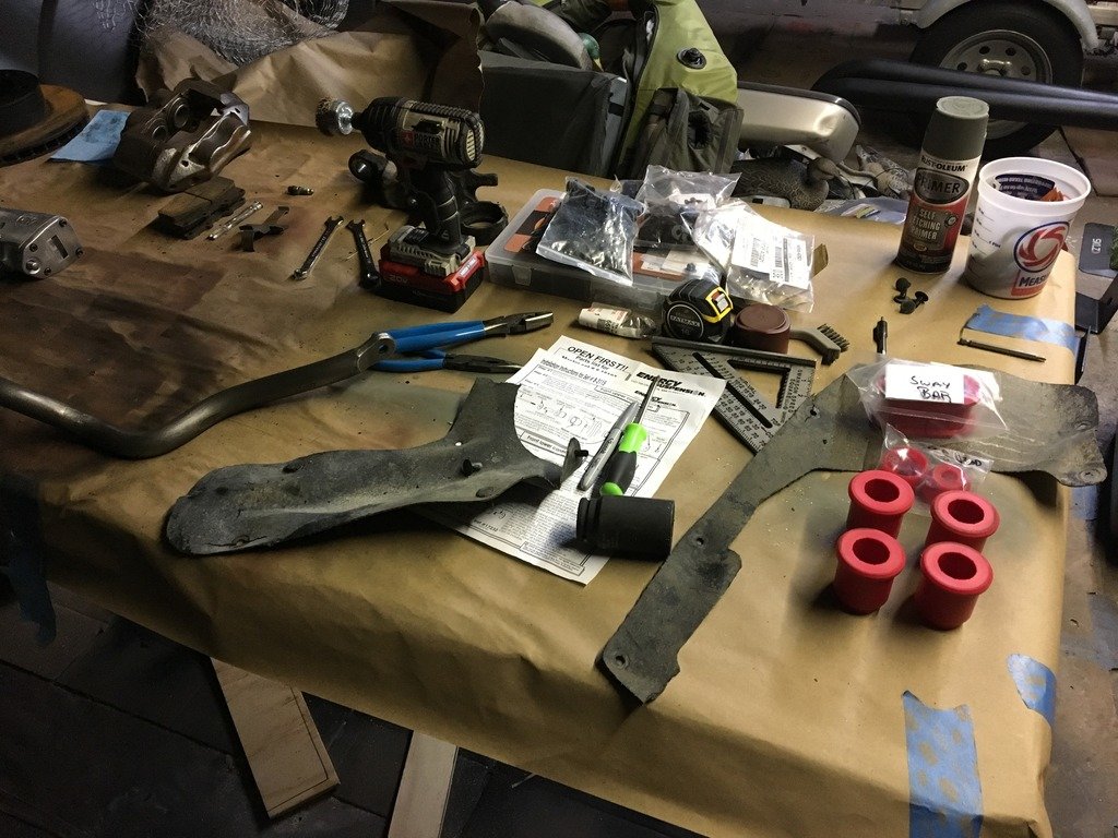

    Pic Dump and Semi-Daily Progress Report:

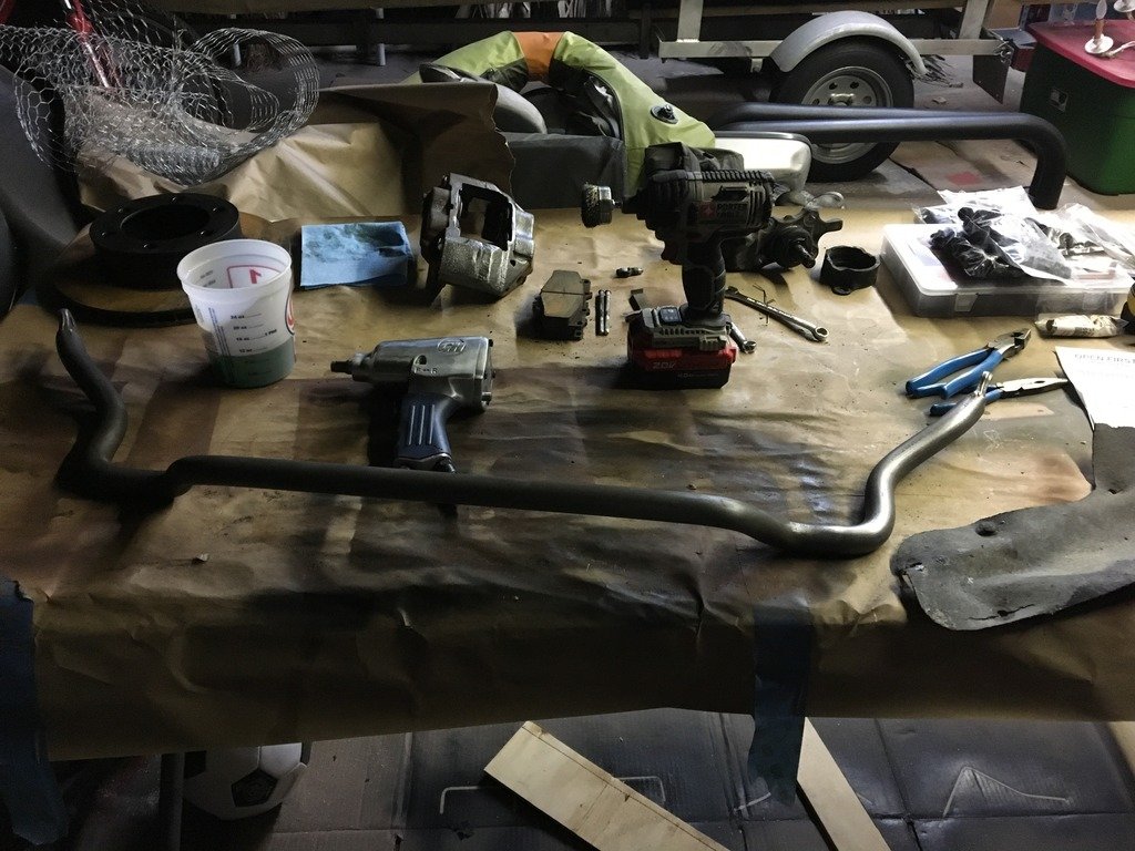

    Got the Sway Bar totally stripped, wire brushed, sanded, and ready for primer/paint. It's going to be multi-colored. Just wait and see...
    Crazy messy garage.
    Pile of decoys I need to re-string. I have all the stuff, just need to finish the truck project. The decoy cord is literally there next to them waiting to be put on... Haha.
    Various truck parts and alternate work space
    All the crap on there with a clean sway bar.
    Pile of 2 x 4's I used to get the damn truck off the ground with the jack.
    "Cleaned" front end. Ready for sanding/painting. Literally took a scrub brush and scrubbed it.
    Grease. Was. Everywhere. By the way, did I say grease was everywhere???
    More of the cleaned front end.
    Clean metal on the frame...
    Partially cleaned up caliper that stopped and hasn't continued because I decided on the brake upgrade.
    Bracket that was on frame holding some cords that was rusty is getting the "Rustoleum Rust Reversal" spa treatment.
    Picked up this guy for $25.00 at Wal-Mart while cruising the isles while "looking" for something else. It's an Ingersol Rand and has up to 250 ft-lbs of torque. I'm a big proponent of you get what you pay for- but if it craps the bed, who cares.
    Work Space
    Filing system that works for me.
    Transmission Fluid Filter that doesn't need to be changed, but I'm going to do anyway.
    Necessities
    Primary Work Bench
    That's a pic dump of where we are right now...
    Also, I had an idea on replacing the clip-on apron... What if we used thin neoprene to replace what is currently there. ****I'm totally open to suggestion if anybody has one...
    Looking forward to continuing.

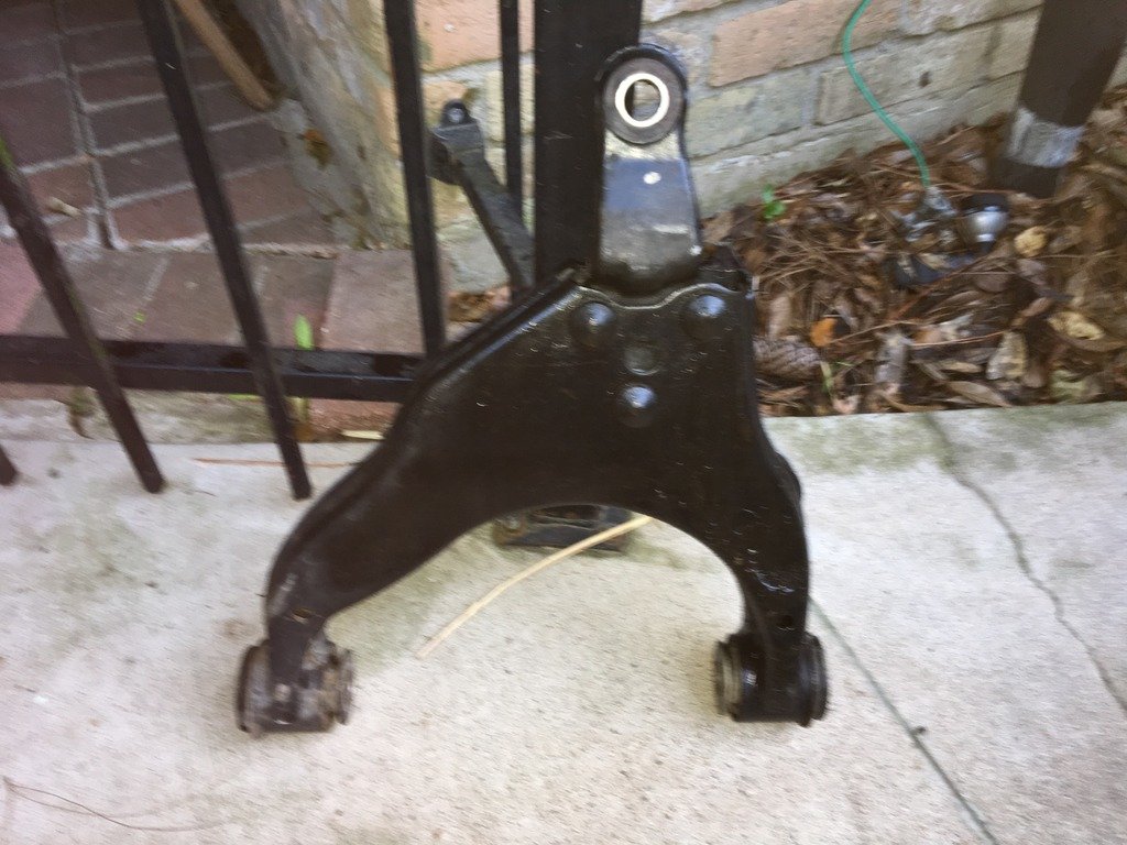

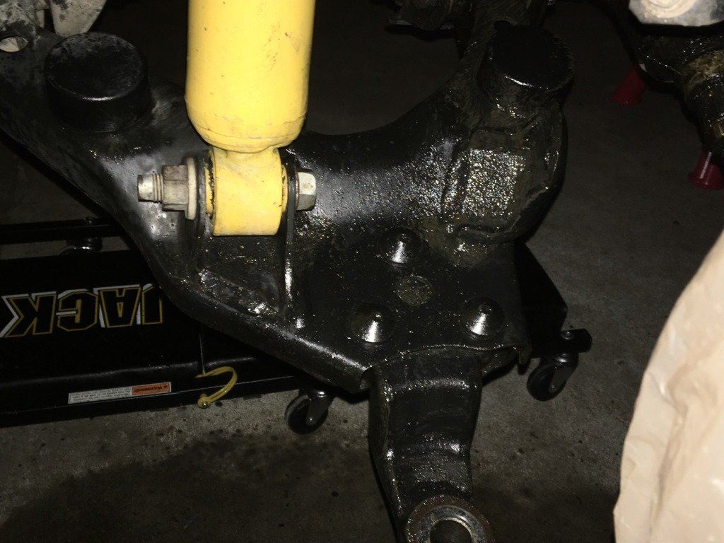

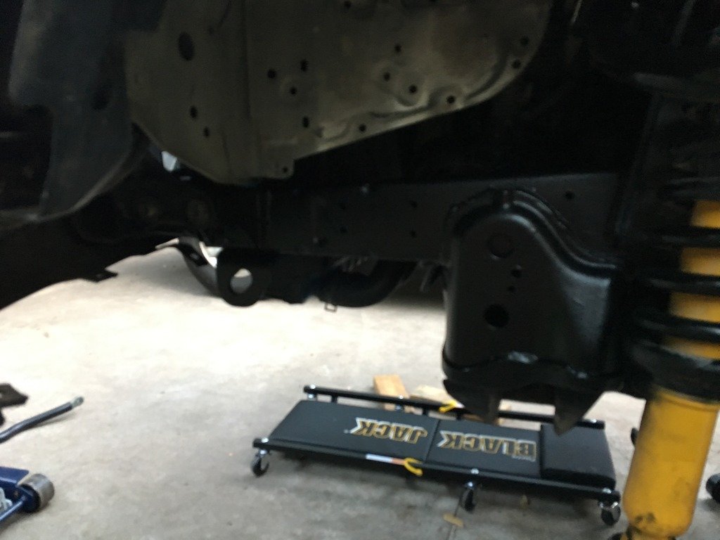

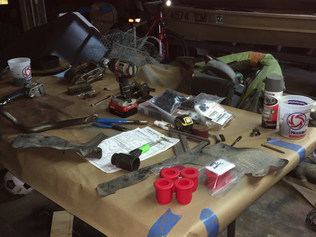

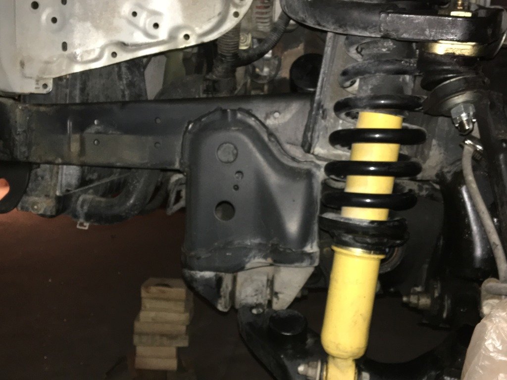

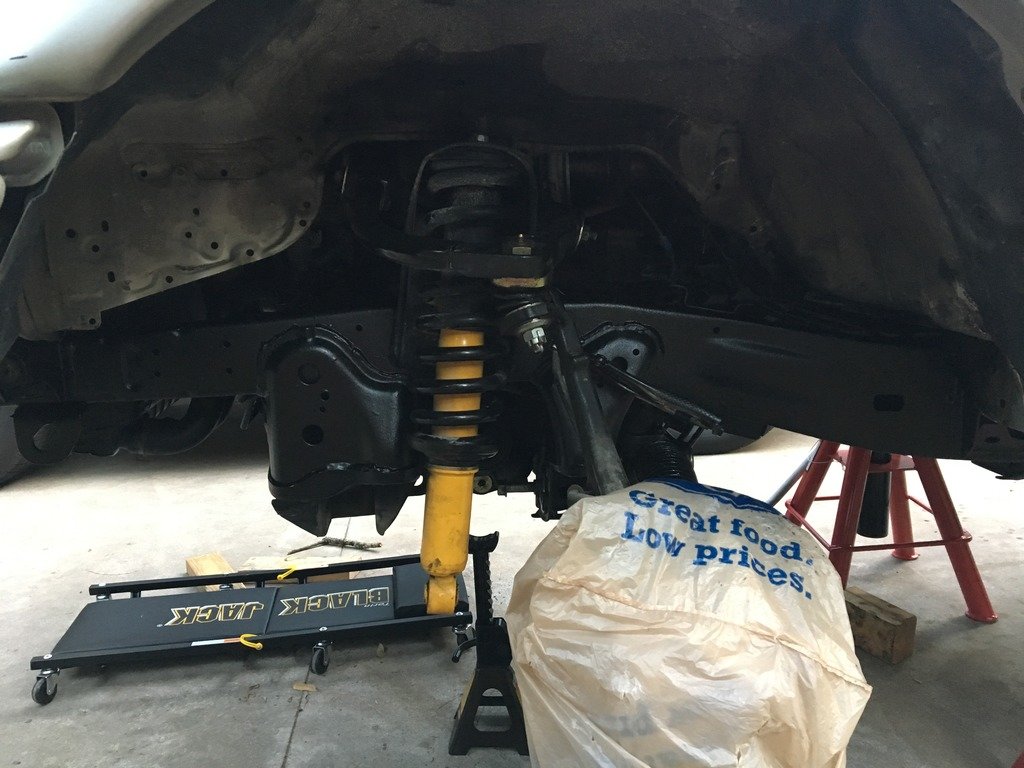

    *Update*

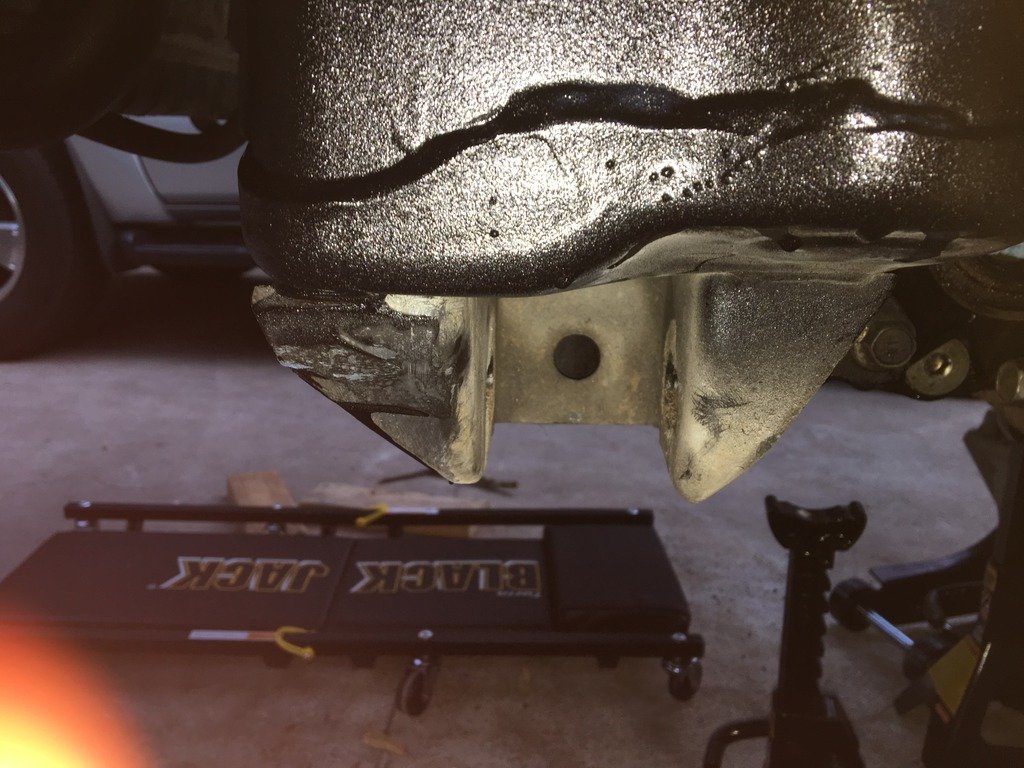

    I finally got the LCA off... This was kind of a pain. Well, a lot of a pain... Had to get the steering track loosened up and pull that back a little bit to get the camber bolts off. Finally got it done and pulled the LCA. Also, got the front end of the frame cleaned, sanded, cleaned again, sanded again, and painted with truck bed liner.
    Now that I got that LCA off, I'll go in and paint the underside where it attaches to the frame.
    The passenger side shouldn't be that difficult because I already got the steering rack loose and should be able to pull that right out.
    Once I get the other LCA out, I'll clean up everything and get it prepped for painting/spraying.
    The key to this was masking... Took a little bit of tape to keep it looking clean.
    Pics below:

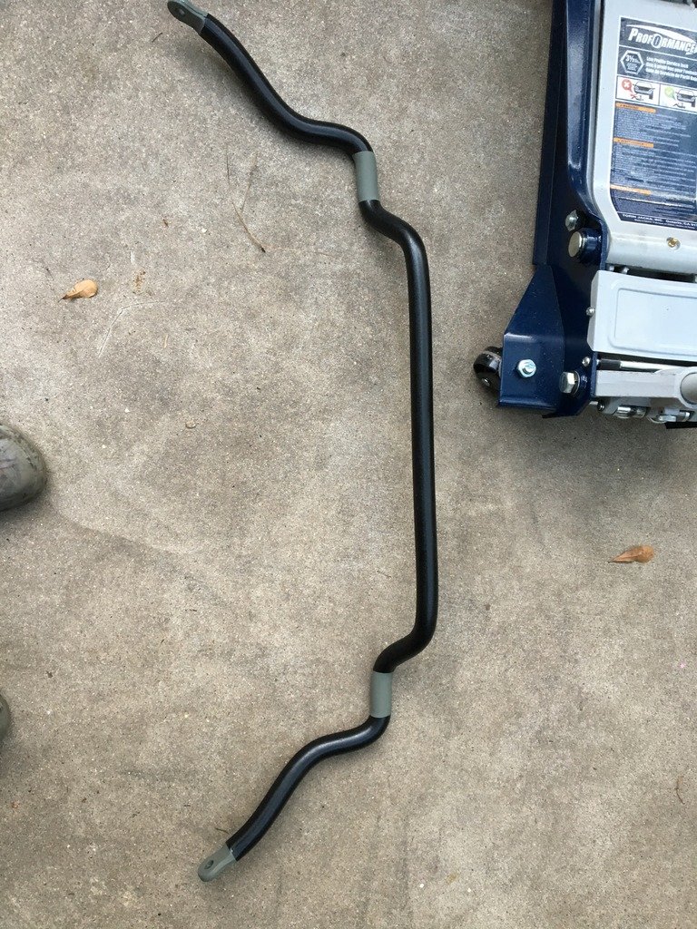

    Also got the sway bar primed, and used truck bed liner on the places that do not contact the or attach to the truck. I'm going to use paint and cover the priming- where it attaches and where the bushings go. I also really need to clean up the mounts where it attaches. There is a little bit of rust in there where water has sat in the mount, and where the bushings attach. I'll get all that cleaned up, sanded and painted as well. I'm probably going to use paint instead of bed liner on those because I don't want anything to happen to the bolts that are on welded on to the brackets there.
    On the sway bar, I did a full strip (aircraft stripper), wire brush to get ALL of the rust out/off, primed, truck bed lined, and then added paint to the ends and where the bushings attach in Candy Red. I ultimately ended up painting the whole thing red... Will post pics of that later.
    **Edit** I have ordered replacement inner and out tie rods, as well as replacement bellow. There is 0 play in the tie rods so I think I'm just going to clean them up, re-grease them, re-bellow them and then just replace the outer tie rods. I'll keep the inners (OEM) for spares.
    Also, when I attach the new CV axles, I'm going to cut the clips off and do the 'CV Mod' for them using pipe clamps. I wanted to get them installed so I could see how far they need to be pulled out before I do that so I'm not doing it twice...
    So, now, here is what I'm going to do:
    1. Pull passenger LCA.
    2. Clean, Sand, Paint LCAs
    3. Replace LCA bushings
    4. Replace passenger LCA
    5. Clean, Sand, Paint LCA brackets on frame
    6. Clean, Sand, Paint Sway Bar brackets/clamps on frame
    7. Remove outer tie rods and bellows to clean and re-grease inner tie rods, replace bellows, then replace outer tie rods.
    8. Remover passenger lower ball joint.
    9. Remove passenger CV Axle
    10. Clean, Sand, Paint passenger frame and LCA brackets on frame
    11. Attach passenger LCA
    12. Re-Attach newly completed steering rack
    13. Complete CV driver/passenger CV Axles
    14. Attach driver/passenger lower ball joints
    15. Re-Attach outer tie rods to lower ball joints- both sides
    16. CV Boot mod- both sides
    17. "Big Brake" upgrade both sides- complete with SS Brake Lines from Wheelers
    18. Re-Torque everything attached to spec to confirm
    19. Put both wheels back on.
    20. Install Snorkel
    That's a lot to do... I'm HOPING to have all of this done by next weekend. :fingerscrossed:
    I'm sure I forgot to "attach" something in the steps- but that's it in a nutshell...

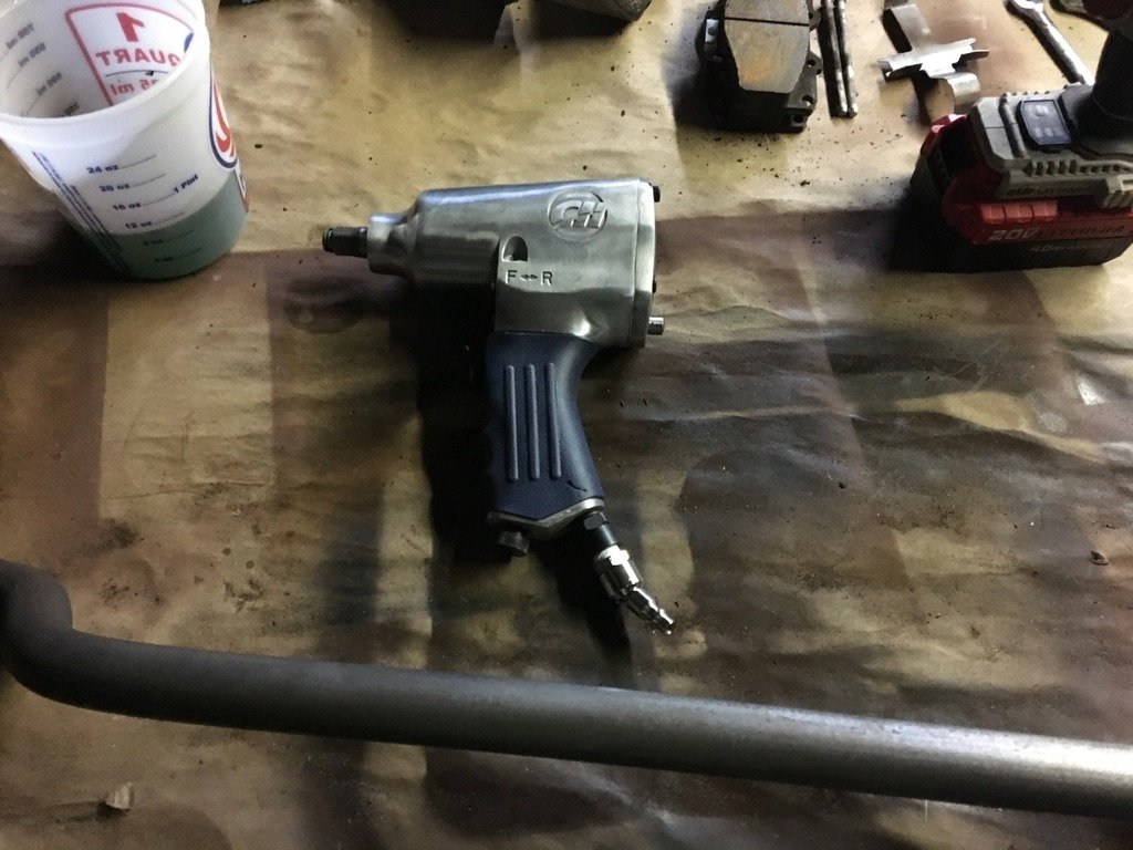

    Parts Update here:
    Inner Tie Rods and Bellows- Arrived
    Snorkel- Arrived
    Outer Tie Rods- En Route
    Chassis and Roll Bar Paint- En Route (Thursday)
    Brakes (Power Stop Complete Kit)- Should be here today or tomorrow (Summit Racing is quick...)
    Work Update:

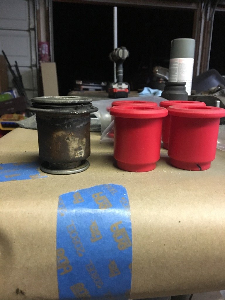

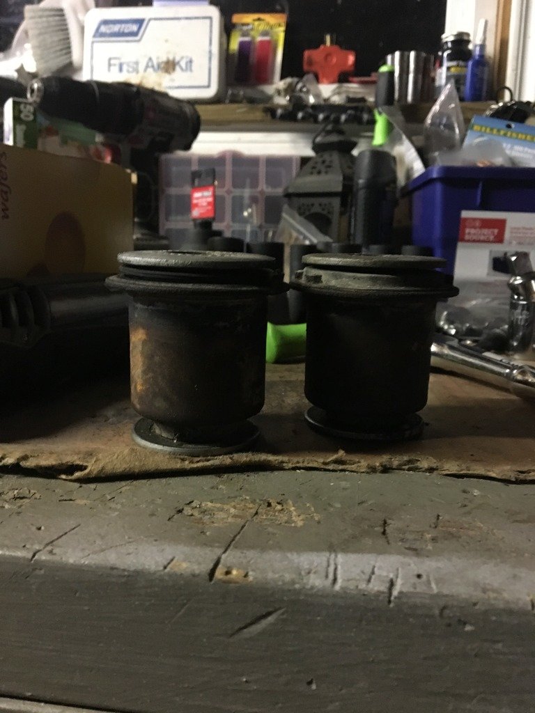

    Got the LCA bushings removed last night with the bottle jack and blow torch method. THAT was an adventure. I was using a 2 ton bottle jack (because I had it) and a 20mm socket to push the inside of the bushing. Had a little difficulty getting one of the bushings out, so I kept heating it with the blow torch... When that thing came out. WHOA! That bushing shot out like a rocket and I thought it put a hole in my roof. I was afraid to look up because I was expecting to see a hole or some type of big dent in my roof. I wish I had it on video, but I was too nervous with a sizzling blow torch in my garage that I didn't even get pics. I'll get pics the next time. I still haven't found the 20mm socket I was using, so who knows where that thing ended up.
    Now, here is my issue... I got the bushings out to replace with Energy Suspension bushings, but I have to use the washers that are currently on the truck. I don't have the ball joint press to do it, so I was hoping it would be easier than it is. No dice. I tried every trick I could think of to try and get those things apart. Nope. Not happening.
    I'm assuming and thinking I need the press sleeves, so I can use the sleeve, a socket (for the smaller washer) and my vice to get the washers out of the stock rubber bushing to replace with the ES bushings... Once that's out then I'm hoping I can do the reverse and use my vise and get the washers pressed onto the ES bushings. That's my thought process on that anyway. We'll see how it goes.
    Pics of the bushings.
    Below you can see the pic of what I need to do. I'm really, really hoping it works out with the sleeves and vice to get them pressed out and back in again. I'm of course going to clean the washers up, and I think I'm going to do a pretty serious MAV Coating over the metal part before it goes back into the LCA.
    I'm honestly learning as I go.
    Research, watch YouTube videos, read forum write-ups, ask questions if needed, give it a shot, find out I screwed it up somehow and order a new part... Just kidding about that mostly- but I did screw up the outer tie rods trying to get those banged out, I think I'm going to invest in a smaller arm puller for those. The one I have works great on the ball joints, but too big for the outer tie rods. Lesson learned.
    I'll get some pics posted up later of the LCAs cleaned/sanded/prepped and then the after of what it looks like with the spray on bed liner.
